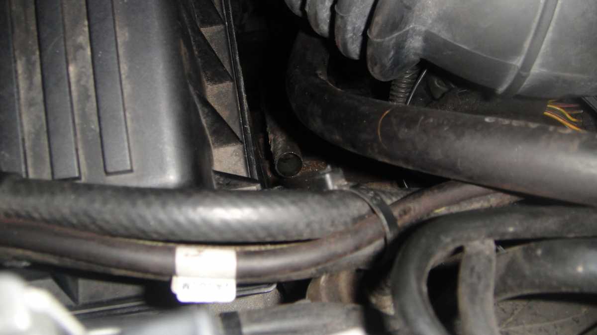

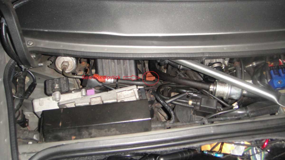

Where's the dipstick and how do you get to it? You can see the top of the dipstick in the pics below and you can reach it, just about, via the access panel. It's tough to do, but it beats taking the engine cover off.

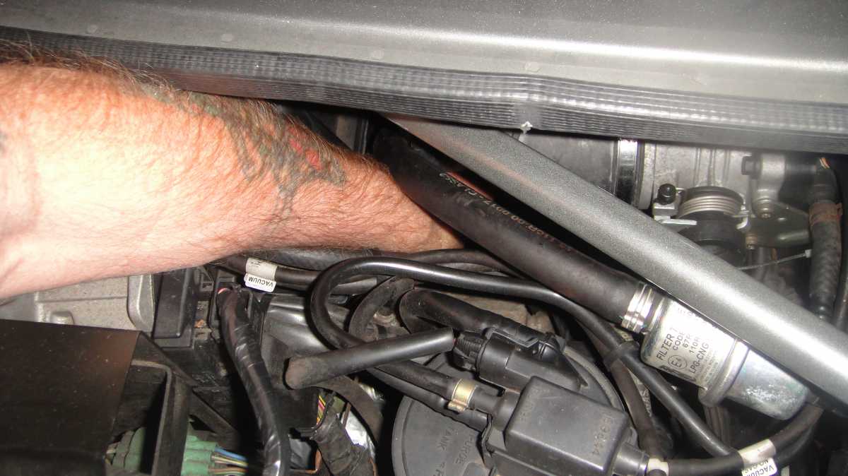

Now we know where it is, here's how you can reach it. Utter an incantation and turn your arm into a snake if it helps. It probably won't and I have to mention that you should only do this when the engine is cold enough for you to do it without getting burnt.

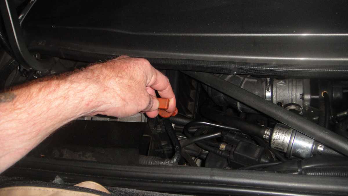

Take a firm hold and withdraw the dipstick.

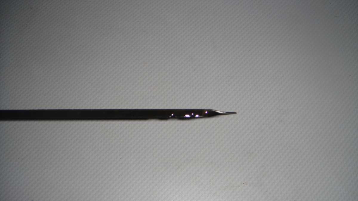

Visually inspect it for the presence of oil.
Wipe it clean, re-insert it and withdraw it once more. The two marks on the stick are the minimum and maximum levels. I won't teach you to suck eggs. If it's too low, you'll need to top up the relevant fluid / oil.
Fortunately my fluid level was at the top. However, if I did need a top up, of let's say half a litre, here's how I would do it personally. Now I'm sure that my idea isn't the 'done thing'. I reckon it'll work ok though. Comments are welcomed. :)
So, at this point, we have this view -

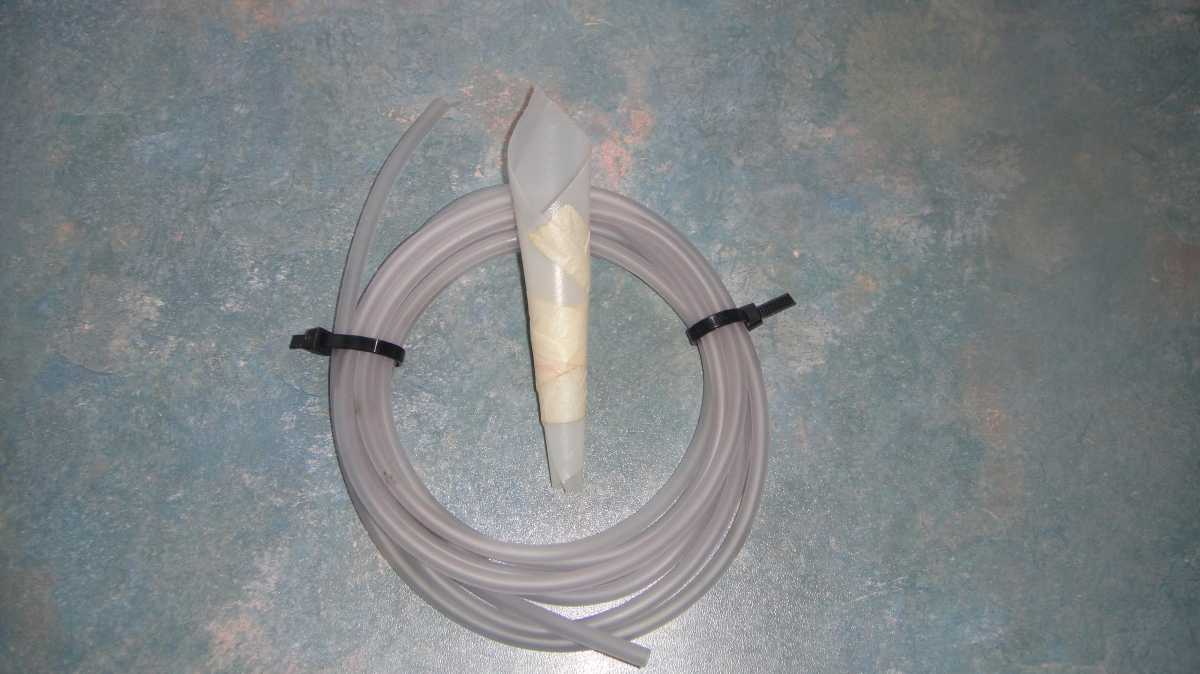

I'd insert a small hose, like this spare washer fluid hose, into the opening. Then I'd use a small funnel, like this one I fashioned from a piece of a plastic milk bottle.
I'd leave the oil in the house overnight or maybe sit it on a radiator for a while to warm it up a touch so that it flowed more easily. Then, inserting the hose into the dipstick, I'd fill it slowly with the oil, a few drops at a time, going down through the funnel and hose into the dipstick. It might take half an hour or so. But, for me, it beats the alternative method which requires taking the engine cover off and removing nuts and bolts etc.
