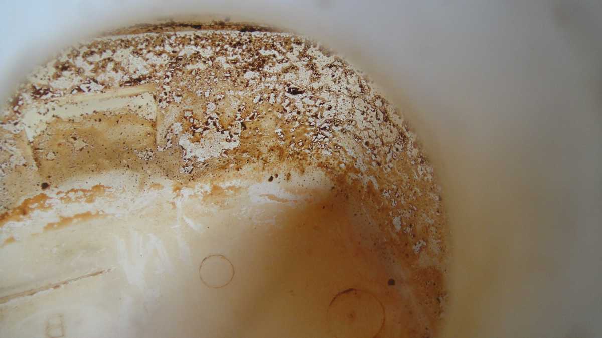

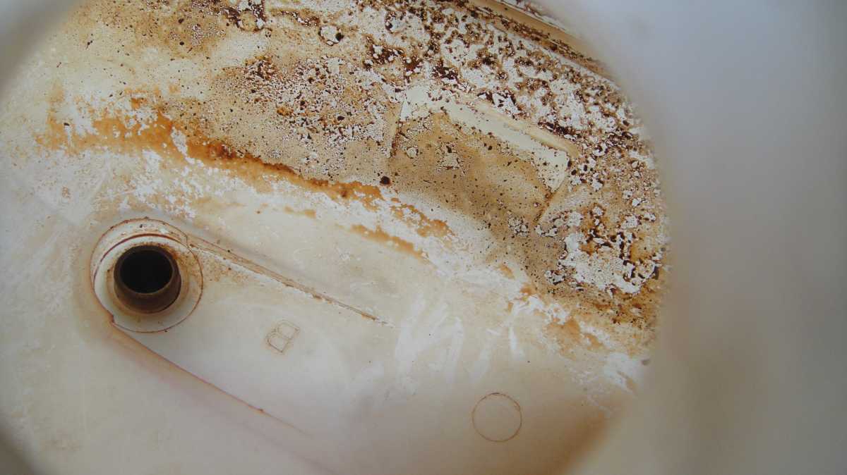

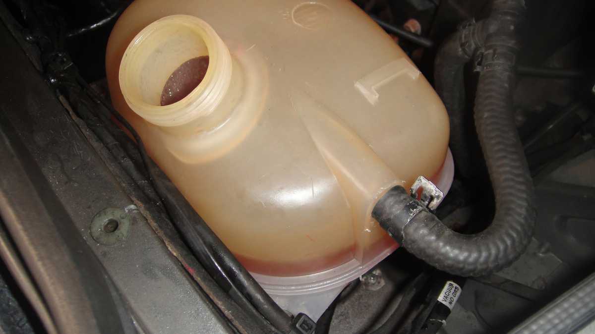

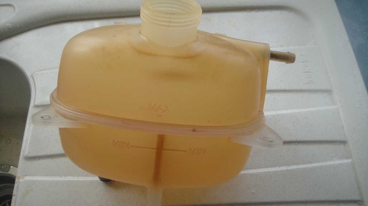

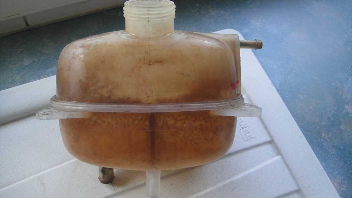

Whilst 'leak hunting' I saw that my expansion tank was in need of a clean up. The guides on how to do that are vague and rare to say the least. So, I thought I'd knock one up for the T-Bar pages.
Pre 'Clean up' the tank looked like this -

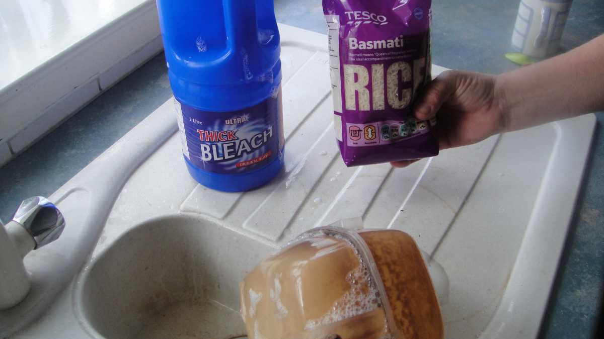

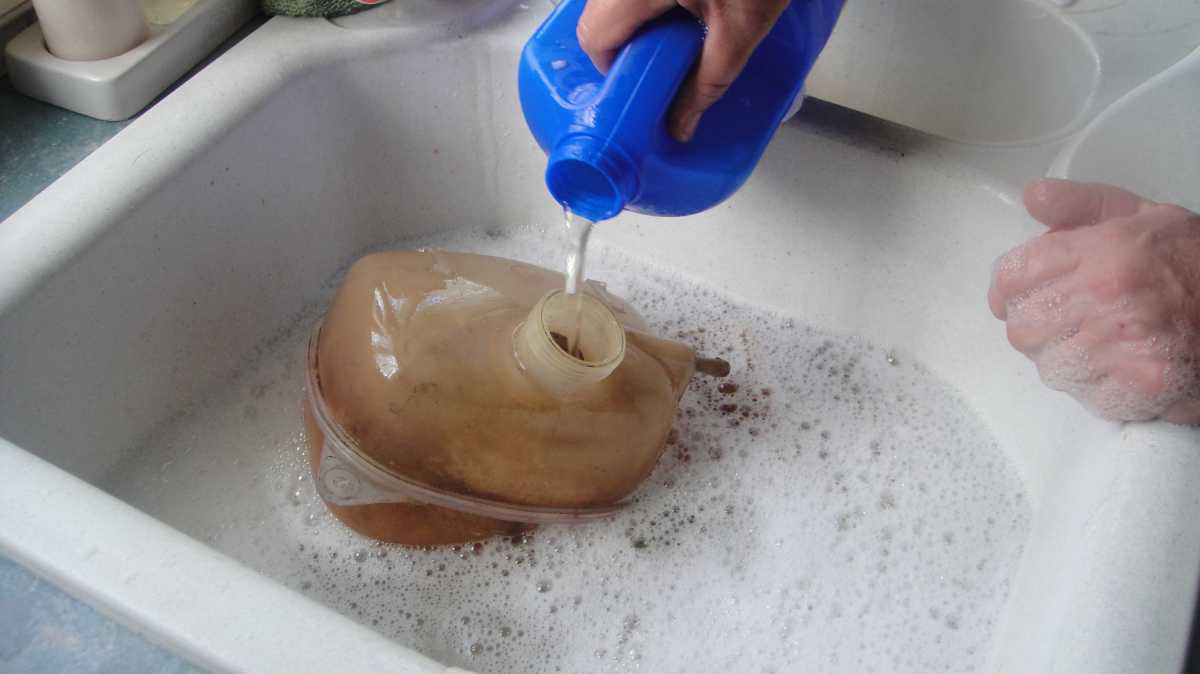

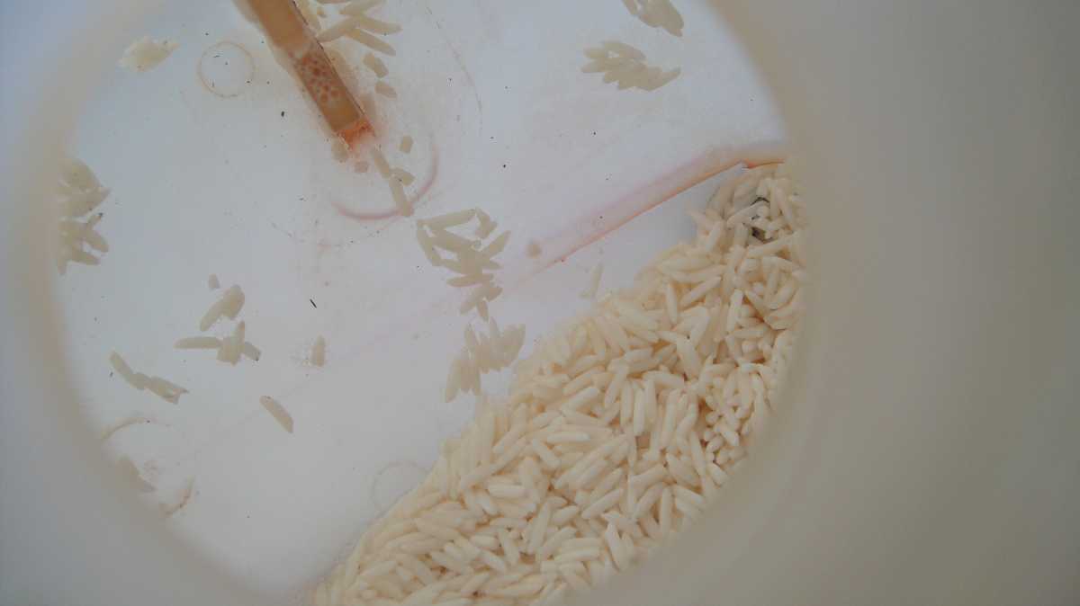

Some ingredients to get the cleaning process going -
Shake it up and let it marinade for 20 minutes while you find something else to do (pastie optional). :)

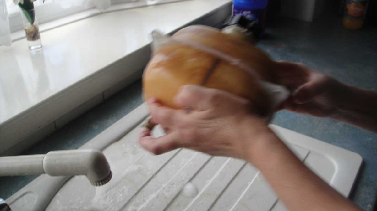

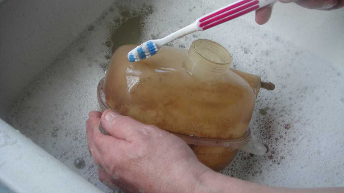

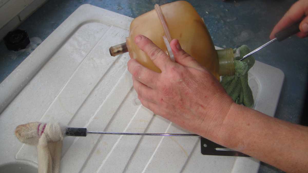

Give it a scrub out inside using tools improvised for the job -

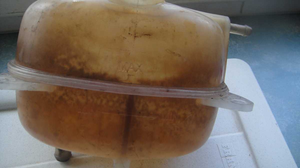

You can see the effect the rice had on the grime inside -

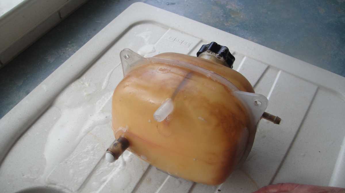

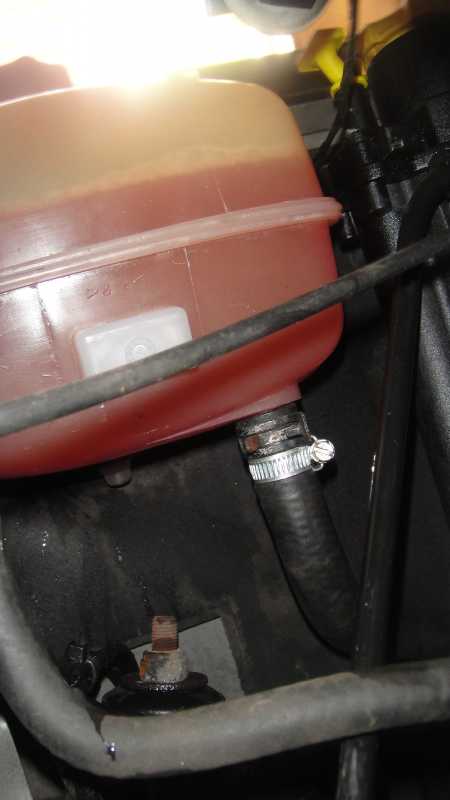

Put it all back together -
The job's a good un! :broon:
