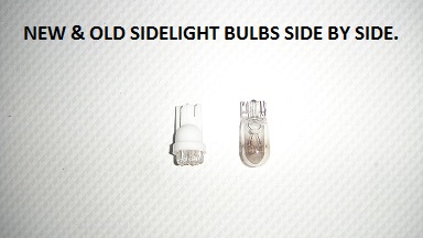

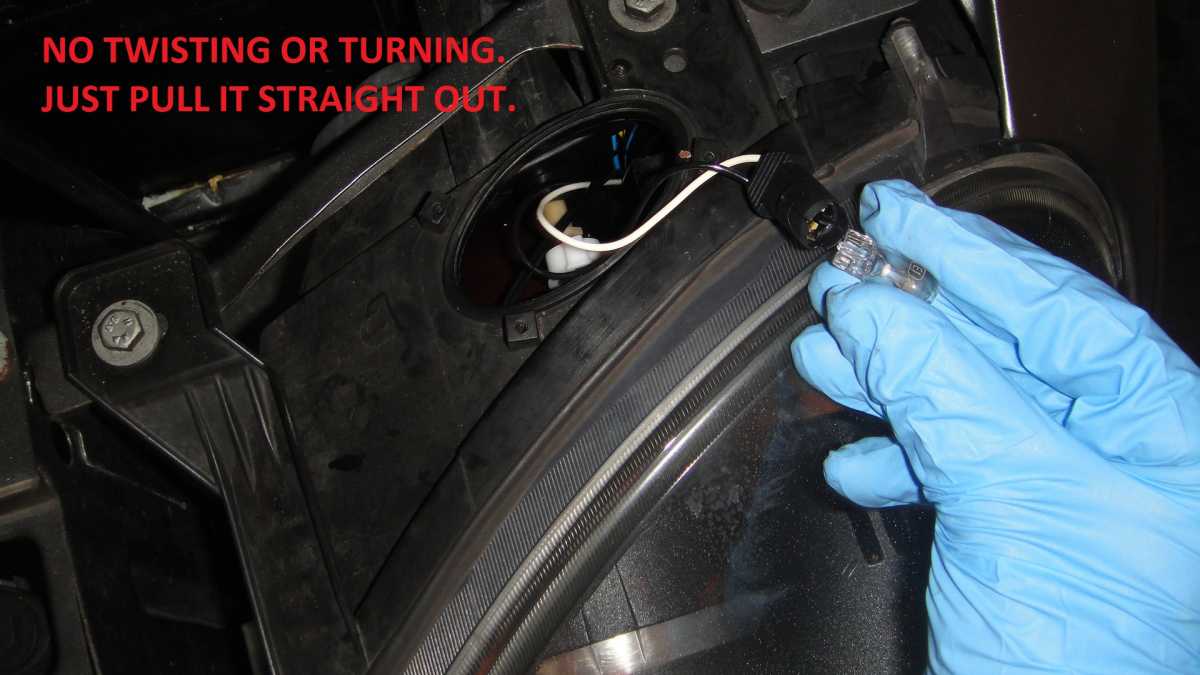

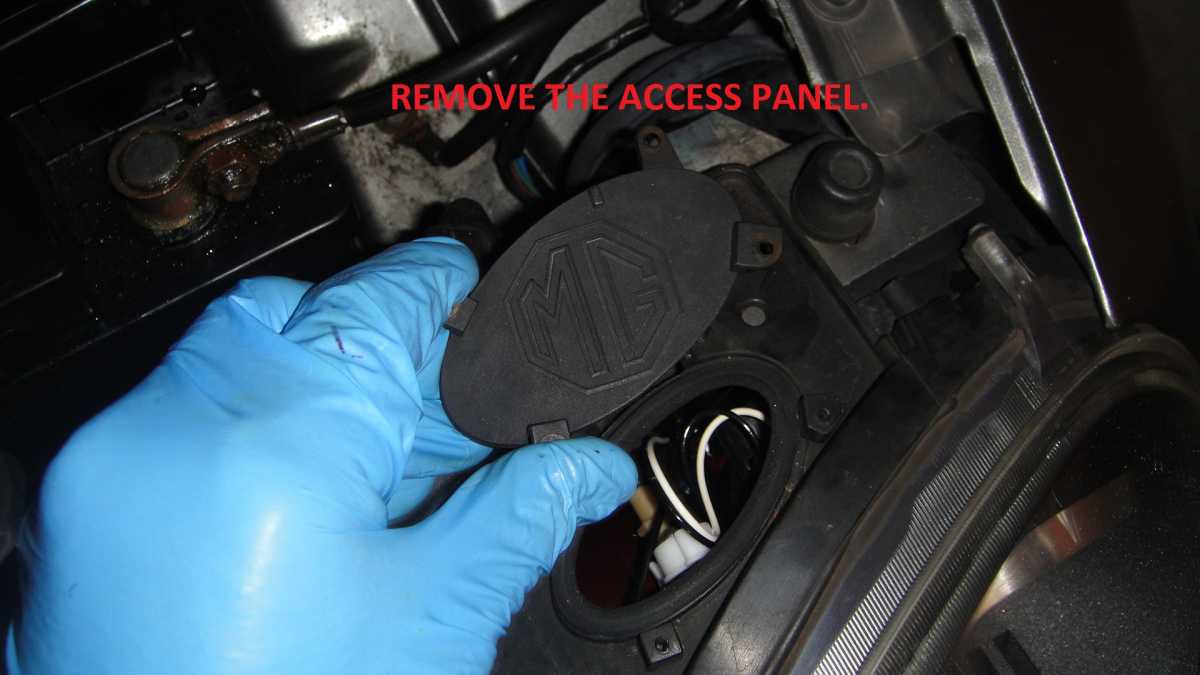

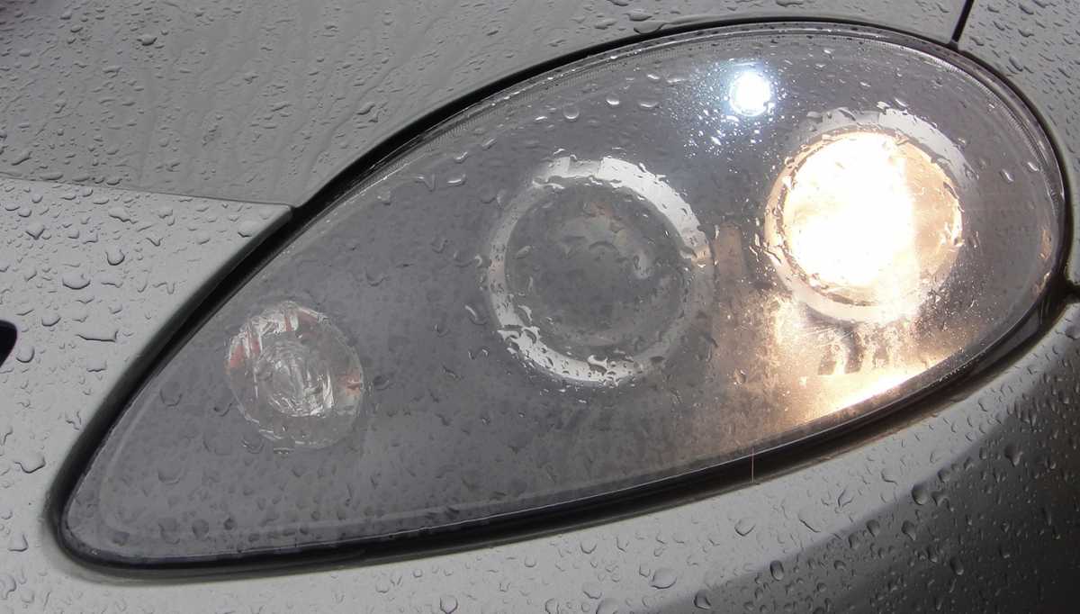

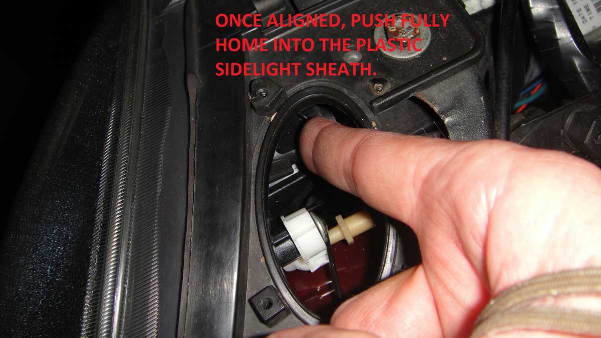

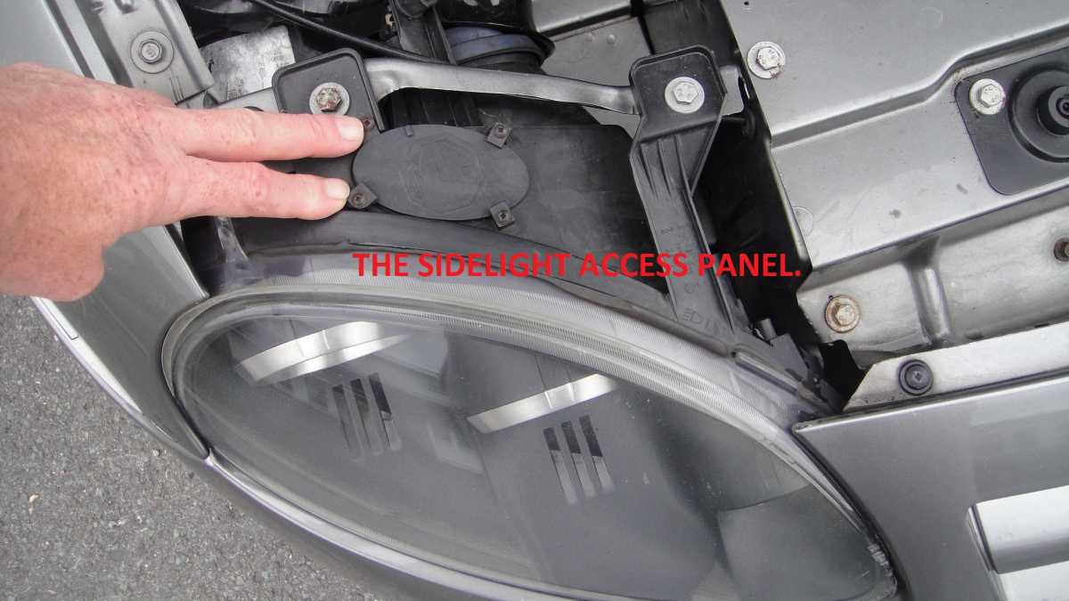

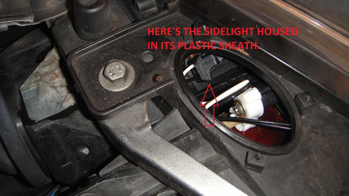

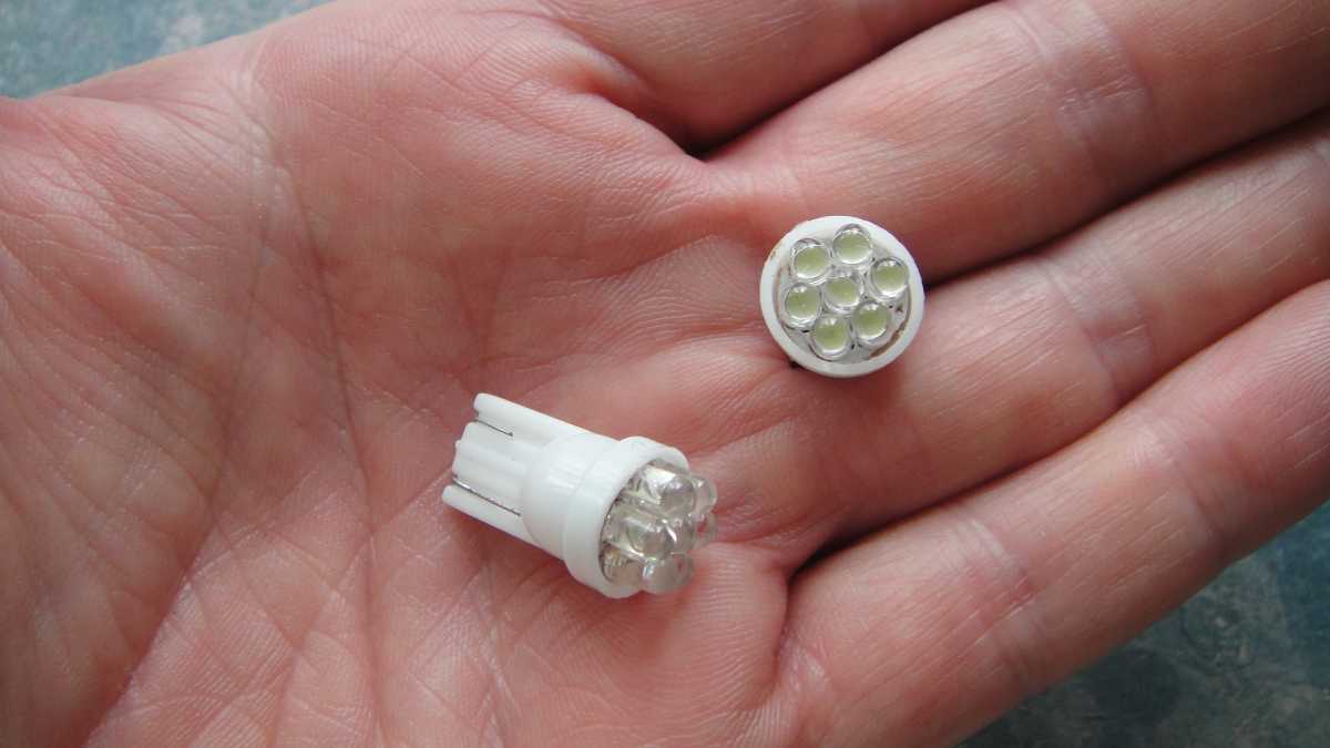

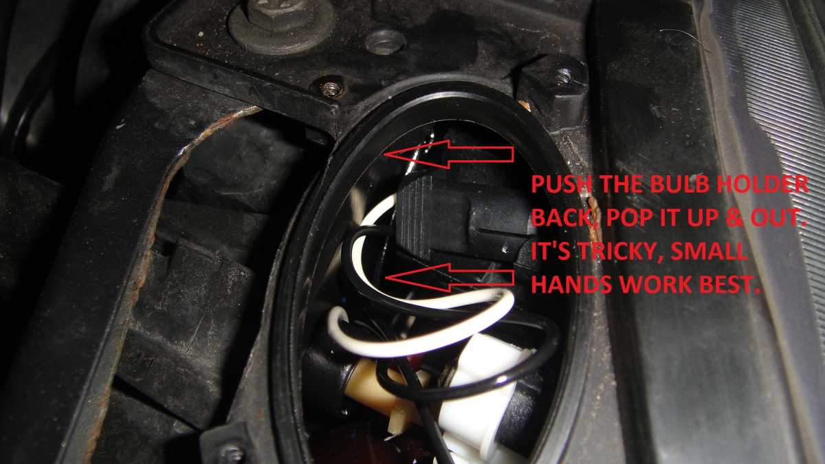

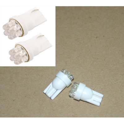

Because of the MGTF cars' low profile, I almost always have my sidelights on when driving. I believe it's safer that way when driving mainly in the city. I decided to freshen up the tired old yellow sidelights bulbs with these -
Specification:
7 LED White Xenon Car Side Lights Bulbs 501/T10/W5W
Dimensions: 22mm (L)* 10mm(Plug)*12mm(Dia)
Light Source: 7 LED
Colour: Cool Xenon White Look
Standard: 12V DC
Each bulb has 7 LEDs
They only took one day to arrive after purchasing. Click here.

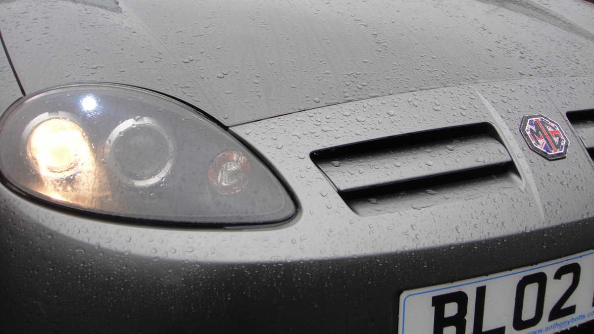

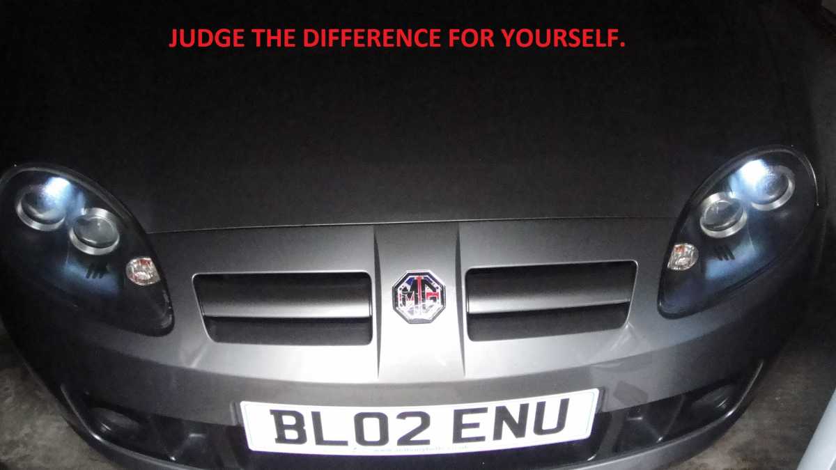

When you've finished, they should look something like this -

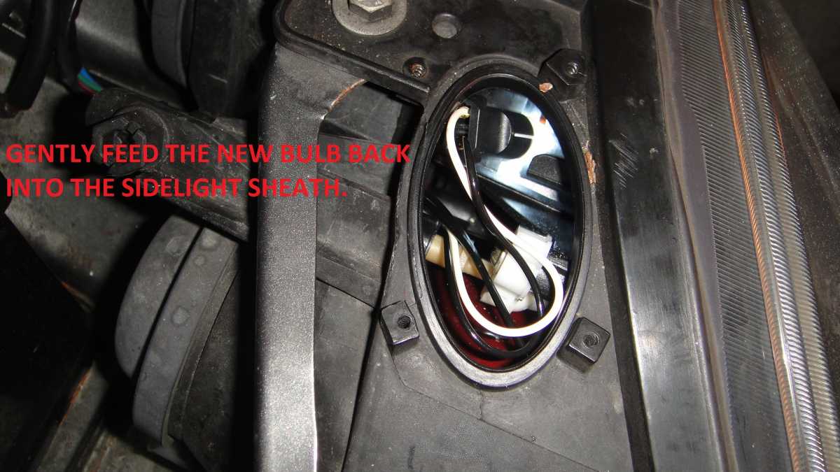

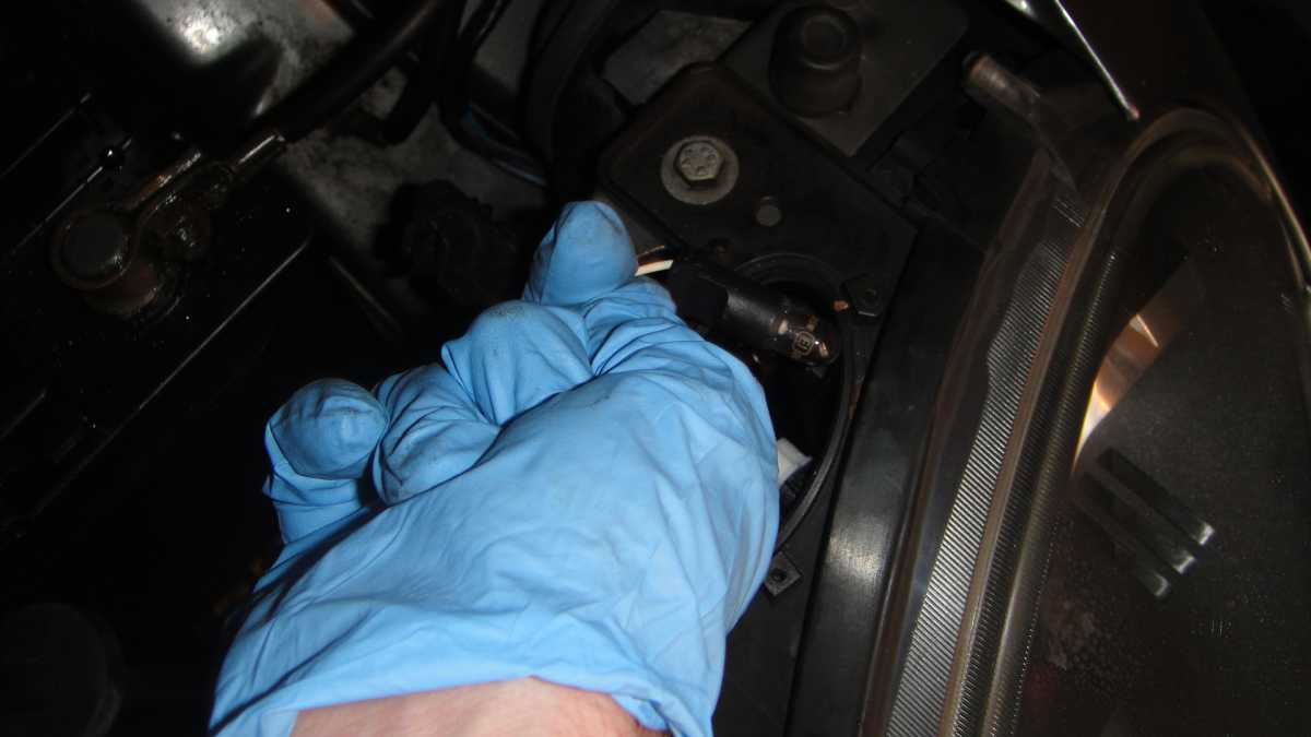

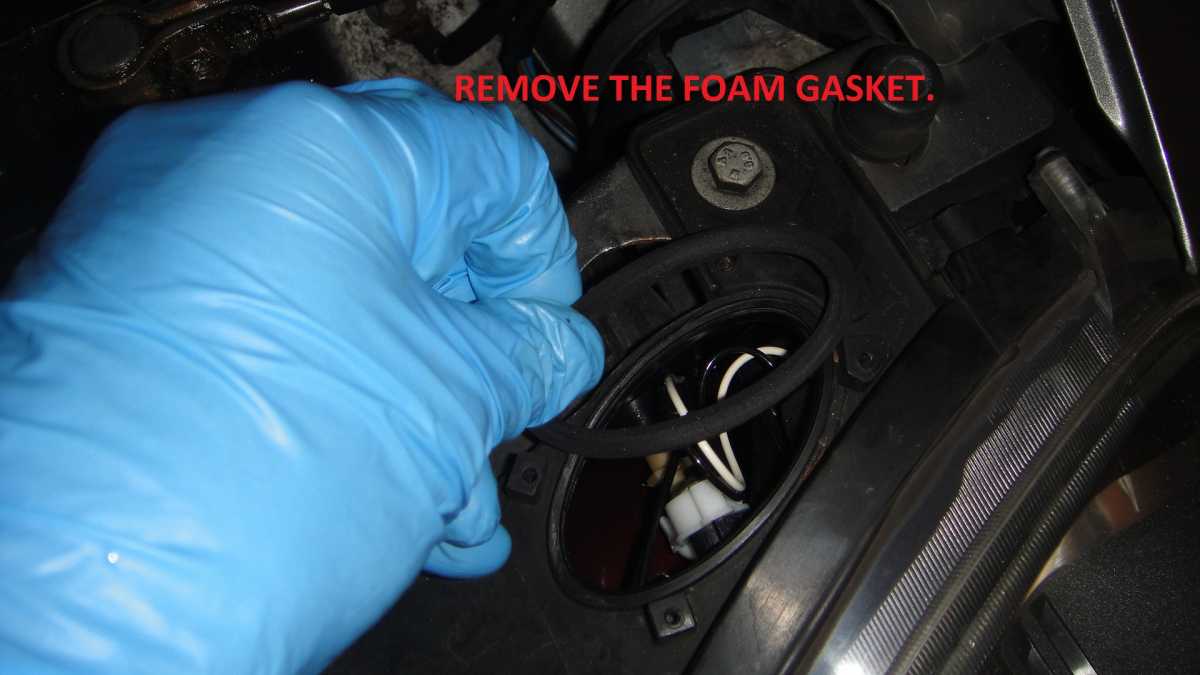

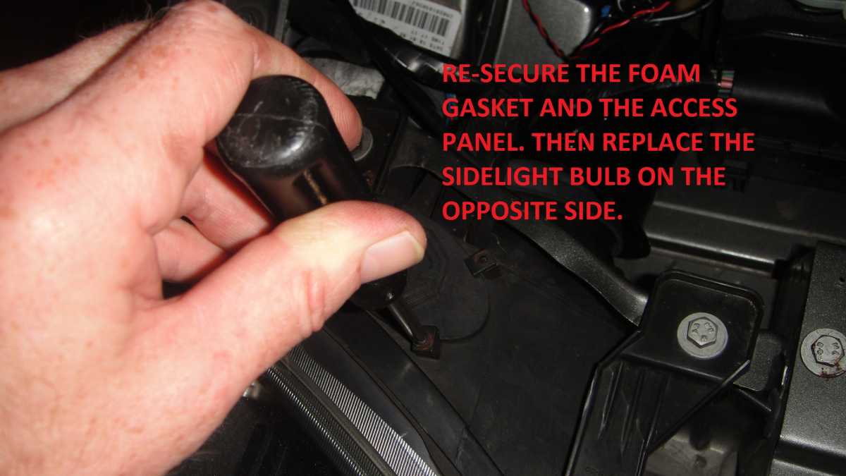

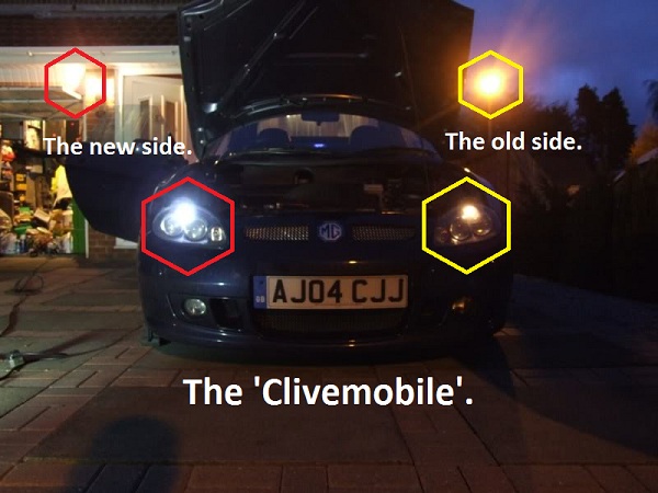

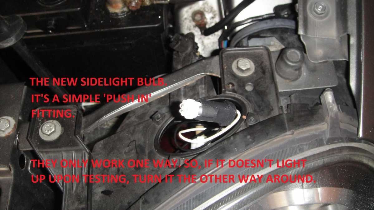

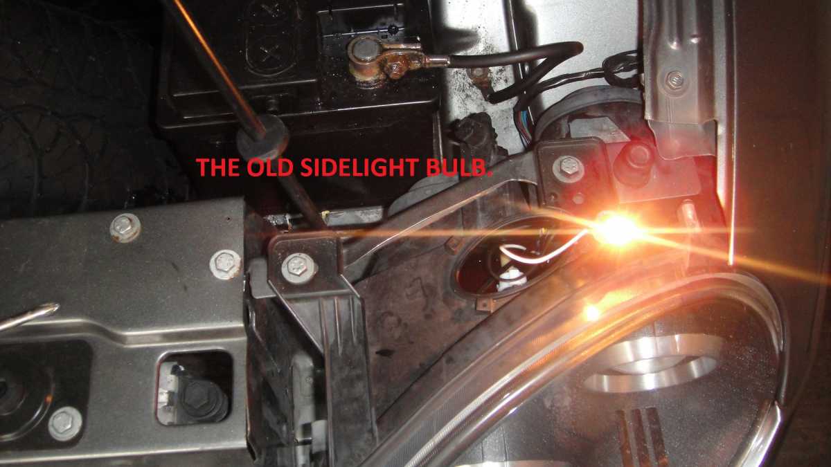

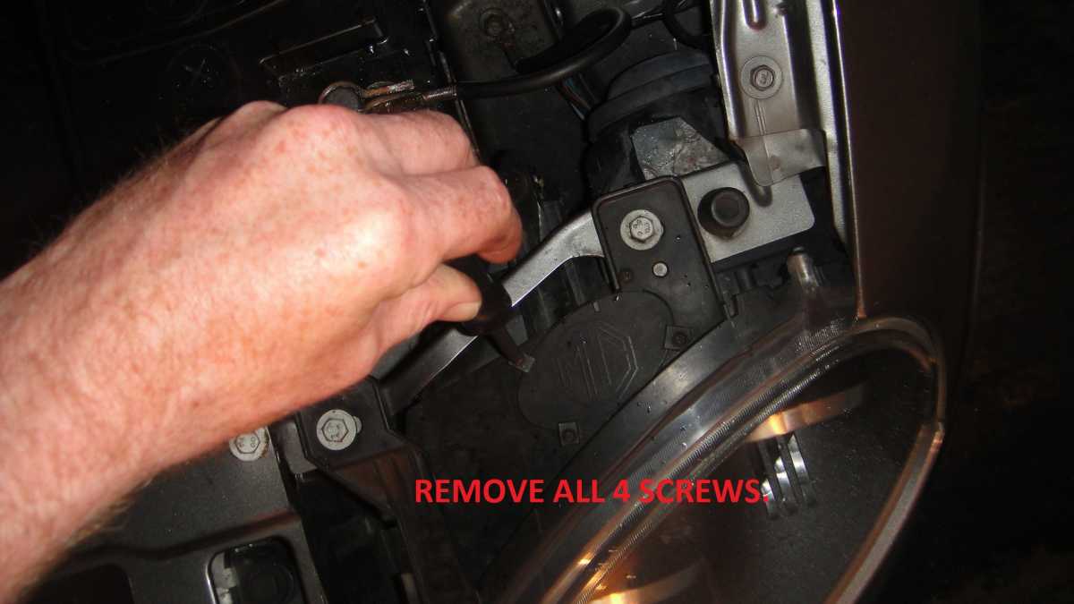

The old yellow sidelights and how to replace them.

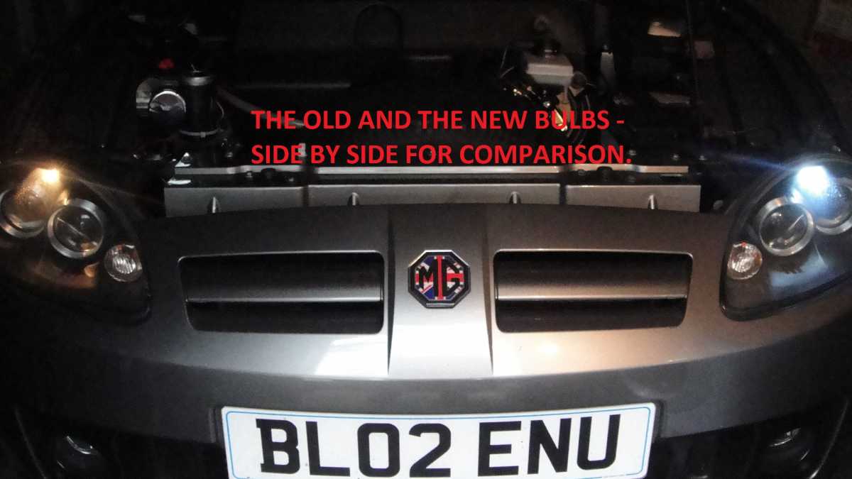

You can see the old and new sidelights operating during daytime running and in darkness in the video below.

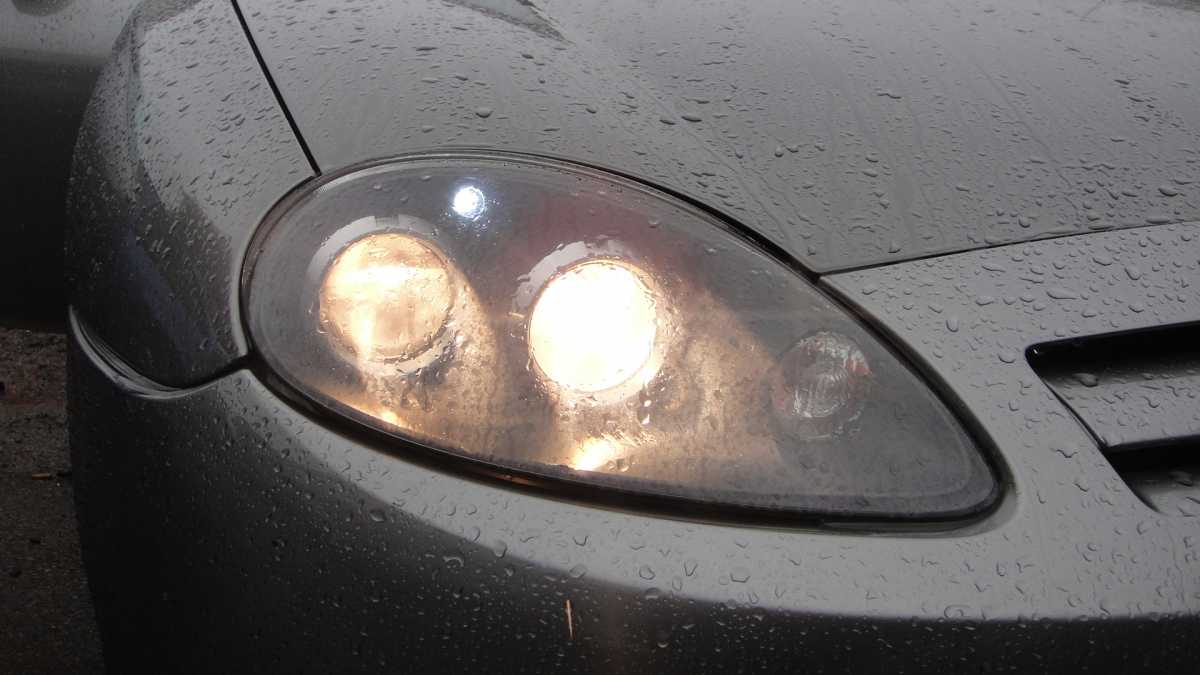

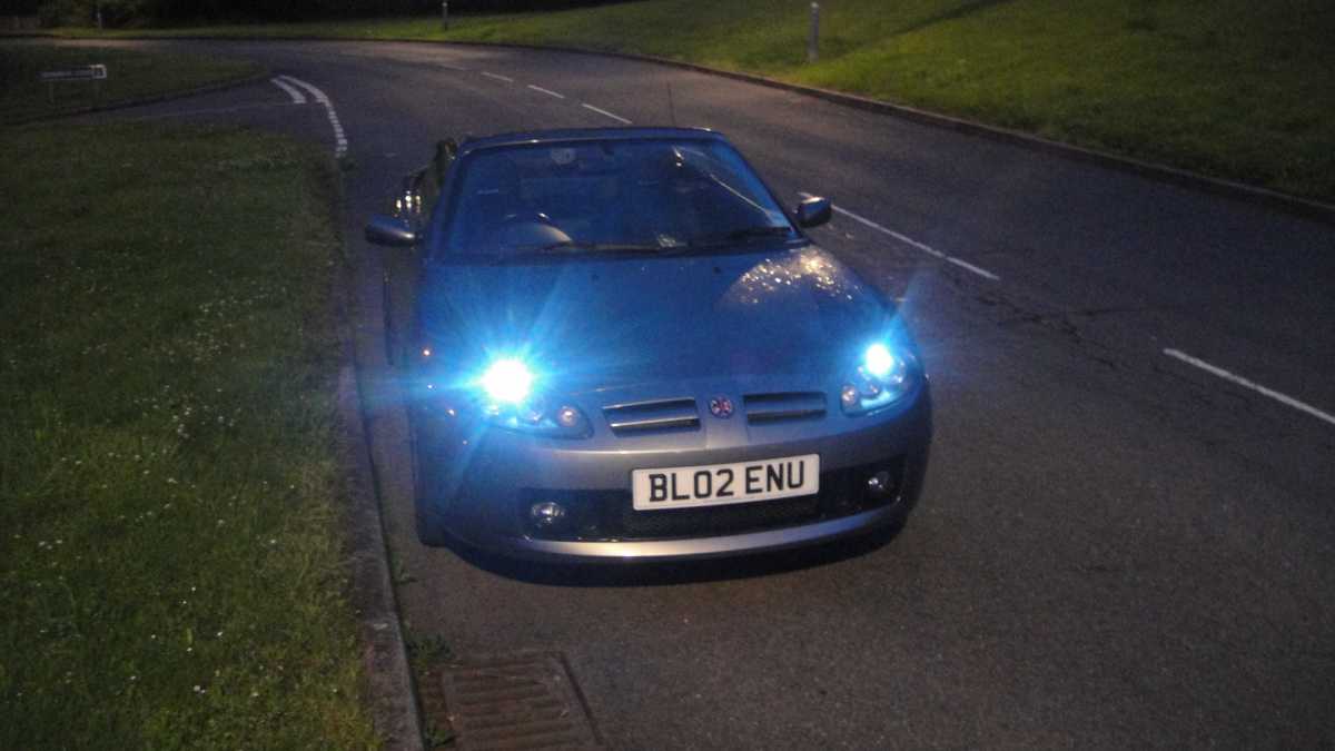

PeteTF160 'Pete's car'.
Dipped headlights on -

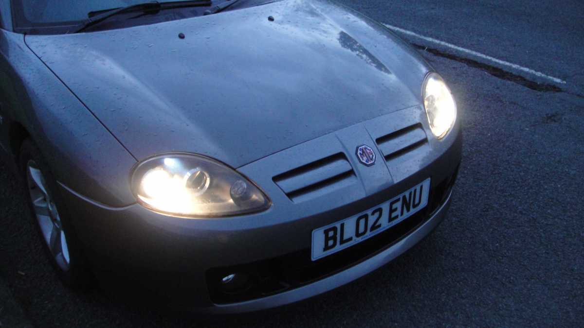

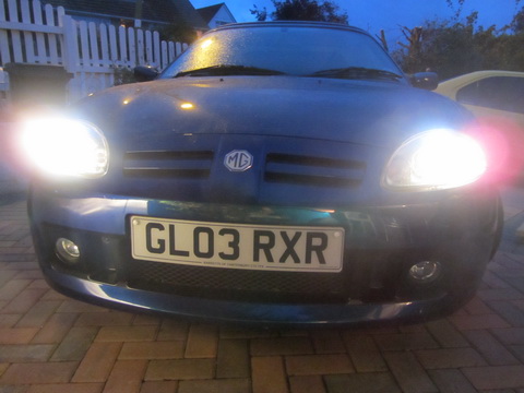

'CJJ' Clives' car.

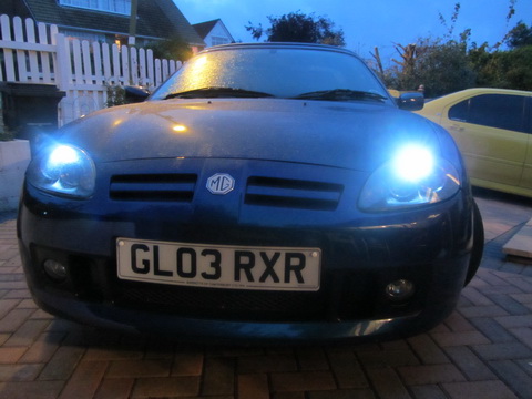

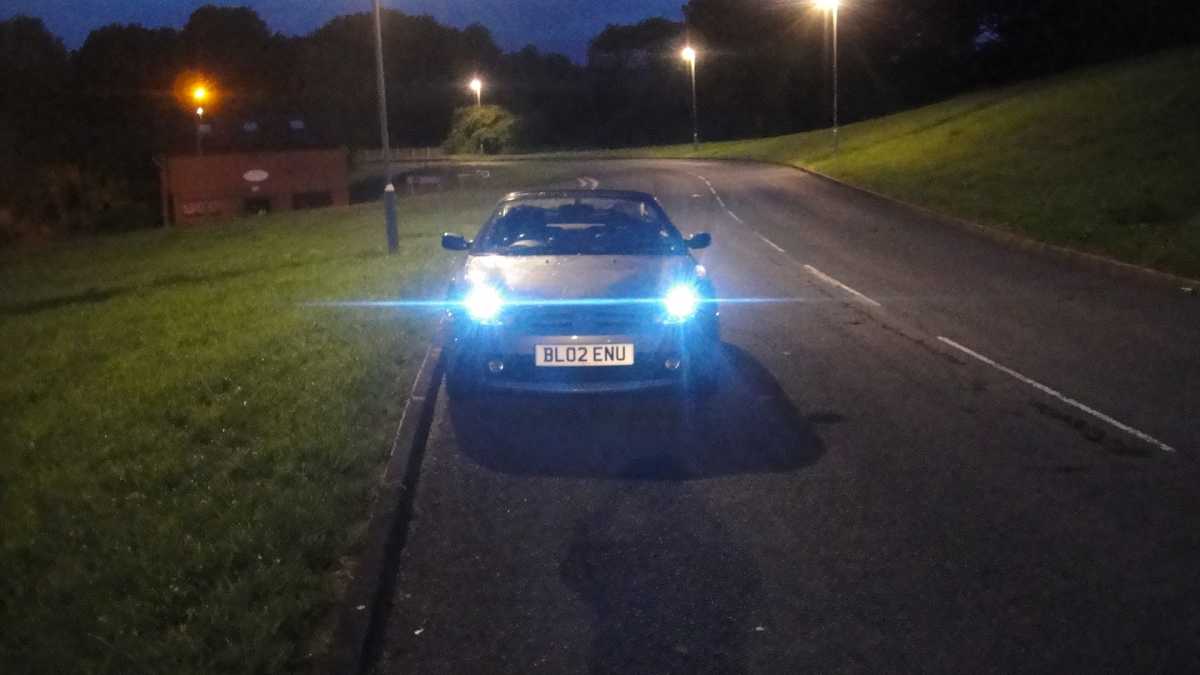

Twilight and darkness pics of my car.

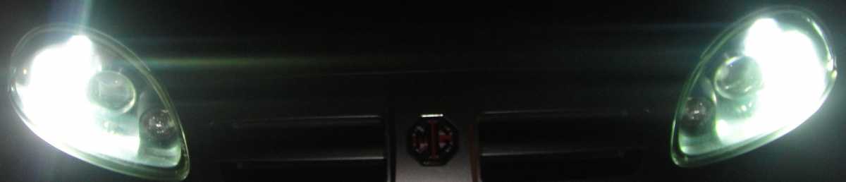

Headlights on -
They look great with xenon headlight bulbs.
That's a lot of light for such a little bulb!

Replied by petetf160 on topic Re: How to change an MGTF sidelight bulb.
Posted 14 years 1 week ago #57131
Certainly stand out more, thanks for the How to, think I'll have a bash and put some in.

Replied by s66prm on topic Re: How to change an MGTF sidelight bulb.
Posted 14 years 1 week ago #57139
Brilliant, thanks for this! I have the same bulbs and at a glance in the rain last night couldn't work a way into the lights.

I've added a 'sidelight daytime running' video at the foot of the how to guide above. I'll add another showing them in twilight next week, as they're not too clearly apparrent in broad daylight. But you'll get the picture that they are much better than they were previously.

MGTF and MGF Bulb list by Clive. A lot of my guides are simply trying to upgrade or update some of the more simple, but excellent, guides done in the past. They really are a superb asset and I give thanks that all the hard ones have been done already. :lol:
Anyway, there are links to the bulbs within that link above. You would need to check the number of the bulb ie; the sidelight bulb is a 501 and then click the link to the ebay outlet in my post for whichever bulb you needed. Don't forget to check the measurements of the newer LED bulbs because they do some weird and wonderful things with them. Link below.
Weird and wonderful bulbs.
Posted 14 years 4 days ago #58136
Just fitted my new side light bulbs, see what you mean by small fingers, had to get the wife to pull the bulb out.
Do look better and whiter.
