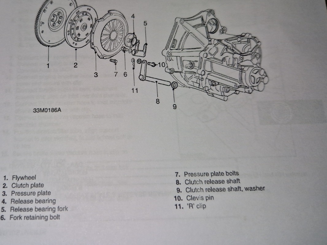

The following pic is taken directly from the MG TF Workshop manual.
It lists all components and the diagram of the components.

The PG1 is a Honda design & arrived with the Rover 800. Goodness knows how many millions have been made & they’re all basically the same, ratios differ & the odd ones have a Quaife limited slip diff but other than that, fairly bogo. Bogo & reliable.
I would have thought it would be better to harmonise the engine fittings to accommodate any PG1 rather than the other way about,
by Airportable
In that case remove the spigot bush.
Somebody must have fitted one incorrectly.
