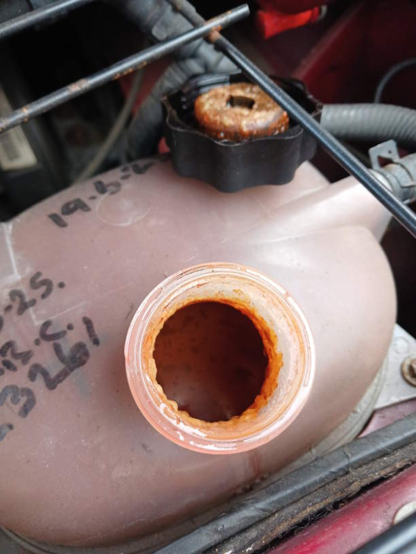

So I had an HGF scare last year some time, which turned out to be a false alarm, due more to my inherent paranoia than anything else
New stainless pipes, and been absolutely fine since. However, I decided to check my coolant level a week or two ago, and saw this bit of mayo around the cap.
Coolant level fine, no mayo in the oil, engine temp fine... somebody said this is likely just a bit of condensation - what do you think?
Thanks as ever
by Hogweed

Hi clean the cap and wipe around just inside the tank, then use the car regularly and see what happens. Condensation happens when the cars are not used often, I have been led to believe.

Was new antifreeze put in when the underfloor pipes were changed or was the old antifreeze used?
I ask because it looks a bit grotty.
You can check it with a multimeter to see if it is still functioning.
Yes new coolant - I was told - but the inside of the header tank was all filthy from the old corroded pipes (that's one of the reasons I previously thought my gasket had gone), so I think it's just the inside of the tank. But that's given me an idea - I'll suck some of the fluid out with a syringe tomorrow and see what it looks like! Will report back...
Sorry, what should I check with the meter?

If it's new antifreeze you will be fine.
If you have a digital MM or a Fluke you can get an idea if it is still good.
Set it to Voltage, connect to a good earth and stick the positive probe in the header tank.
You are looking for tenths of a volt.
Ov to .2v is good.... .3v is starting to go off.. .4v change it.
Yours will be fine.

OK... stuck the meter in it, and it started off around 80mV, and gradually dropping. I got tired of watching it when it got to maybe 65mV, but still falling.
Despite having a brain the size of a planet (little age giveaway there), I've never been able to count, but I think that's less than 0.1V...?
Collant looks good I think? The glar's on the outside of the syringe.
