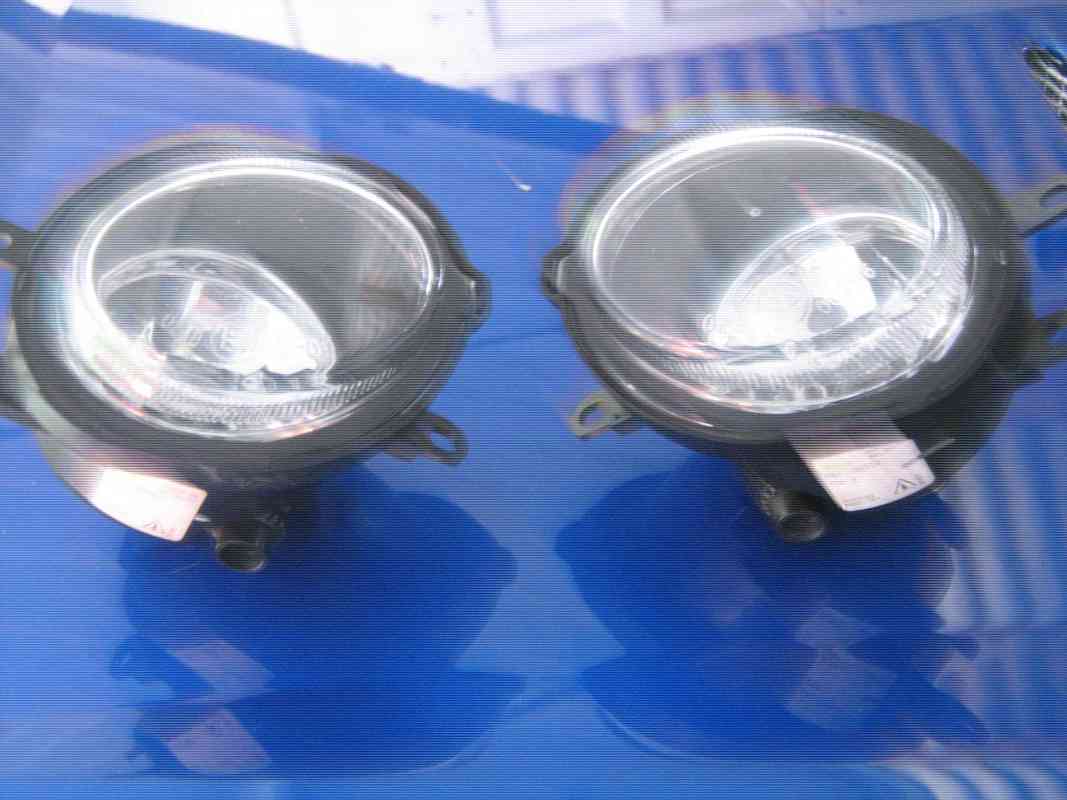

So decided to buy some foglamps ,wasted no time taking the front bumper off..................when it was off realised I need some brackets for these lamps to fit my 2004 tf......heres a picture of my lamps and bumper..........................can anyone on here supply me with these brackets to affix the lamps

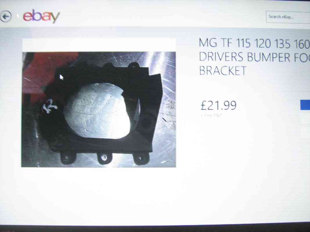

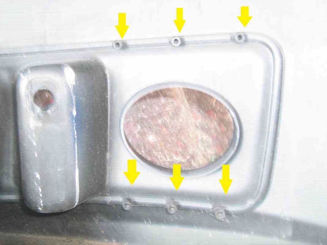

Does this mean then that some later models may have the wiring in place? :-? :-? ...................I checked ebay at the time of writing this post and found 1 bracket for sale..........the bumper has 6 drillings to except screws for the bracket which ive highlighted with yellow arrows so I assume the later brackets screw on apposed to the older types being glued............................ :bust:
yeh there pricey :dry:
how much :slapme: :slapme:
Last Edit:11 years 1 month ago by mgtfbluestreak
Last edit: 11 years 1 month ago by mgtfbluestreak.
Replied by adamelphick on topic foglamp brackets
Posted 11 years 1 month ago #158982
There are two types of bracket for the TF - one with 6 screws and one that glues on - you need the screw on type. The eBay one you showed is the correct one.
