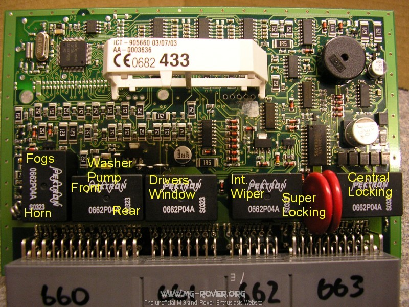

Replied by Stan_B on topic Re: Passenger lock jammed - yes you guessed it LOCKED!
Posted 14 years 3 months ago #44312
With the later Pektron BCU equipped cars this can happen as a result of the central locking relay failing. A WAMGOC member with a 2005 car had this and couldnt sort it until the relay was suggested. Replacement is the same as any relay in that unit and you can buy them off of Ebay from the .org member who is the expert. Now I know he sources a better component I would just change the lot while the PCB is on the bench.
