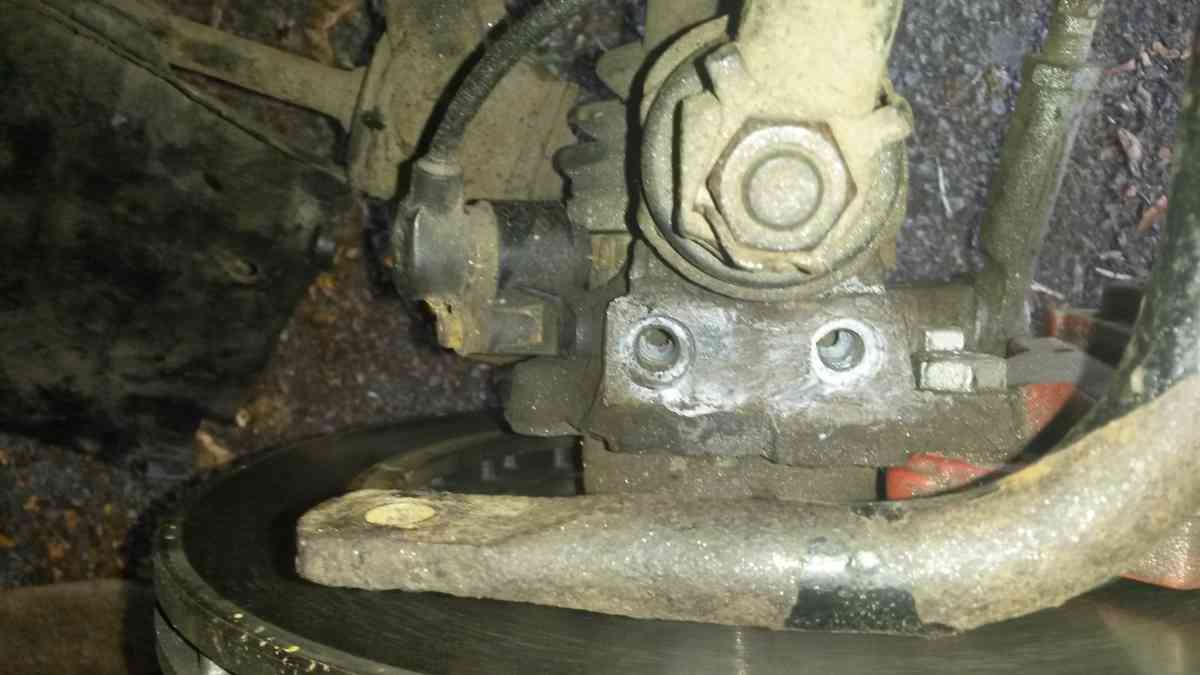

The handbrake callipers have taken a little time to fine tune, and will require manual adjustment as the pads wear.
The bracket for the calliper is constructed of stainless angle iron and is fixed to the hub at the same place as the anti rollbar bracket , with appropriately longer bolts.
Apart from that I am totally happy with the set up now. It is a huge improvement on the original 240mm setup and on the 304mm front only set up.

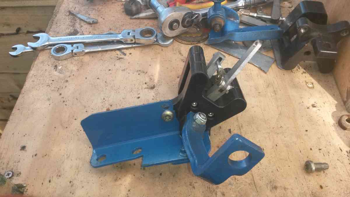

Would it be possible to get a photo of the bracket and the modification to the handbrake lever (the latter to show the machine shop what needs to be done).
Thanks :)
Replied by David Aiketgate on topic Re:Rear brakes upgrade to AP - THEORETICAL ONLY
Posted 10 years 3 weeks ago #169388
I will see what I can do next time I have a rear wheel off. :yesnod:

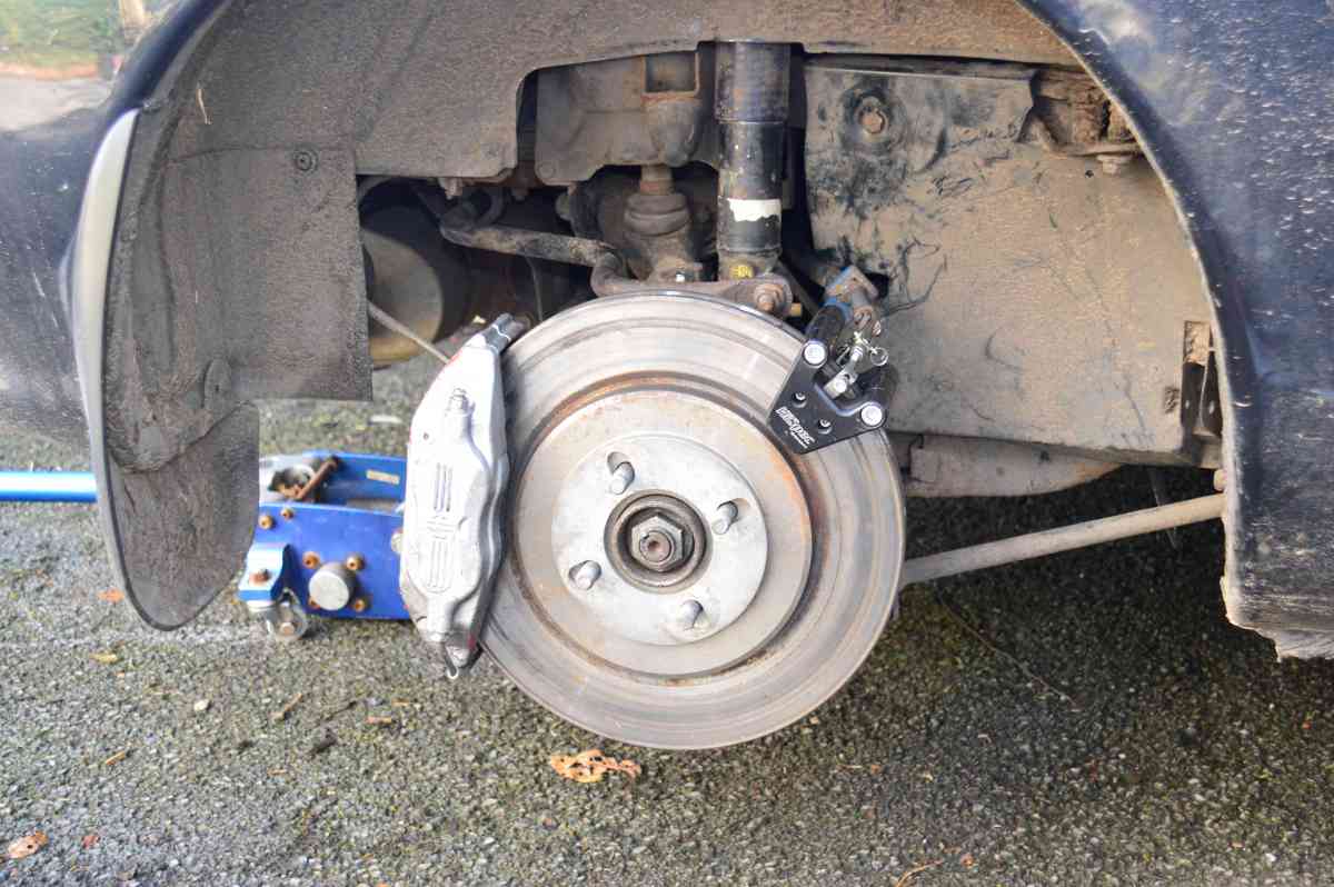

Posted 9 years 11 months ago #170120
Fits on here.
