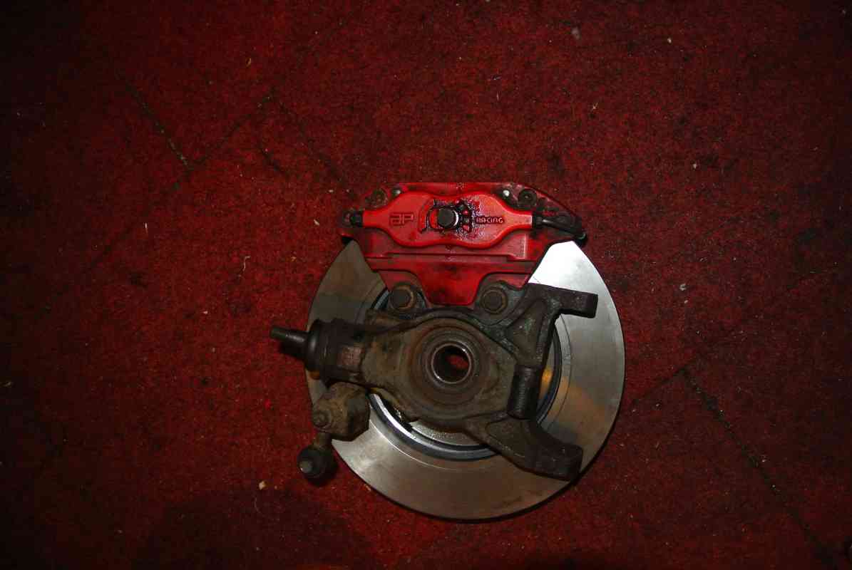

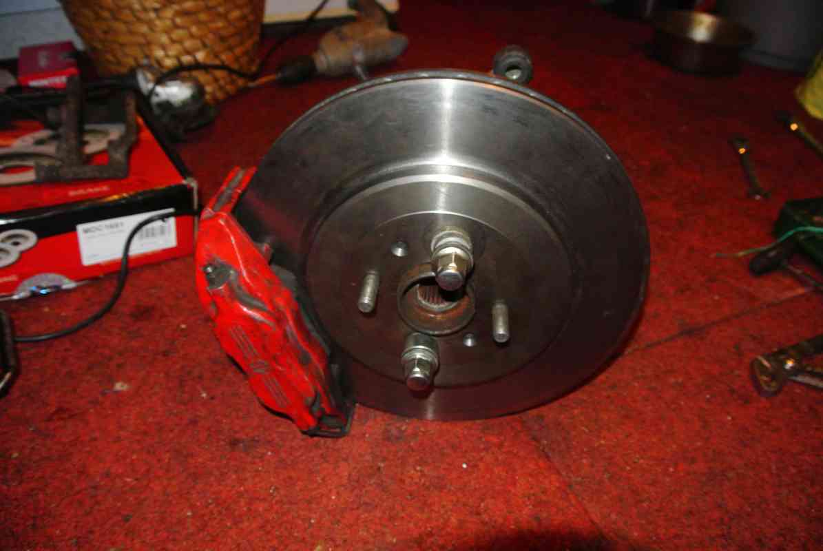

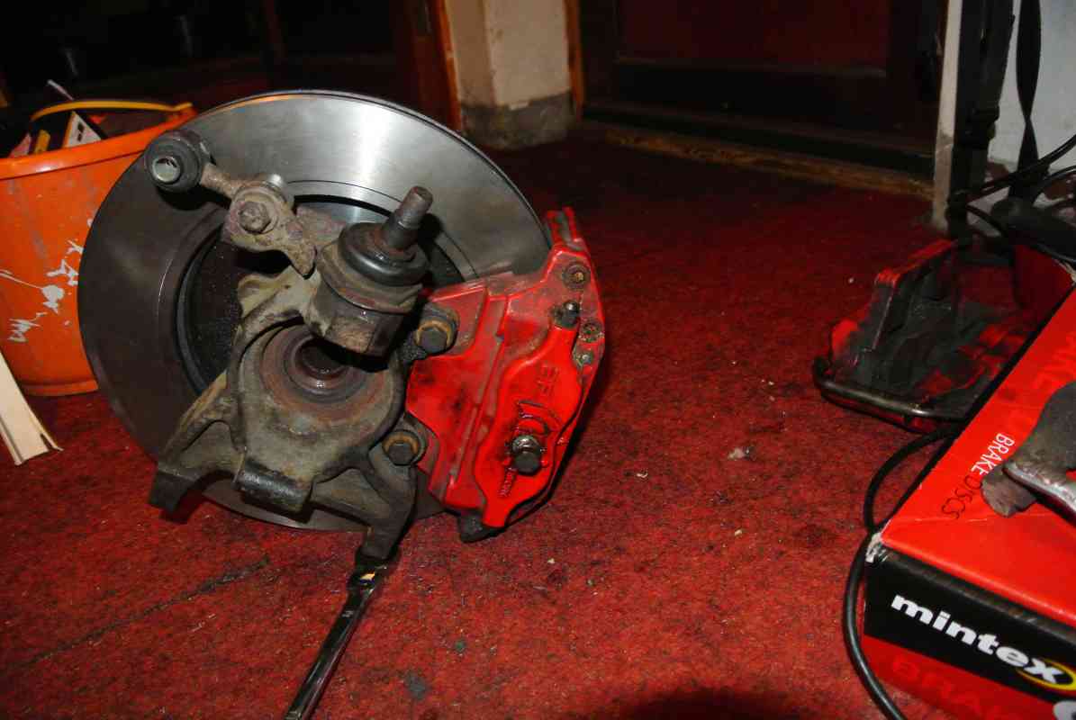

As I have a spare set of AP callipers i thought i would see how much work would be involved in fitting 304 discs and Aps to the rear.
The first issue is the obvious one - No handbrake. So I have ordered a set of additional spot callipers from Hispec. When they arrive I will detail how they would be fitted to the hub.
The next issue surprised me a little - the fixing holes in the hub don't line up with the threaded fixing holes in the APcalliper. The rear hub holes are at a wider spacing than the AP holes. So they would need to be redrilled. Further, even with the holes in the right place the callipers still won't fit without some re-shaping of the hub fixing area..
That's all for now. Thought people might be interested.
