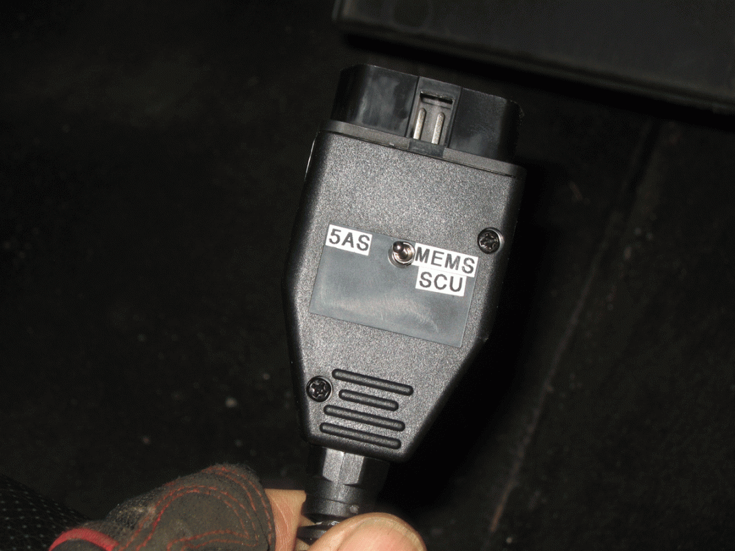

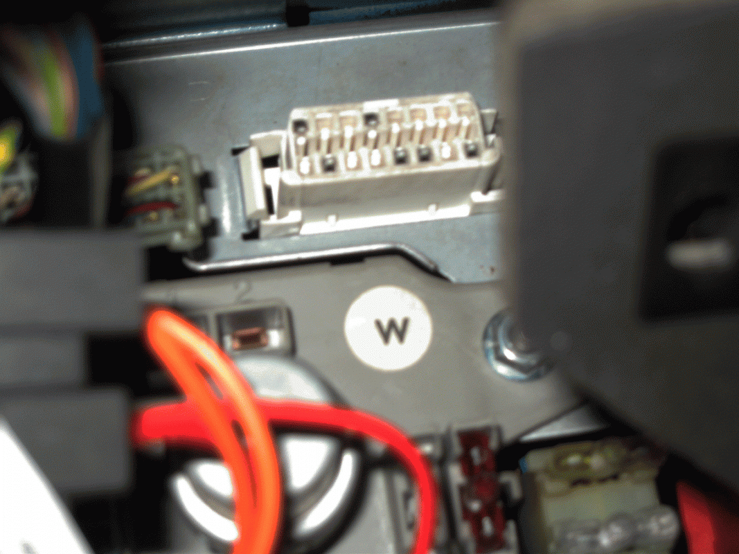

You attach it via the technozen lead to the diagnostic port which is top right of the fusebox under the steering wheel.
The lead has a switch left for alarm settings/right for ecu settings.
I'm starting with the alarm functions so switch to the left.

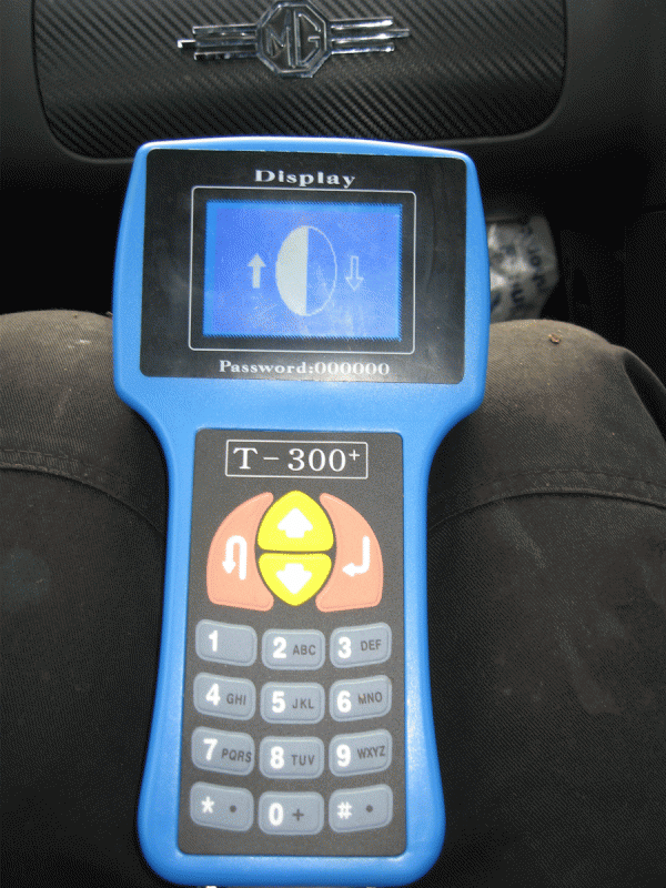

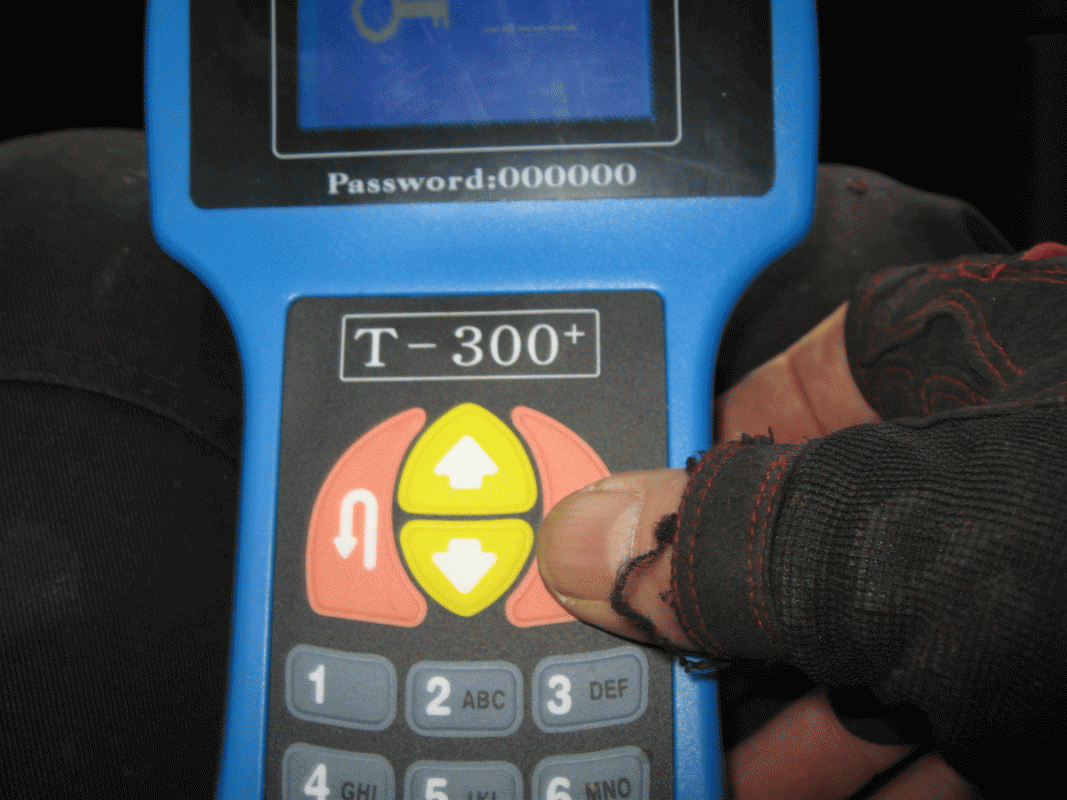

You plug in with the ignition off. The screen should light up and eventually show this symbol.
Press enter.
In this photo you can also see the buttons for scrolling up and down and the return button.

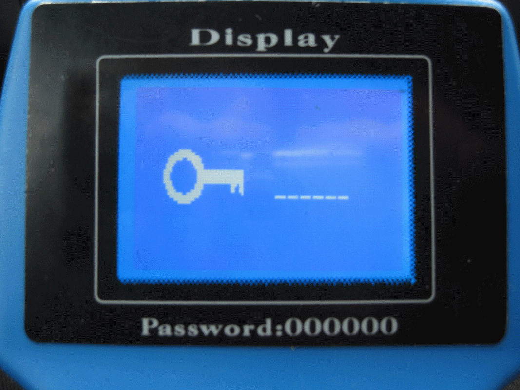

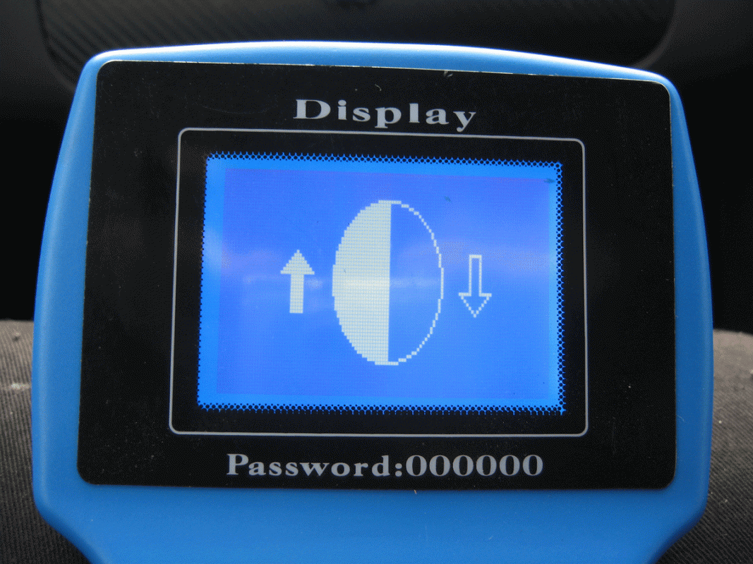

At this point you will be met with this screen.
You must now leap the hurdle of entering the super secret password. I will, of course, only supply this password for a deposit of £100.

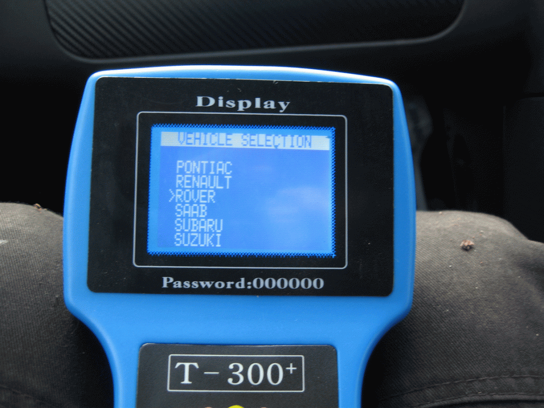

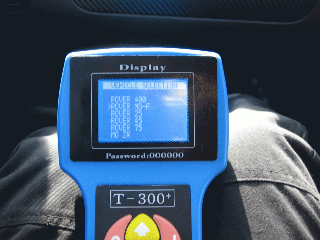

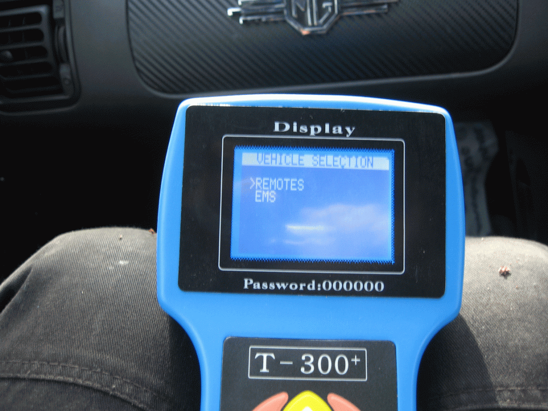

After the password you will get this list. Scroll down to Rover and press enter.
Now you choose remotes(inc EKA (emergency key access))- lead switch to left
or EMS for ecu faults etc. - Lead switch to right.
Pick your model and press enter.

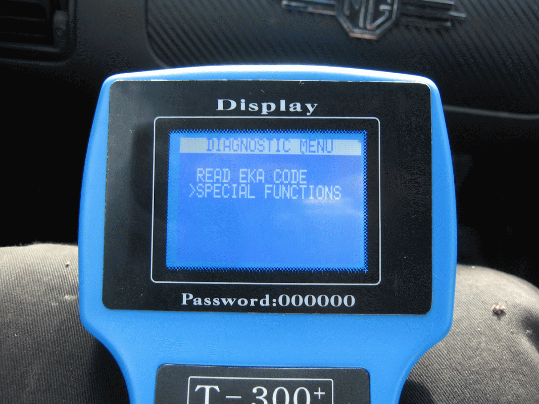

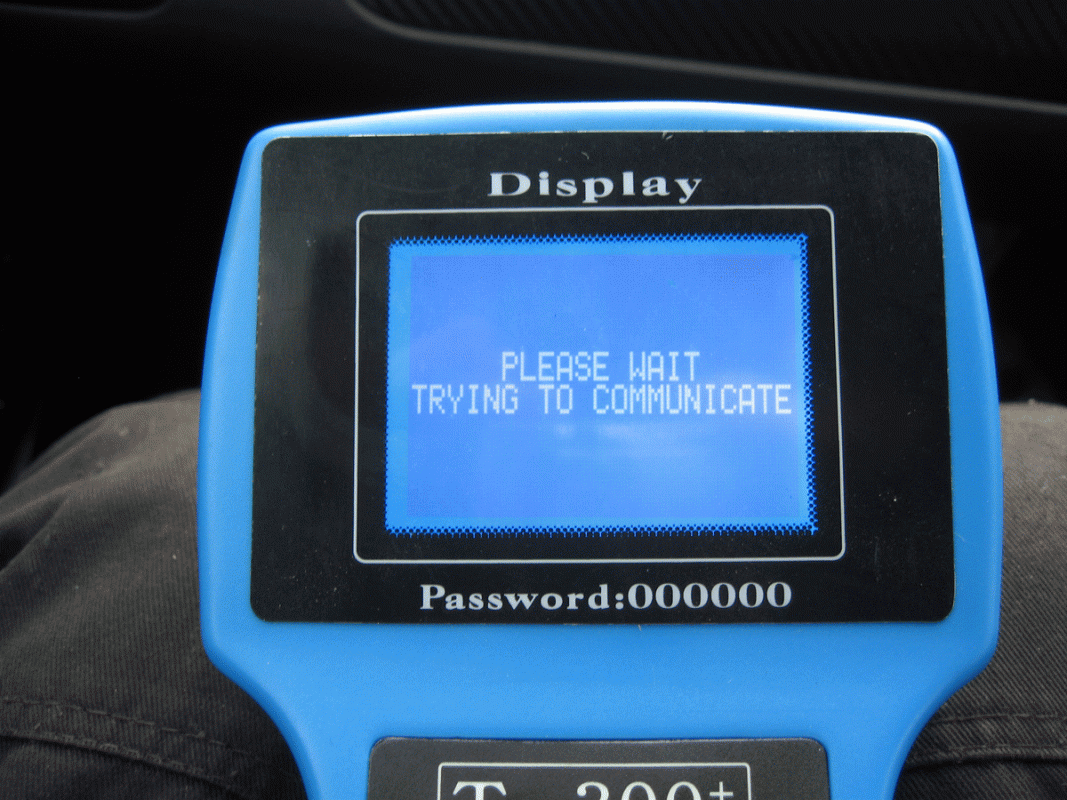

The unit will now ask you to turn the ignition on.
Turn the key to position 1.
If successful you will get this screen(or similar)
Click on Read EKA Code
