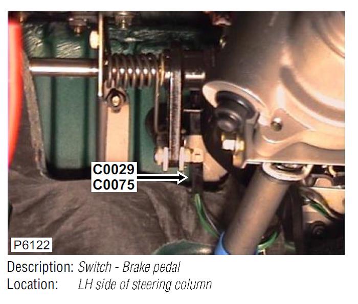

So now I've got my car back from MOT & servicing (the waterless coolant didn't arrive in time to use at this service) I decided to get the socket set out & try to improve the heater output. There was some heat coming through but would then cool off again after 10 mins or so. So I've bled the front and middle bleed points. I can't get at the engine bleed screw atm. But there's still no improvement. I adjusted the cable to the valve but that didn't improve it either. I did notice that the coolant from the rad was hot but from the matrix it was cold, not sure if thats right? And to add to my doom and gloom I noticed the brake lights are permanently on. Could I have upset something when playing with the heater control valve?
Any pointers gratefully accepted.
Chris.
Replied by Tourbillon on topic Re: Coolant Pipe, hose size diagram & leaks.
Posted 12 years 7 months ago #135828
Chris,
I would suggest that the heater going cold is down to an airlock in the heater matrix, so best cured by bleeding from the nipple under the bonnet. I found the best way to do this was to have the heater on full, car running ( expansion bottle cap off) and as the engine warmed through, kept releasing the nipple and bleeding fluid out, whilst keeping the expansion bottle topped up to the level.
The Brake lights are likely to be frayed cables on the passenger side of the car as the cable routes around into the high level brake light in the boot and shorting out. Test for this is partially open the boot, start the car and jiggle the cables ( don't earth yourself on the body). with mine it was half open and it you moved the cables the brake lights would blink on. Easy fix, you just need to splice in a section of cables and then cover in insulation. Leaving the final clip off the boot lid, stops the wires getting forced in such a tight curve and prevents future problems.
TB
Replied by a Guest on topic Re: Coolant Pipe, hose size diagram & leaks.
Posted 12 years 7 months ago #135836
Tourbillon wrote: Chris,
TB
Re: stop lights, I wiggled the cables running to the high stop light but no result. I did however notice that the brake lights blinked off when I turned the steering wheel also when I tapped the brake pedal sideways. Does anyone have an exploded diagram of the footbrake pedal showing the pedal switch? I guess thats where I'll be looking next.
Posted 12 years 7 months ago #135839
Picture of the connector pg 96 of the electrical manual
