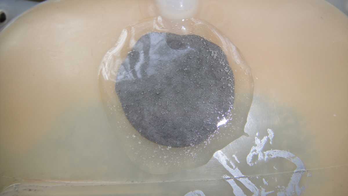

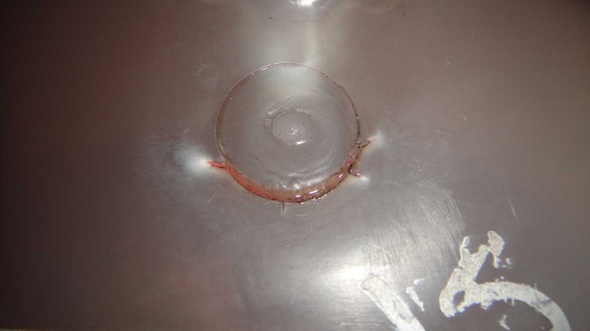

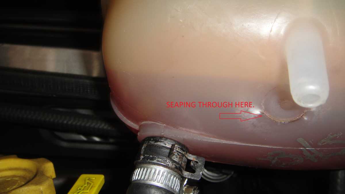

Ok, I tracked the leak down. It appears to seep through a weakened joint in the plastic of the expansion tank.
Inside view -
Attachment DSC06483.JPG not found

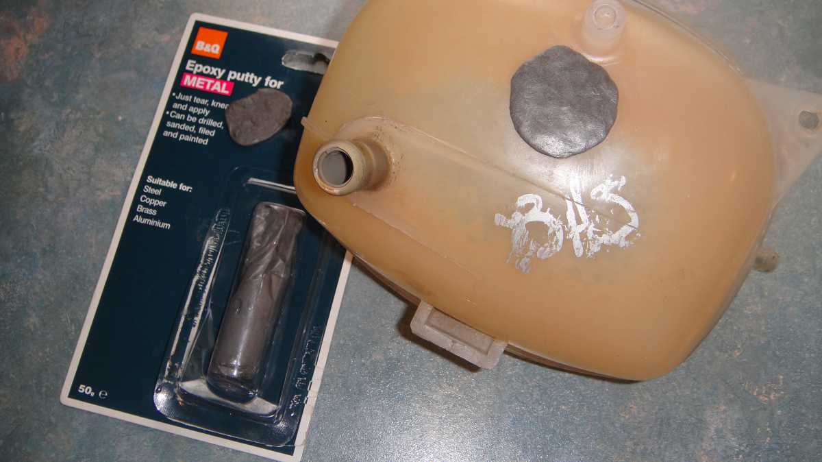

I've tried a hasty repair to stem the seeping. I warmed up the tank, but didn't put the cap on. So there's been no pressure on it as yet.
I'll try it under a bit of pressure later and see if it holds up under the strain. Do you think it might? :)
Replied by David Aiketgate on topic Re: Coolant Pipe and hose size diagram.
Posted 13 years 8 months ago #81123
It will probably hold, but I would get a new tank.
If it's cracked once, it must mean that the plastic is brittle.:shrug:
Replied by Leigh Ping on topic Re: Coolant Pipe and hose size diagram.
Posted 13 years 8 months ago #82721
David Aiketgate wrote: It will probably hold, but I would get a new tank.
It didn't hold so I swapped the tank for another one and then the cap gave out. New cap and all is well.. for now. :broon:

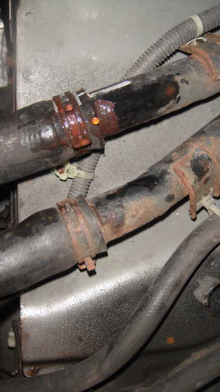

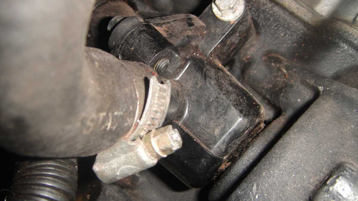

Just lately my car's been rupturing like a haemophiliac. Here's the latest source of blood loss that I found when taking some random underbody shots whilst having my new exhaust fitted. I'm convinced that I'm chasing the pressure around the system and fixing it as I go.
I'll nip up to B&Q tomorrow and clamp that area with some jubilee clips. Then see where the leak goes to next. Oh the joys of MG ownership. It can be so underwhelming at times. :lol:

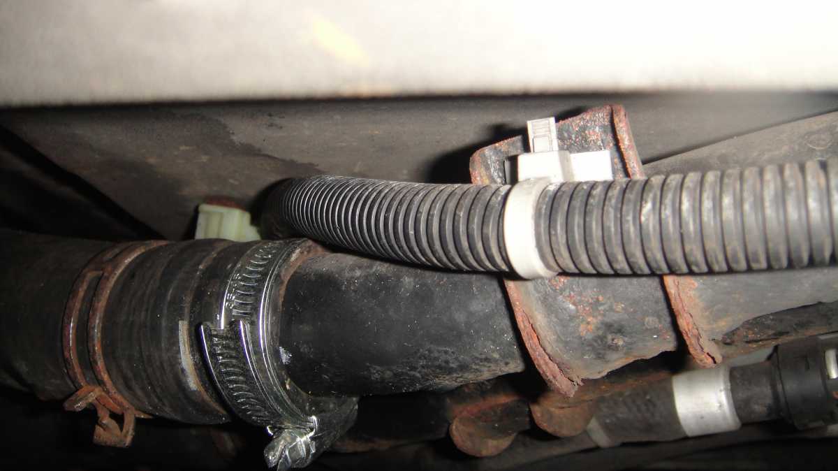

Here's how I fixed it. I just pushed the hose down and clamped it with a jubilee clip.

Replied by paulsmgf on topic Re: Coolant Pipe, hose size diagram & leaks.
Posted 13 years 8 months ago #83287
might be time for some st/st pipes Leigh

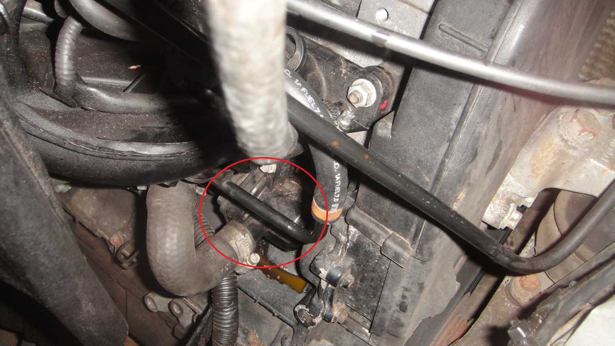

What's this leaking thing inside the red circle please :-?
Replied by David Aiketgate on topic Coolant Pipe, hose size diagram & leaks.
Posted 13 years 7 months ago #90992
That's the thermostat housing, Leigh.
