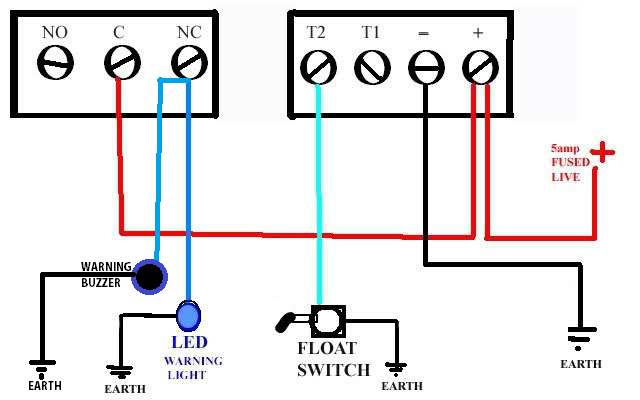

I was checking all this out and was cautious after I noticed that some of float switches on ebay are only rated to 85 deg C. :-? :-? Some are OK at 125 deg C
[IMG]ht[/img]
by Davem
Replied by bensewell on topic Low Coolant Alarm - How to fit one on the cheap.
Posted 12 years 9 months ago #128553
Those farnell ones are rated to 125c

I've built the one referenced in the photographed circuit diagram and it does wok, although I had replaced my expansion tank earlier as the old one split and the new one had the sensor built in. The relay part with the delay timer is useful as you can adjust the delay before the alarm goes off.
Total cost including wiring and more LED's than I'll ever use in my lifetime? A little short of £35 (The tank was £20 the rest components)

I need some electrical assistance. Ihave replaced the expansion tank with an oem tank with float switch.
Due to a fracture of the lower hose joint on the tank caused by the metal insert having slipped down into the hose, meaning when I tightened the hose clamp, the plastic broke.
Now because the switch operates in the opposite way to the maplins float switch, ie normally open i moved the connection on the timer unit from the NC to the NO terminal. All good in that the alarm sounds when the float drops,
BUT the alarm sounds immediately and stays on for the delay time.
Obviously I need to change something but I'm unsure what.
I suspect that I may need to connect the float to a live feed rather than to earth,and perhaps move the trigger to the other trigger terminal.
However I dont want to fry the timer module by guessing wrong.
Could someone with the requisite knowledge steer me right please?
