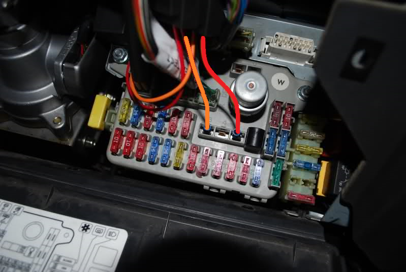

Now feed the other end of the looms behind the console and across to the fuse box.
I used one of the fuse box bolts to fit the relay and the earth wire.
The two fused live feeds(red 30a and orange 15a) I connected to the two spare live terminals with spade connectors. This means the seats will only heat up with the ignition on.

David, does the instructions tell you to take the supply from the fuseboard? I only ask as I'm not sure what those outputs are rated at and what the seats draw. My instructions show the supply taken straight from the battery.
Replied by David Aiketgate on topic How to fit heated pads to MGF/TF seats.(leather)
Posted 15 years 8 months ago #16685
CJJ;16679 wrote: David, does the instructions tell you to take the supply from the fuseboard? I only ask as I'm not sure what those outputs are rated at and what the seats draw. My instructions show the supply taken straight from the battery.
The kit is not MGR specific, so it doesn't mention those takeoffs. The circuit diagram does not specify direct battery connection, though. Wouldn't direct battery connection mean they could be left on, draining the battery overnight?:shrug:
Anyway, the pads draw max 1.87 amps each seat on postion 1 and max 3.75 amps each on position 2 so I hope those points would be man enough.:shrug:
