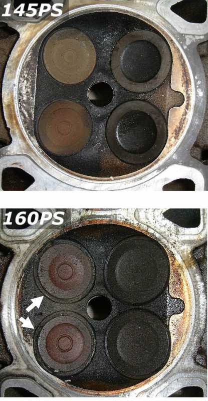

So.. if that engine made anywhere near 160 bhp.. whip the cam belt cover off and look at the pulleys.. Verniers? Look on the end of the cam shafts for the numbers (285 etc)
Got an Emerald ECU with it?
Take a close up pic.. or even better measure with a vernier gauge the inlet ports..
Unless someone has spent a lot of money on that engine.. its 120-135 bhp im afraid..

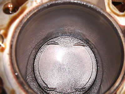

This is the TF160 2004 engine I bought from a company 2 years ago.. I paid £600 for everything you see in the pic.. plus fob, ECU, immobiliser unit and engine loom
The engine number checked out as a 160.. and when the head came off it the pistons had the correct markings on the top
Compare the pics of this genuine TF160 engine to the pics of your engine..

I Have a 160 engine here with 18K4 KN3 and a 145 engine on a pallet destined for France 18K4 KK6
One of my 160 bottom ends the 160 shown in top of piston.

Replied by mrsoldier on topic MGF (The Beast)
Posted 12 years 1 month ago #143769
Hey Guys,
He just checked the numbers on the engine and its an 160 ,
It got the right cams with the numbers on it ,
Like on this picture
He says , that the ecu (computer ) will generate higher REV limits
I get an ecu swap to , so i believe he's right (bought many stuff from him and always good)
