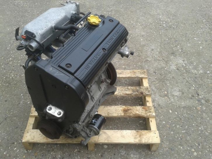

Here is the new Trophy 160 engine ,
With new MLS Headgasket
Can't wait until it runs :D!

Just me probably.. But has it got the VVC belt cover on the other end?
Have you checked the engine number to make sure its deffo a 160?

Im pretty sure its an 160 HP engine ,
It comes from an MG TF 160 model the newer types if im right !
that engine seems cool with the red !! must be more than 160 hp :pinch:

Look for the belt cover on the far end.. At least then you'll know its a VVC.. So either 143 or 160.. Late 160s had oil coolers on the block.. Which yours doesn't have in the pic..
Or look up the engine number on the block

You're right Allan, the engine number will confirm the provenance of the engine, but this is certainly a MEMS3 engine - so making it that little more likely to be a TF160 lump than a an earlier 145bhp version, but it will be good to check.
