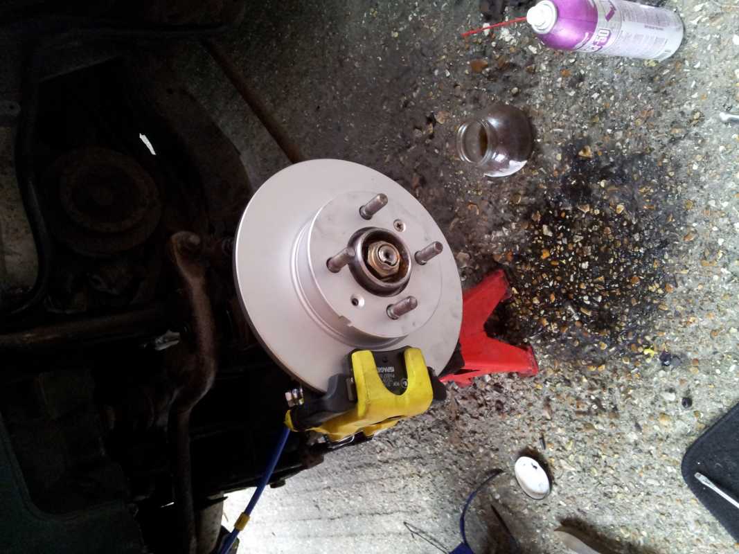

Got a new caliper, hose, disc and pa
ds on one side today. Brrr, in the snow.

Replied by Nobrainer on topic Banger to track car
Posted 13 years 4 months ago #104985
Left the car at the garage today to sort some bits so I now have an MOT! Wahay :-) They also did the front tracking, put the other caliper, hose and disc on and put through some ATE SL6 brake fluid through. So I owe them £100 :-( but the Mrs is happy I didnt spend another day under the car and Ive probably saved a few quid on the chiropractor. Oh and I put the 52mm throttle body on that Id never got round to selling :-)
I have to say though I have a bit of a problem with this site. Whenever I log in I find something else I have to do. Its getting bloody ridiculous. Now I have to check the coolant hoses. I'll update the todo list at some point but cant be bothered at the moment 'cause its so long.
