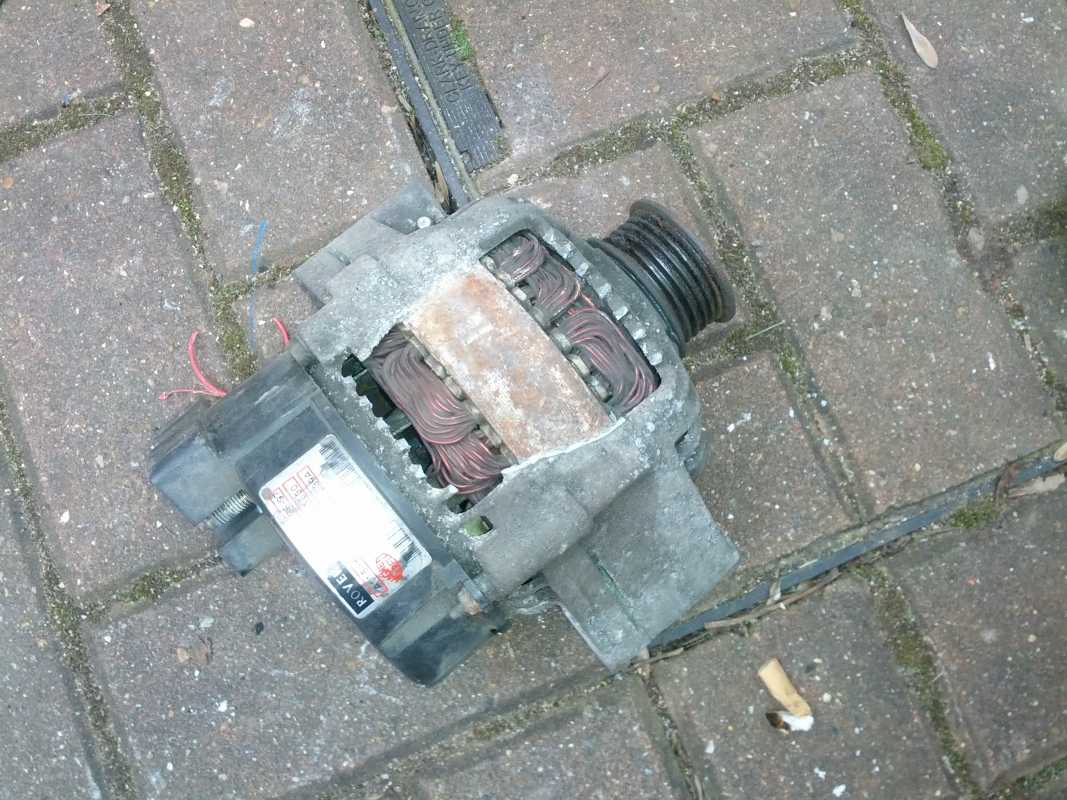

Swapped the alternator out for the exploded one... This is jammed solid and a post mortem revealed it was nothing but "cattle-trucked" inside....
Yeah, your guess is entirely as good as my one....
