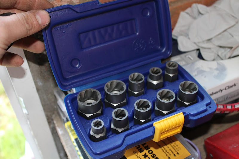

As I've mentioned I'm planning this to be a "soft restoration" so off comes the knackered and holed rear backbox, I've never come across such corroded bolts in my life, so out came these wonderful little bits of kit:
However, these even were beaten by one bolt made out of cheese, so there was nothing for it, the exhaust had to come out the "less pleasant" way:

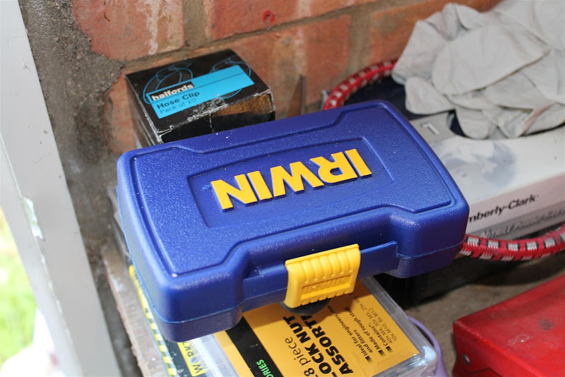

Little mod I picked up for a bargain last night!

i have a complete set of those bolt removers too, the come really handy in removing a rounded bolt on the caliper carrier of the TF and even better i got them free from the IRWIN Rep lol
nice work on the car by the way
