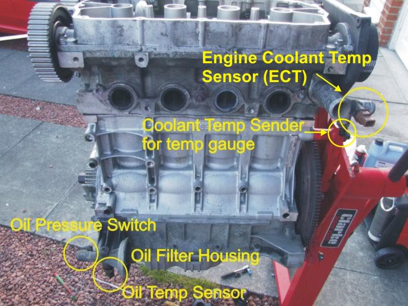

Finally got to look at this tonight - are there any checks I can do to rule this out? Where is the best place to purchase a new sensor. I went across the plug on ohms and it seemed to kick the fan in... any type I need?
by Tiger78
Replied by David Aiketgate on topic Re:Temp gauge drops on rev
Posted 9 years 8 months ago #173040
Yes that's the coolant sensor that controls the fans.
The gauge coolant sensor is underneath that one.
The following user(s) said Thank You: Winko, Tiger78

Replied by talkingcars on topic Re:Temp gauge drops on rev
Posted 9 years 8 months ago #173044
Tiger78 wrote: Thanks - think I have bought the wrong one then - or are they both the same?
No, they are different and give false readings if used in the wrong location.
IIRC the blue one only has 1 lead.
Further more MEMS 1.9 and MEMS 2.0 cars use a blue sender for the gauge and a brown one for the ECU while MEMS 3 cars use blue for the gauge and black for the ECU, black, brown and blue are all incompatible with each other.
The following user(s) said Thank You: cairnsys, Tiger78
