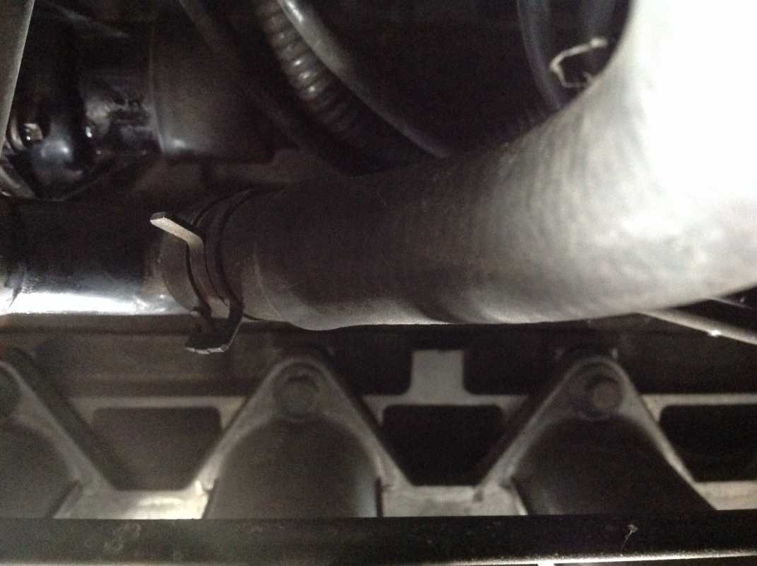

What are these clips called?
  • Beth557
  • Posts: 317
  • Thanks: 57
What are these clips called? was created by Beth557
Posted 12 years 1 month ago #144445
They have gouged chunks out of my hands and arms today the biatches, but some are fairly rusty so I think it would be worth getting a supply of spares in.
What are they please?
by Beth557
Replied by JanCo on topic What are these clips called?
Posted 12 years 1 month ago #144451
Scrap. I tried reusing them when I replaced my water pipes but 2 of them didn't seal properly. Ditched them & fitted stainless jubilee clips instead, 35mm-45mm iirc.
For the record, think they are just spring hose clips
by JanCo
The following user(s) said Thank You: Beth557
Replied by PQD44 on topic What are these clips called?
Posted 12 years 1 month ago #144455
+1 on using jubilee clips. Look out for them at Aldi, they do a box with assorted sizes for about £3.50.
Replied by John and Sue on topic What are these clips called?
Posted 12 years 1 month ago #144459
I know them as spring hose clips. I use Mole grips to release the clamp action, though there is a special tool available to unclamp them but ....... as has been suggested, replace with a good quality worm drive (Jubilee) clip. On this subject, I use a socket on the hex screw head, having suffered injury via slipping screwdrivers. Also does 'em up nice and tight.
  • Beth557
  • Posts: 317
  • Thanks: 57
Replied by Beth557 on topic What are these clips called?
Posted 12 years 1 month ago #144461
I've been using my mole grips which work a treat, didn't know there was a 'special tool'. Will be replacing with jubilees post haste. Thanks all very much.
