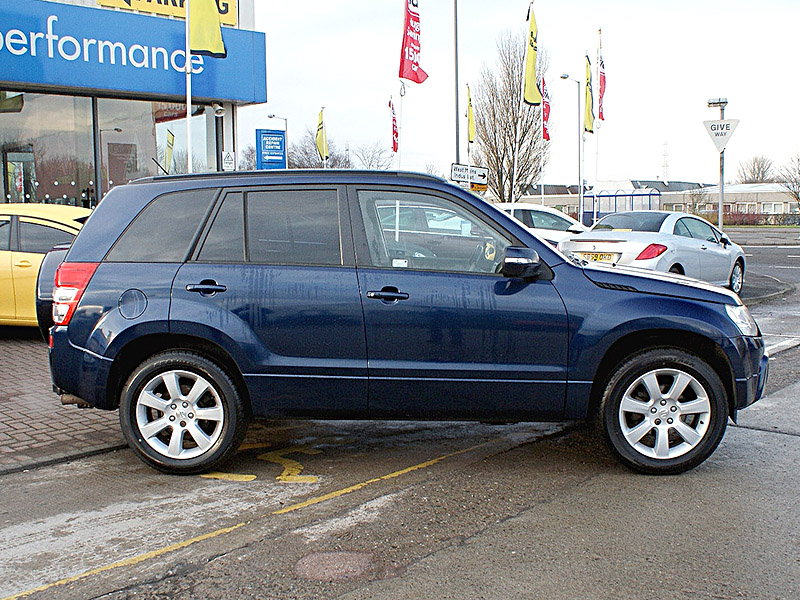

We also have a new edition; our Shogun was getting past its best so we were going to change like for like, just a newer with less miles; until we looked at the road tax. £470 (thanks to Gordon Browns Chelsea Taxi tax)
We ended up with a 10 plate Suzuki SZ5 £280 per year road tax. Hoping for the same Japanese build quality and reliability as the Shogun.
