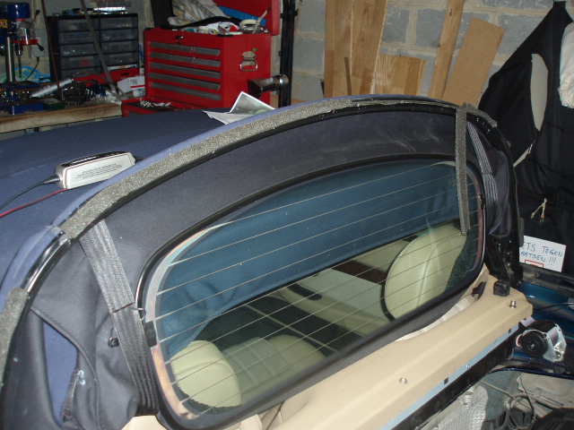

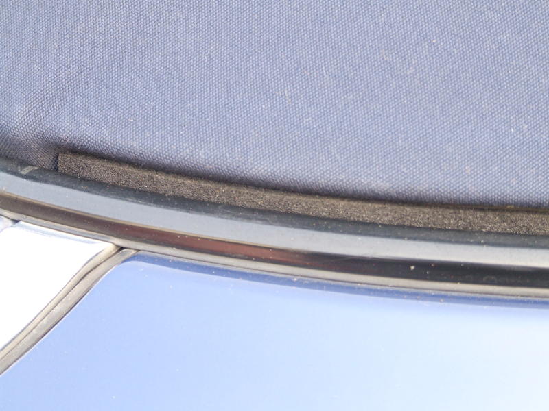

looking at my old blue F you could see the rivets around the edge so i thought how can i ger rid of the gap
i had some neoprine ruber on a roll with sticky tape on one side
cost £3.00 off eay for 1.5 mtr

before
after

defo geting some of this, some fs and tfs the hood sits nice and tight and you dont see the rivets
