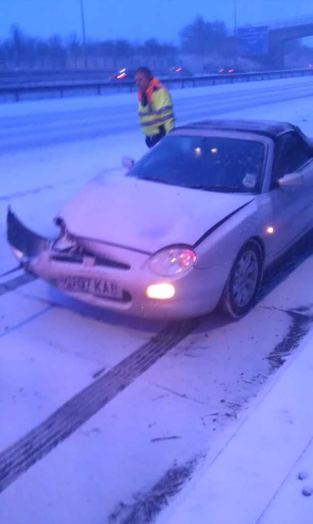

Had a spot of bother on the motorway on Saturday. Some arse decided to drift into the middle lane where i was going 40mph in 5th gear low revs trying not to spin anything. So i braked to not hit the other car and ended up doing a bit of a weave had a choice of hitting someone in the left lane with kids or trying to stop. I tried to stop by gearing down and pumping the brake but ended up spinning about a bit more and hit the central reservation at about 10mph. The car was still driveable but i got out quick and abandoned and got to the hard shoulder barrier.

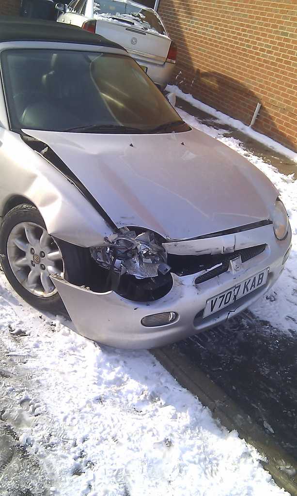

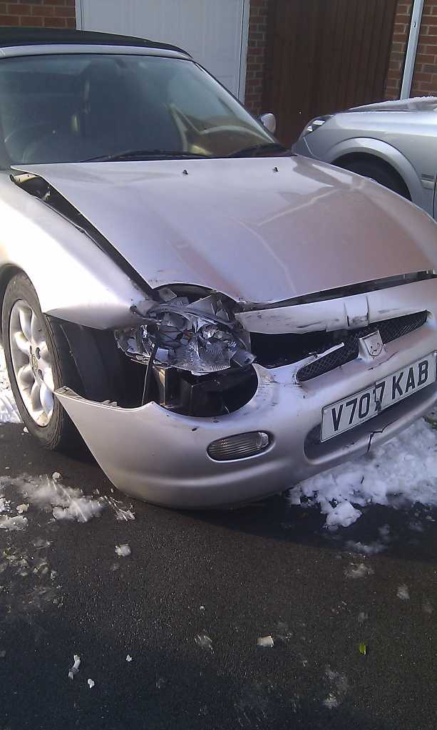

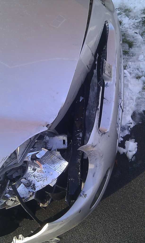

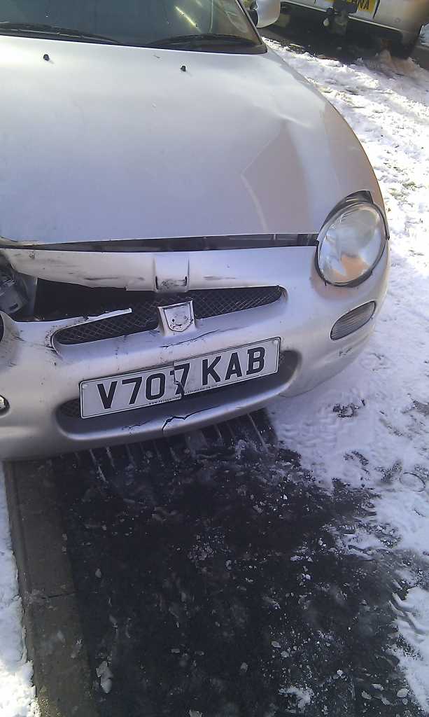

Pics below. It looks OK starts and drives OK. With my very limited knowledge it looks like it needs a bonnet, wing, front panel, head light and probably the front black bar that the bumper screws onto.
Insured for £1500 so i think it will get wrote off but i can probably buy it back for cheap and make it nice again with a bit of patience.

Never use gears to slow on a RWD car in these conditions as it is virtually the same as putting the handbrake on.
Bad luck on the accident mate. Anything is fixable, what you have to decide is what sort of budget you are prepared to throw at it.
Will it need a new subframe or suspension components?
Insurance wise it is most certainly a write off, but I couldn't let DeepBlue go for that sort of damage and would fix her. But I am sad and she is my baby. ;)

Wings are bolt on and second hand will be around £50, bonnet should be £50 - £100, bumper should be around £100 - £150 and headlight £50 - £100. If you are lucky you could get them all in the right colour on e-bay.

If it really was as low as 10 mph when you hit the barrier then its probably all cosmetic, looks like it was a bit of a glancing blow too.
Your crumple zone has done its job.
Second hand bits and pieces or get to a scrap yard and see if you can source the parts there, it will be lots cheaper, you might end up with a bit of a patchwork car but bonnet, wing and bumper re spray shouldn't be too much.
