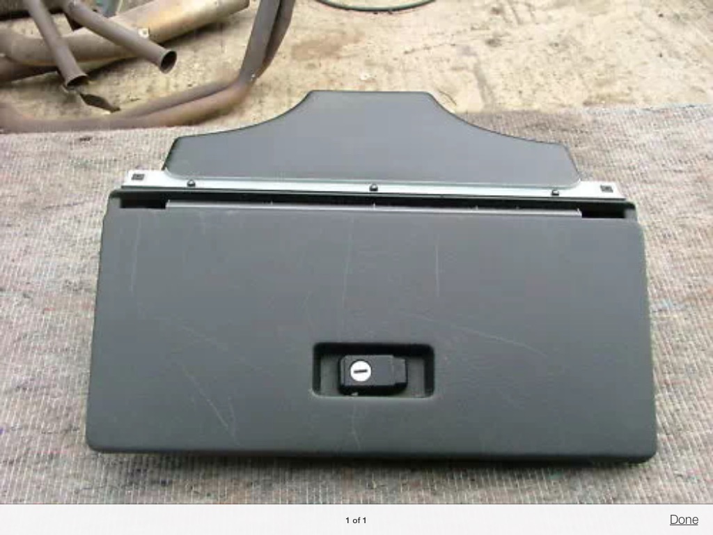

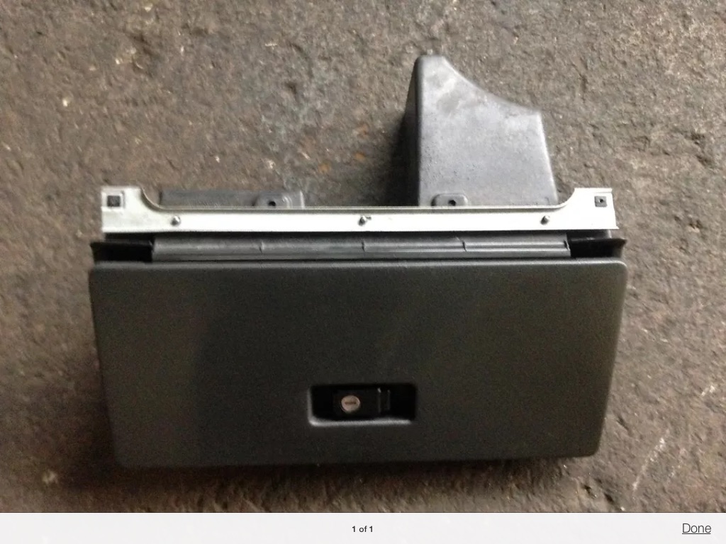

Replied by Andy Lawrence on topic Mk2 A/C in a mk1
Posted 11 years 2 weeks ago #160474
Your right cobber.
Aircon glovebox
Normal glovebox
