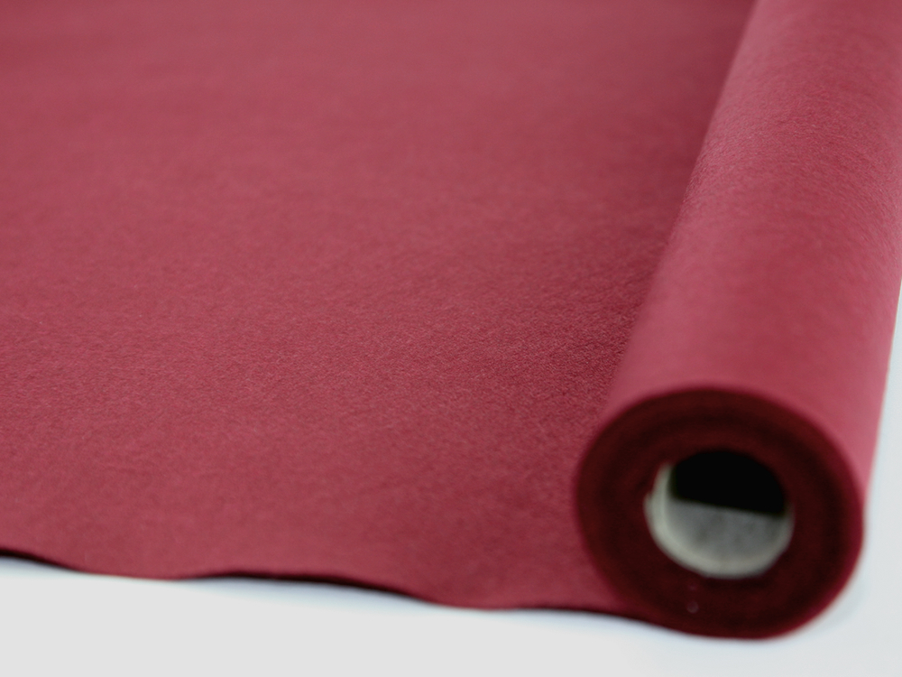

Replied by David Aiketgate on topic Felt up-and I love it!
Posted 12 years 1 week ago #146243
Nah the hood is triple layer with a membrane in the middle. Nice wine red felt available, :lol:

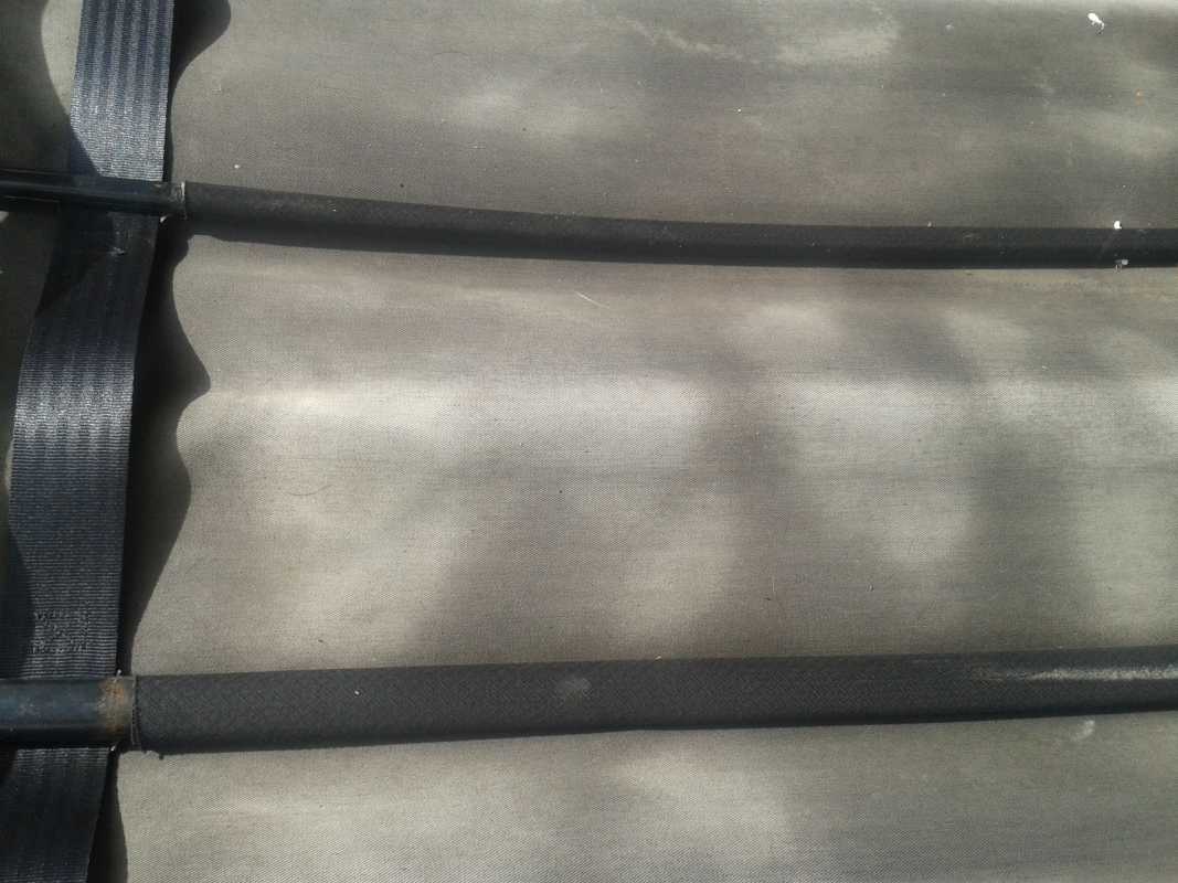

Replied by David Aiketgate on topic Re:Re: Felt up-and I love it!
Posted 11 years 11 months ago #147413
The bars are already covered with a similar material that is part of the hood. Basically it's what attaches the hood fabric to the frame bars. So you can't really tuck under, I just used the bars as a useful place for the joins(overlaps) in the felt, but I suppose you could butt up the felt to the bars. In my case it didn't make much difference as the material already around the bars is a pretty good match for the black felt.
It's the belt type webbing between the bars that allows you the choice of over and under.
You can see the existing fabric covers on the bars here:-
