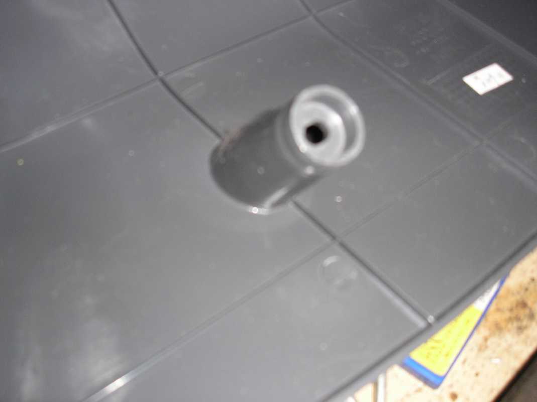

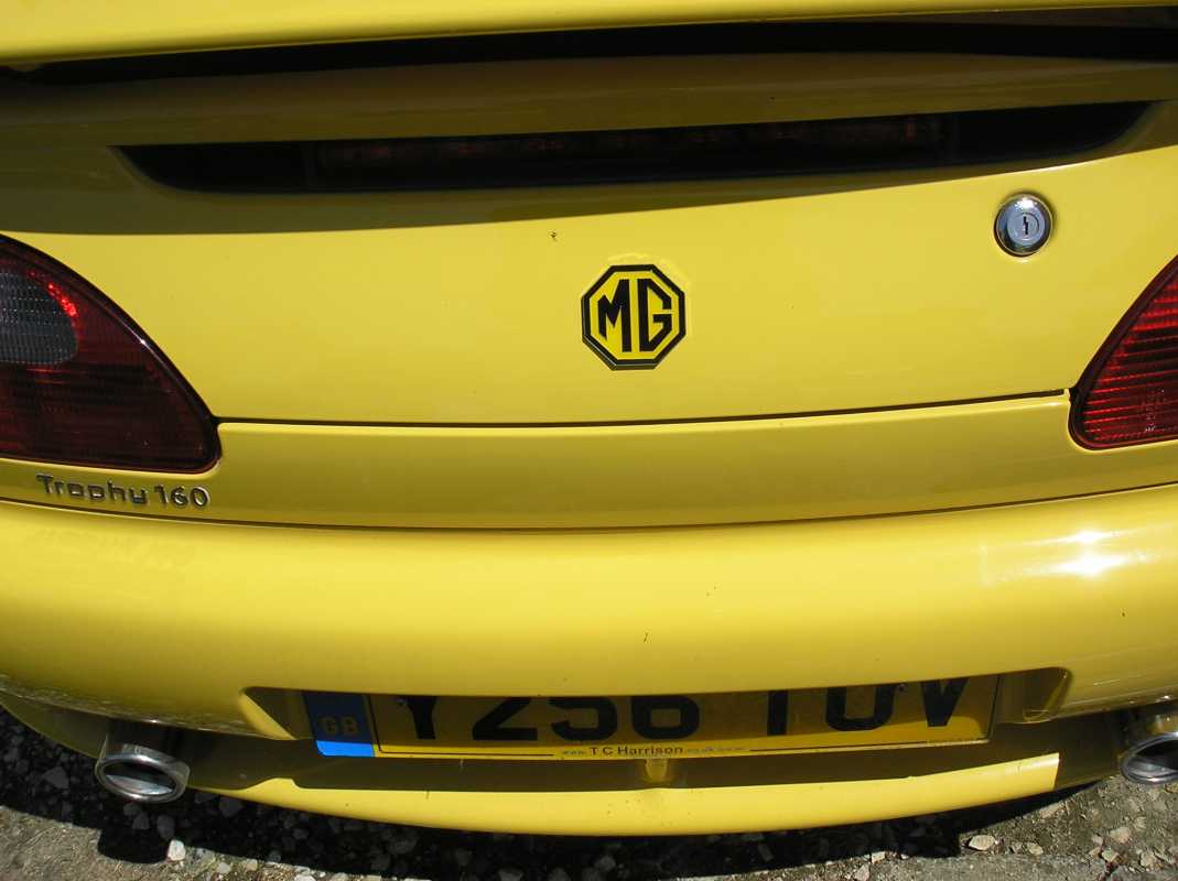

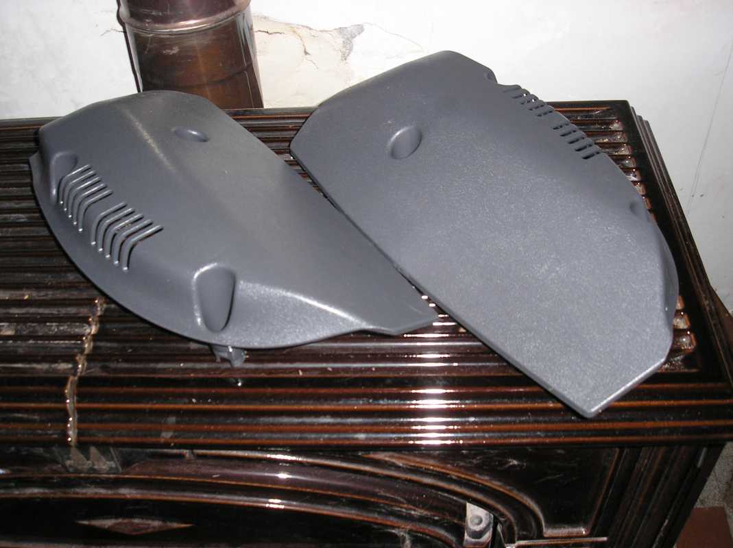

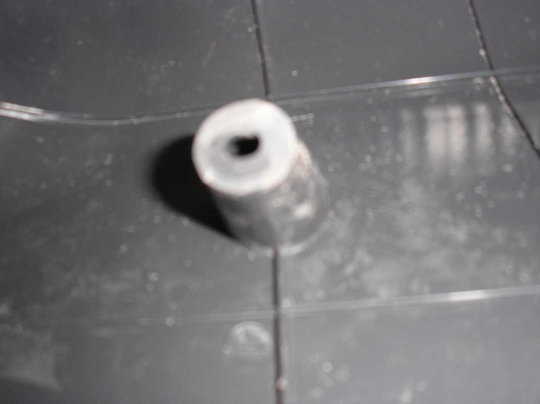

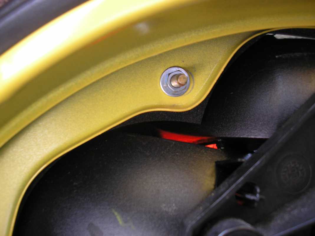

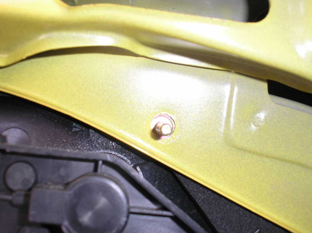

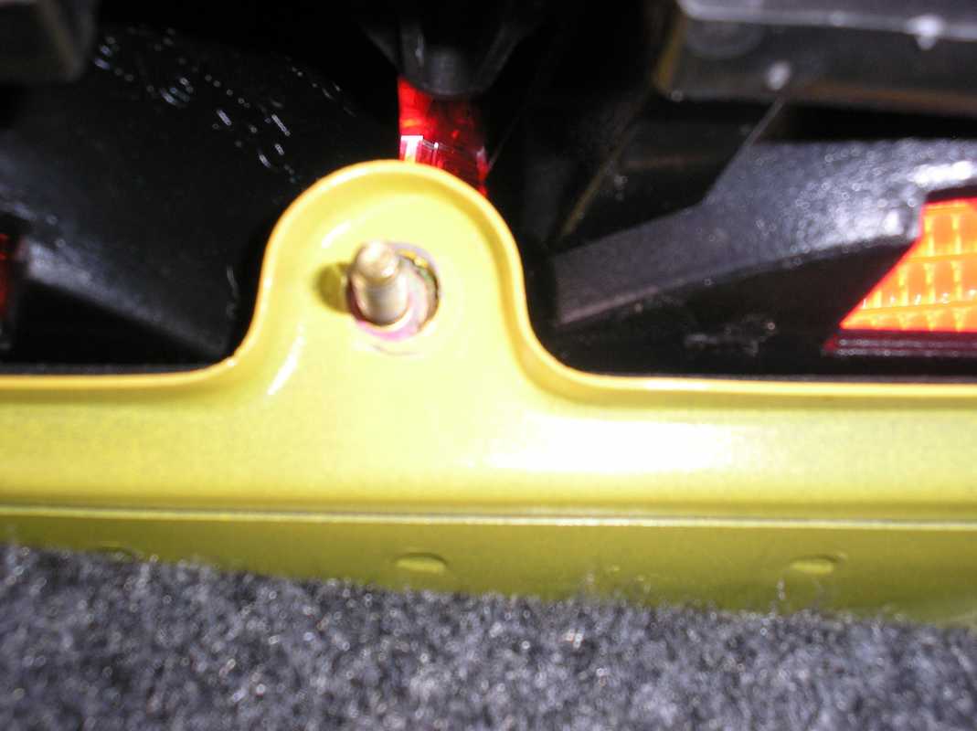

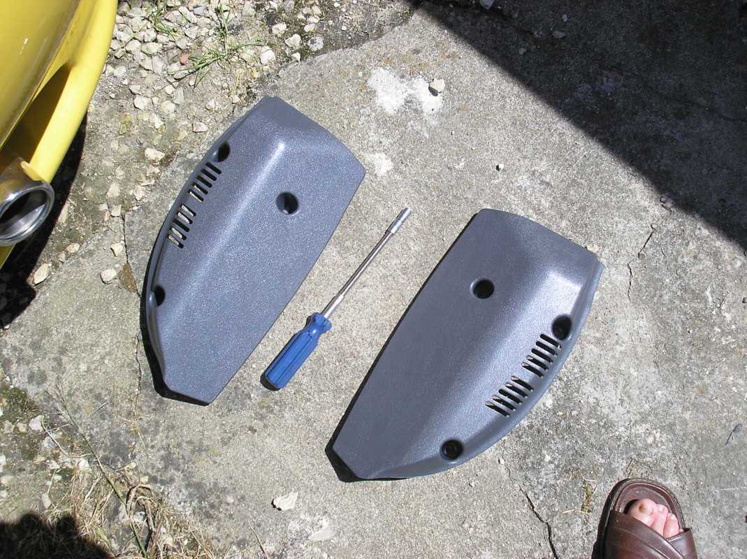

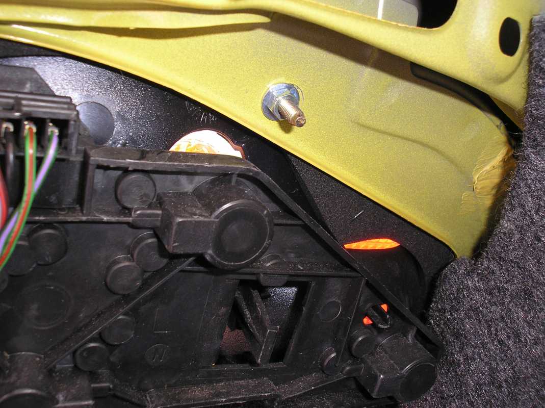

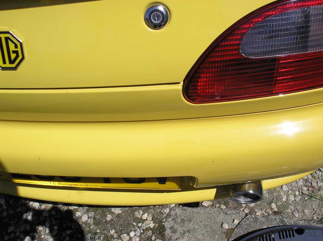

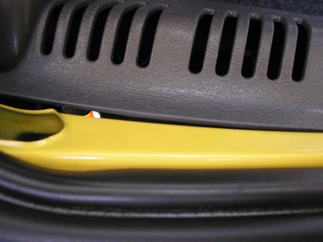

I opened the packet it was well wrapped , I then when the sun was at 34^ offered up the first,
the book says leave the nuts holding in the lamp and buy more nuts with spreaders attached at a silly price,
I didn't like the gaps, 'I am a bogger me' so off to the shed, raining now- and saw that a collar was provided for avoiding original nuts.
So off with the collars with the hacksaw, smooth with sander/file, lost my 1/4 socket, so had to drive 40 miles to borrow an extension,
darned if I know where it went.
Now look at the differance I have made of the job. I am well pleased, Ken

Beautiful job and a great final result. Thanks Ken.

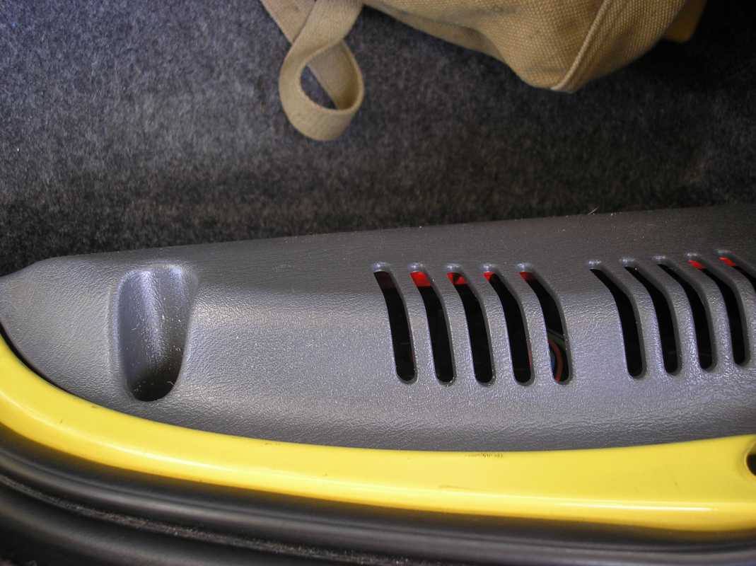

Replied by alanrt54 on topic Re: How I perfected the fitting of rear lamp protector
Posted 14 years 3 weeks ago #55302
I fitted my light covers last Sunday. I did not modify the covers and could only use the top fixings as the lower stud was not long enough.
Did your mod allow the bottom stud to be used?
by alanrt54
- Yellow Peril
- Posts: 379
- Thanks: 54

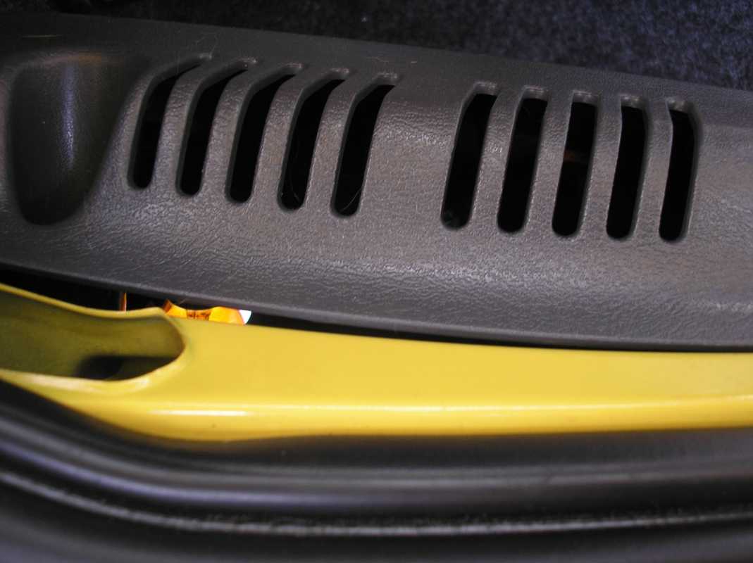

Replied by Yellow Peril on topic Re: How I perfected the fitting of rear lamp protector
Posted 14 years 2 weeks ago #55325
Yes indeed Alan, fussy bu**er that I am, and it closes the gap at the top so no wasted light escapes nor small spanners fall in,
I did consider glue-ing kitchen foil to the insides [or painting silver] as the MGF rear lights are not glorious in the sun, but for now?Ken
by Yellow Peril
Posted 14 years 2 weeks ago #55342
Just had a look at my unmodified covers. There is no gap at the top, They seem a snug fit even though only held in place by the top 2 fixings.

Posted 14 years 2 weeks ago #55344Alan - I did exactly as you did about 6 months ago and can confirm they are still tight and good.alanrt54 wrote: Just had a look at my unmodified covers. There is no gap at the top, They seem a snug fit even though only held in place by the top 2 fixings.
