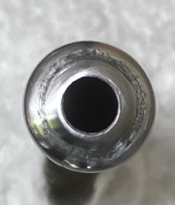

Right an update and a request for opinions from those with practical experience of these things.
First thing to say is that with experimentation and time I believe it is possible to extract the pipe from the ABS unit to the front near side calliper “in one”
After pushing and twisting and eventually pushing it to the offside so that it could be extracted from the rest of the bunch at the ABS I managed to get enough out of the wheel arch and rotate the end to get a good visual inspection rather than cut it off and renew the flare in-situ with the words of wisdom from “TA22GT” ringing in my ears.
After a little cleaning up the end appears to be formed such that the very central section contacts the female part (in this case the hose) before the outer ring which all might be clearer if seen in the attached image.
So in my opinion this end flare and fitting is “fit for service” or at least a trial as in service it is only the inner ring of the cone around the bore that appears to have been making the seal.
If others think not I’ll be interested to hear more and why. It is important to get this right.

Replied by Delbourt on topic Brake pipe flares
Posted 1 month 1 week ago #223693
Photo that could not be attached in previous message
Good for use?

Replied by TA22GT on topic Brake pipe flares
Posted 1 month 1 week ago #223694
I have found with brake pipes that they tend to leak immediately once they are subjected to pedal pressure.
If they are sound they tend to stay sound and checking them after a run if there is no leak it usually means all good.
On the steel pipe I flared on the car I checked it for a few days because it wasn't the perfect flare I can get with copper. It has remained tight.
I would be at least trying that pipe and if it holds brake pressure initially it won't suddenly not...meaning if it doesn't hold it will be a weep and not a catastrophe.
Others may differ.
The following user(s) said Thank You: Delbourt, Red110
Posted 1 month 1 week ago #223695
My thoughts exactly. Looking down the bore of the mating female thread it would seem that it relied or utilised only the area i described closer to the centre of the tube.
So it’s going to get a trial.
If it weeps I at least know or think I can remove the tube/pipe in one piece to use as a template. The trick to getting it virtually out was to first of all “persuade” it to duck under one of the other brake pipes and move it further to the offside of the car then wriggle it out from one of the others feeding the rear.
