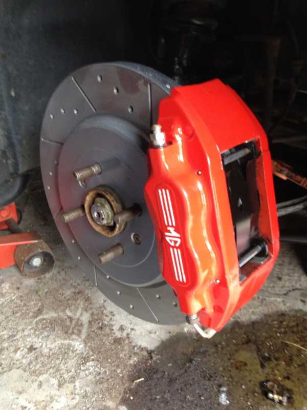

Replied by Alans835 on topic Quick Question about the brakes.....
Posted 12 years 10 months ago #126409
Dext924 its worth checking that your pads are not binding up in the brake carrier or calliper (depending on what type of callipers you have) as this can give a dull feeling to the peddle. I have just overhauled my TF's front AP's and back brakes and the car now has some of the best brakes I've ever felt in a car. Poor quality discs and pads can also give avert dead feeling to the brakes aswell just something tobear in mind when buying new stuff. I use mintex on the MG padgid on my jaguar and find them both excellent. Does your front brakes have these callipers fitted? This is mine after I overhauled them and gave them some fresh paint. Ferrester if you are on .org then pm jaylad he makes up brackets and sells them I got 1 off him and the quality is very good, still to fit it tho although I think you might need the newer type snorkle fitted not sure tho.
Thanks
Alan
