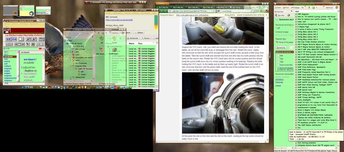

Sorry, I send my full size 2Xscreensprints, but you'll have to zoom in a bit to get them readable!!!!!!!!!
