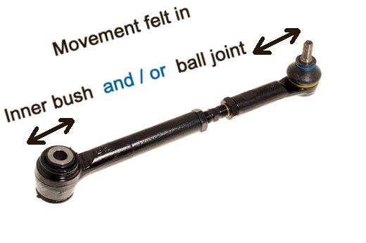

You may get an advisory or a fail at MOT time for excessive play in the rear track control arm (the inner bush or the ball joint of the track rod end) or find it during the checks you do every couple of months :whistle: You notice that with the rear wheels off the ground you can feel some movement, in and out, when gripping the wheel at the 3 and 9 o'clock positions.
Excessive wear in the rear track control arm can eventually be felt through the car which may feel 'slightly odd', with possibly judder felt from the rear or in the car during acceleration or braking. Uneven tyre wear on the rear may also be seen.
See Clive's How To for steering checks
In my case the movement was in the ball joint at the end of the track arm. When trying to purchase a replacement a call to my local motor factors revealed the MGF rear track control arm, part No. RGZ100050, is priced at between £100 and £254 depending on where you ask. The ball joint on this component is described as non-serviceable and does not appear on their parts lists.

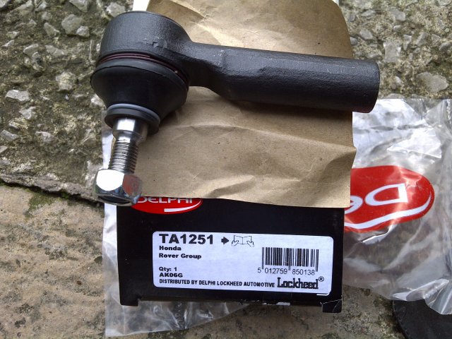

A quick search on the internet reveals suggestions that the front track rod end off the Rover 200 will fit the track control arm. £6.50 later a Rover 200 track rod end is purchased ready for the job.

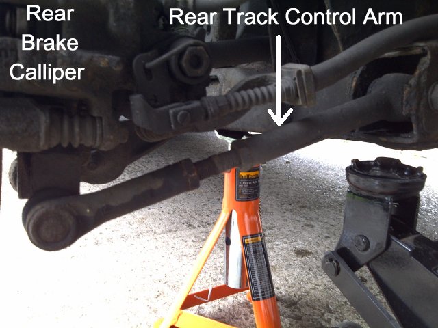

Chock the front wheels then raise the rear side of the car to be worked on. Having secured the car on axle stand(s), remove the wheel. Penetrating oil can now be applied to the areas to be worked on.

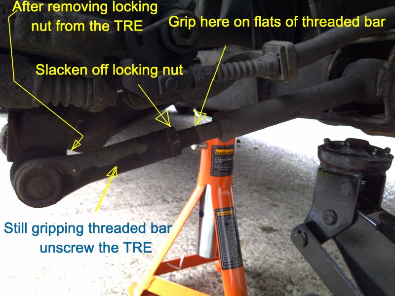

Release the nut off the end of the track rod end, TRE.
You now need to use the ball joint splitter to separate the arm from the hub.
As shown in the photo above the order of work is;
To remove the old TRE, use a spanner or monkey grips hold the threaded bar in place. Slacken off the locking nut next to the TRE. Still gripping the threaded bar then unscrew the TRE.
Screw the replacement TRE in place.
Fit the TRE bolt through the hole in the hub then using a torque wrench on the new locking nut tighten to 30Nm.
Go back to the other end of the TRE and tighten the locking nut on the threaded bar up to the TRE.

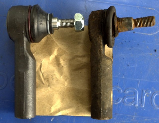

This photo shows the new and old TRE's side by side. I checked all the relevant measurements and the two are identical from a functional point of view.

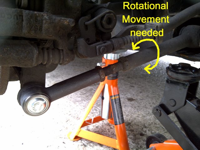

Replace the bush and then reassemble using a torque wrench to tighten the bolt to 80Nm.
NOTE: There should be some rotational movement of the track control arm.

Do we have a part number for the Rover 200 TREs?
