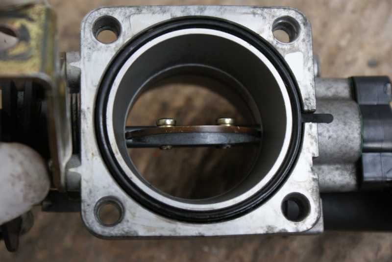

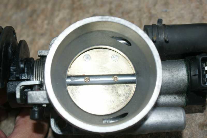

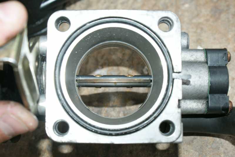

Re-assembly is now just a case of rotating the spindle, inserting the disc and fixing with the two screws. Your throttle body should now look like this

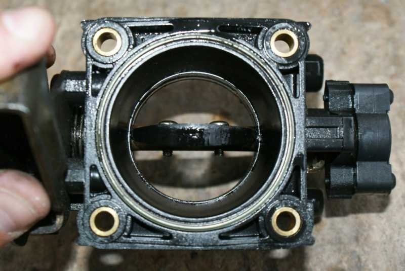

which is a vast improvement in air flow compared to what you started with or the SU plastic bodied throttle

You could have also knife-edged the leading edge of the butterfly, to increase air flow. :yesnod:

Looks like it should make a good bit of difference. Am I the only one who would be worried about the solder falling out though? :ohmy:

gotenks1321 wrote: Looks like it should make a good bit of difference. Am I the only one who would be worried about the solder falling out though? :ohmy:
I thought about that, but the thread in the hole should keep it secure. :yesnod:

Ah yes, of course. I was thinking he'd smoothed the hole for some reason when he's just cleaned it up :silly:

Tbh, I was surprised that there was a wedge on there, I don't think I've ever seen it before.:shrug:

The wedge was originally there to make the throttle response more subdued, making the car more drivable by anyone around the supermarket car parks (not late at night doing doughnuts :lol: ).
Regarding the solder.
I chamfered the holes on both sides and heated the disc until it was hot enough to melt the solder with ease. Thus the shape of the solder is a sort of I (capital I) in profile so it cannot fall out and as long as the area is clean and the disc hot enough you will get a permanent bond.
Regarding feathering the leading edge, yes you can do that but be careful not to damage the sealing edge otherwise when the throttle should be closed you could get air entering. I reckon the improvements gained by removing the wedge are very large compared to the small extra gain from feathering the edge.
