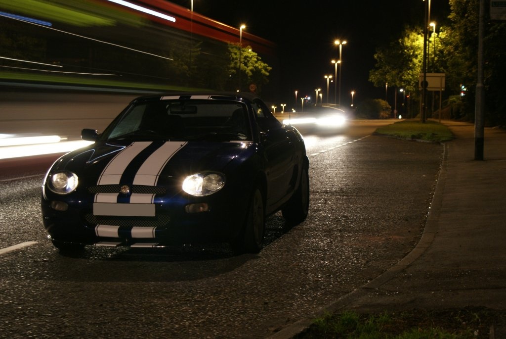

Are you sure?
They are a safety feature, making you more visible at night. See how this speeding bus managed to see me in time and take avoiding action :lol:
Hi Sam, love your car and when I first got my MGF and looked at doing Trophy lights and the K&H splitter on mine I followed your How To for each.
Only joking about the stripes.

:lol: I can see the speeding bus!
Thanks :) I love your car too. I really like the white stripes, but just think they aren't for Blue Belle. There seems to be a stripe pandemic at the moment it seems! :lol:
