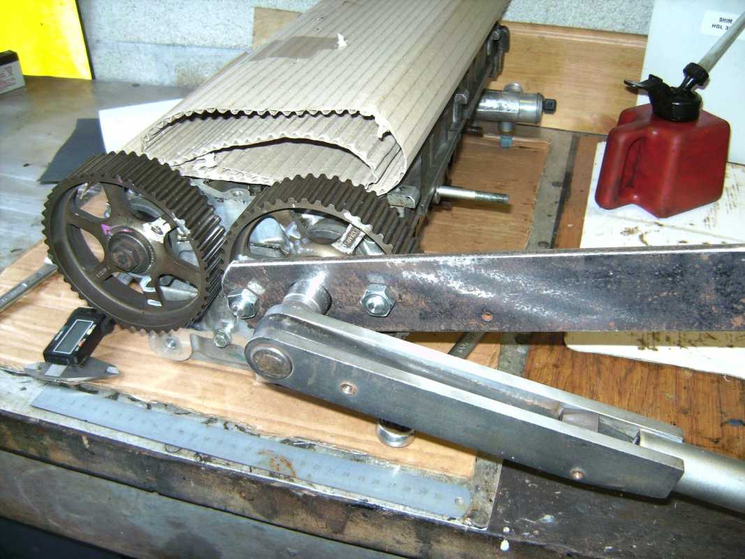

You need 1/4" drive 8mm socket for all the cover screws, 17mm socket for the camshaft sprockets (as these will need to be removed to take off the inner cover) You will need to stop the pulleys from turning while you slacken the 17mm headed bolts, a few of us has made a tool to hold the sprockets so you can slacken the bolts image as below.
