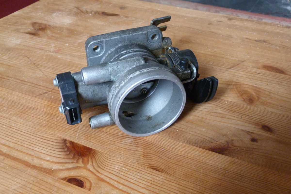

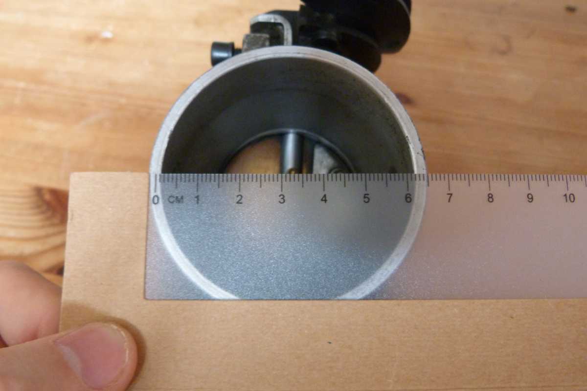

I have one a none marked one 52mm which i measured as more than 52mm.

Orphink you are measuring the wrong part of the throttle body. :nonod:
48mm or 52mm refers to the size of the opening at the butterfly (the round piece on the spindle which opens and closes in the center the throttle body, i.e. the narrowest part).
There should be a code stamped on the body, see the photo below;
For more information on this topic see this T-Bar how to thread.

Yep, dynamics 101:
A throttle assembly is a convergent/divergent Venturi. Pressure reduces thus velocity increases at the narrowest point. Then conditions equalise but minus head loss.
Dimension is expressed as the factor of maximum constriction.
