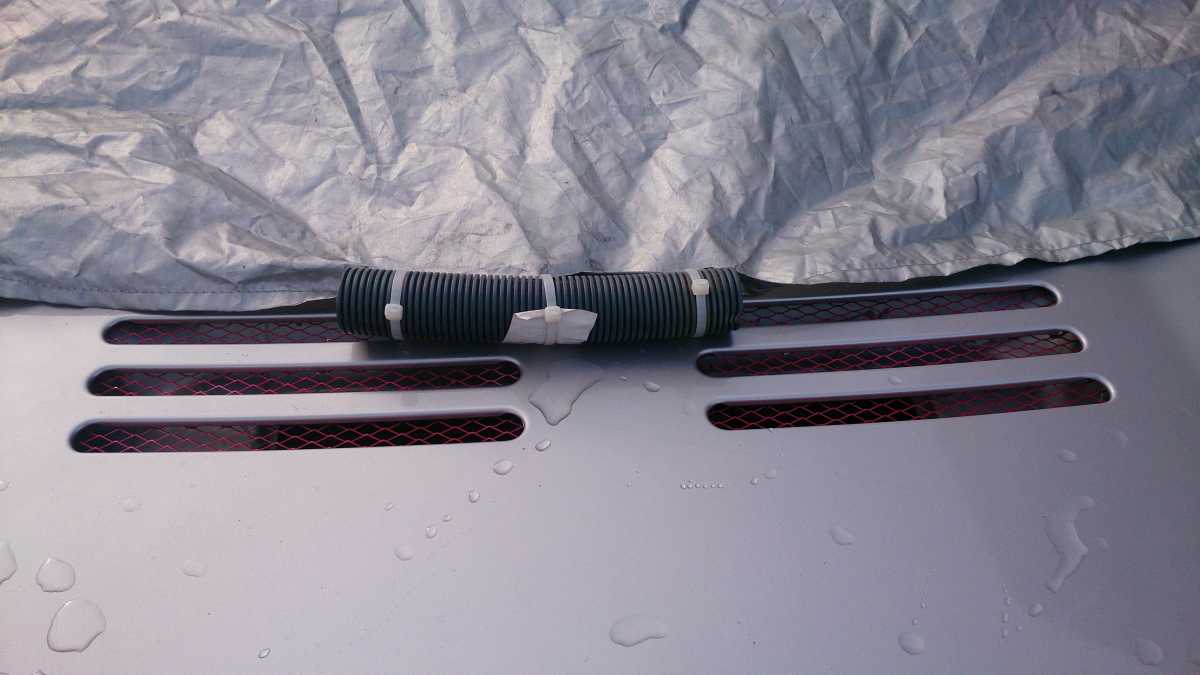

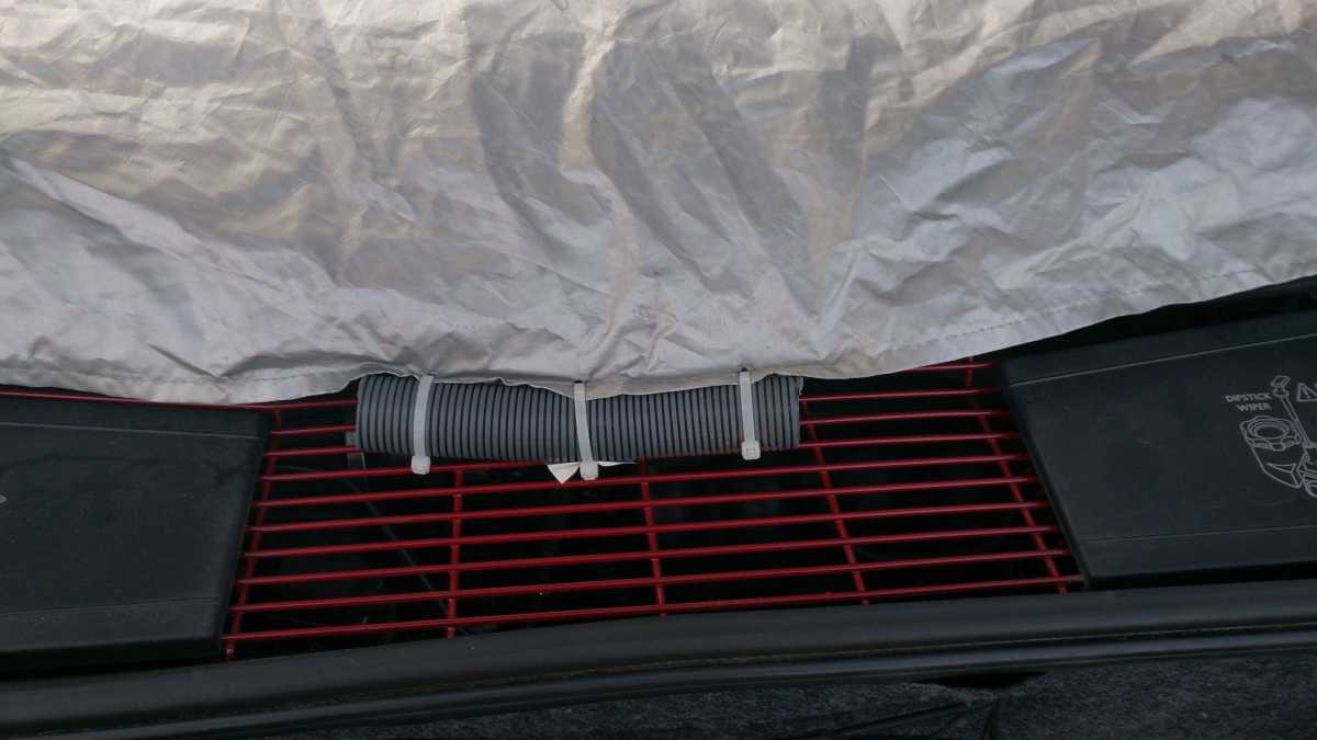

I had the same problem with my hood cover.
The solution.......
I had lying around a piece of 20mm flexi pipe left over from my caravanning days.
I cut a piece about 10in long and used cable ties to attach it to the rear of the cover.
Problem solved.
Chuck it over roof, hook it on mirrors then open boot lid and tuck said pipe into boot area then close boot.
Job done.
I'll post a pick if you want.

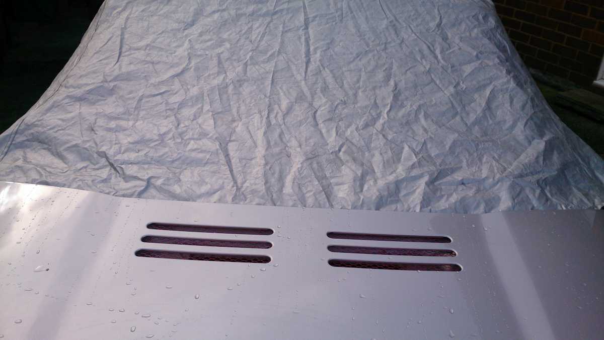

Not the neatest of jobs but it works.

Thanks Andy.
Neat enough with the boot closed and as you say does the job!

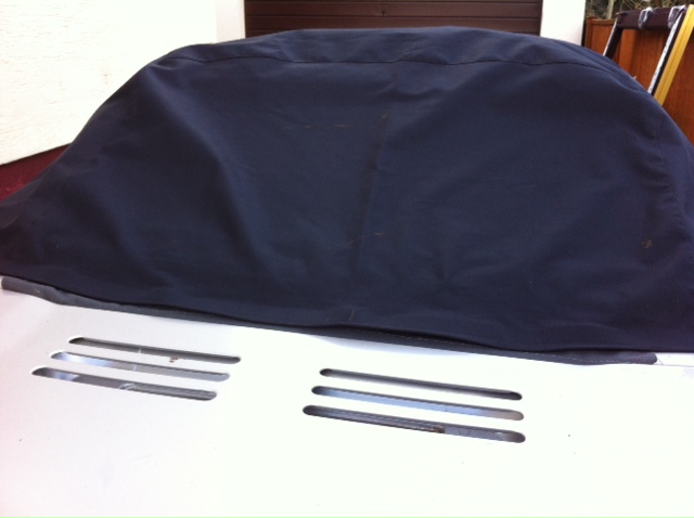

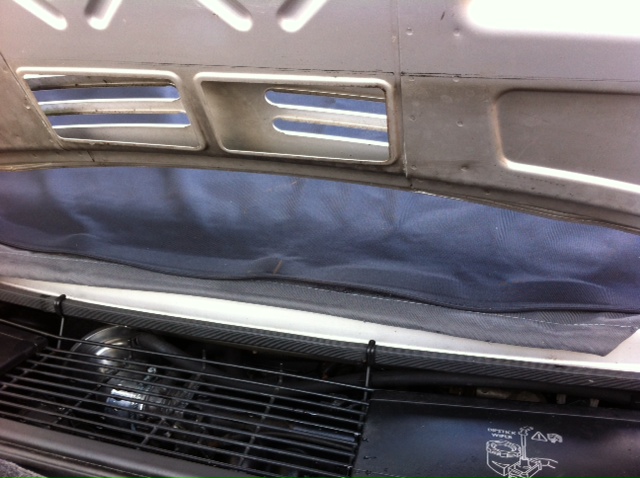

Not very good photographs I'm sorry but here's my solution.
Basically it's the top of a bag that my barbecue cover came in. I opened the seam, cut off about 6 inches and stuck it to the underneath of the cover with impact adhesive. Then passed a piece of washer tubing through what was previously used to hold the drawstring.
Not too elegant but it worked in yesterday's strong winds, so I'm happy.
I still need to do something with the front because the Velcro connections around the mirrors aren't strong enough to hold it in high winds.
