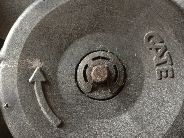

Replied by Davem on topic Engine Bay Fan
Posted 13 years 3 months ago #111856
Thanks for all the help. I did get the fan moving but it is still tight and a bit "gritty" feeling. It was probably seized when I got the Mg 6 months ago and it has been driven on some hot days. The dash warning light does work when the plug is pulled. I will check that its operating correctly with a heat gun once I get the fan working. Thanks Dave

Davem wrote: Thanks for all the help. I did get the fan moving but it is still tight and a bit "gritty" feeling. It was probably seized when I got the Mg 6 months ago and it has been driven on some hot days. The dash warning light does work when the plug is pulled. I will check that its operating correctly with a heat gun once I get the fan working. Thanks Dave
If it "feels gritty" I'd say the bearings in the fan are well and truly rooted!

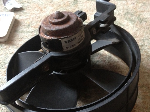

Posted 13 years 3 months ago #111861
Malcom has kindly offered to pull the parts I need out of his fan and send them over. This will save on weight and postage. I just need to pull mine out and apart tomorrow.

Replied by Mal7921 on topic Engine Bay Fan
Posted 13 years 3 months ago #111969
Quite simple to strip down the assembly , 2 bolts hold the outer guard and mounts on while the main fan is held on with a single clip .

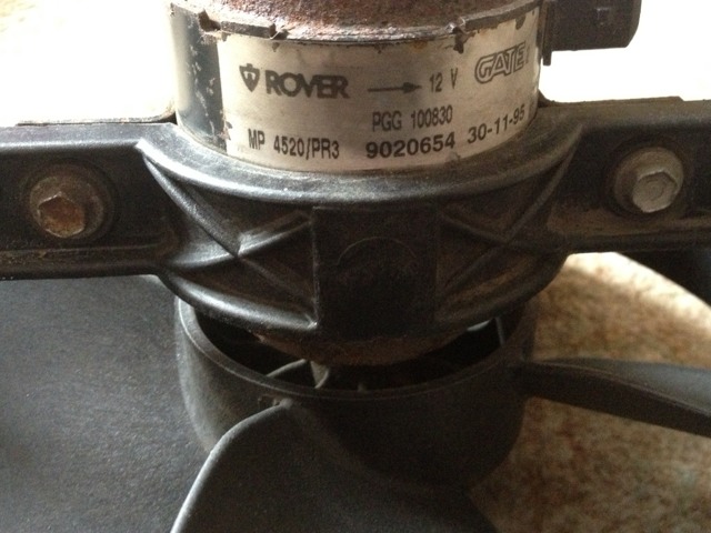

Posted 13 years 3 months ago #112038
Thanks for help Cobber and Mal. Will try to get it out today. :broon: :broon:
