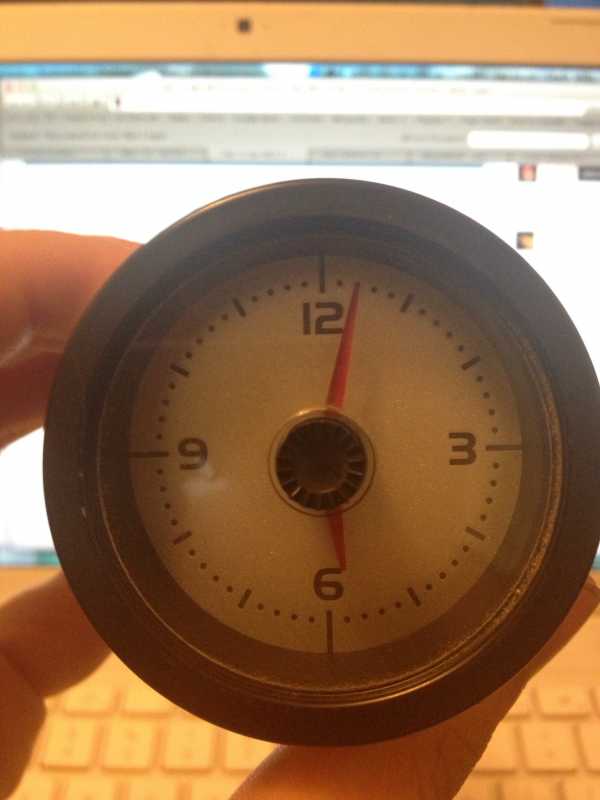

The one that tells the time ;-). For the avoidance of doubt it looks like the one below.

Replied by cjmillsnun on topic MGF Mk2 clock
Posted 13 years 7 months ago #88653
What had happened is that the minute hand was loose on its spindle, so when I tried to set the clock, the minute hand moved but the hour hand didn't...
To fix it I...
Took clock out of console,
Removed black ring and clear plastic cover as per Clive's instructions .
Removed minute hand, reseated with a tiny dab of glue. Allowed it to dry, then refit black ring and cover.
Refit to console.
Job done :yesnod:
