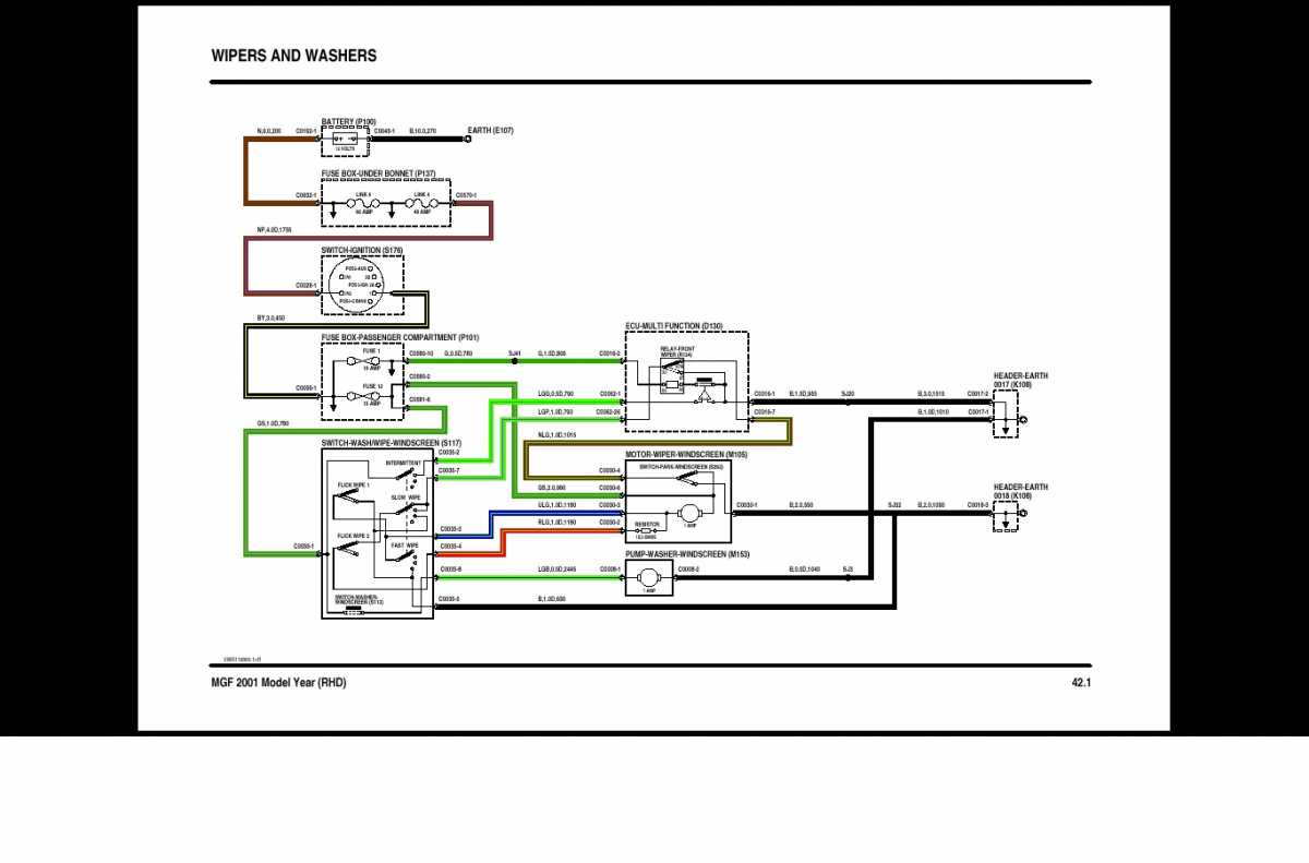

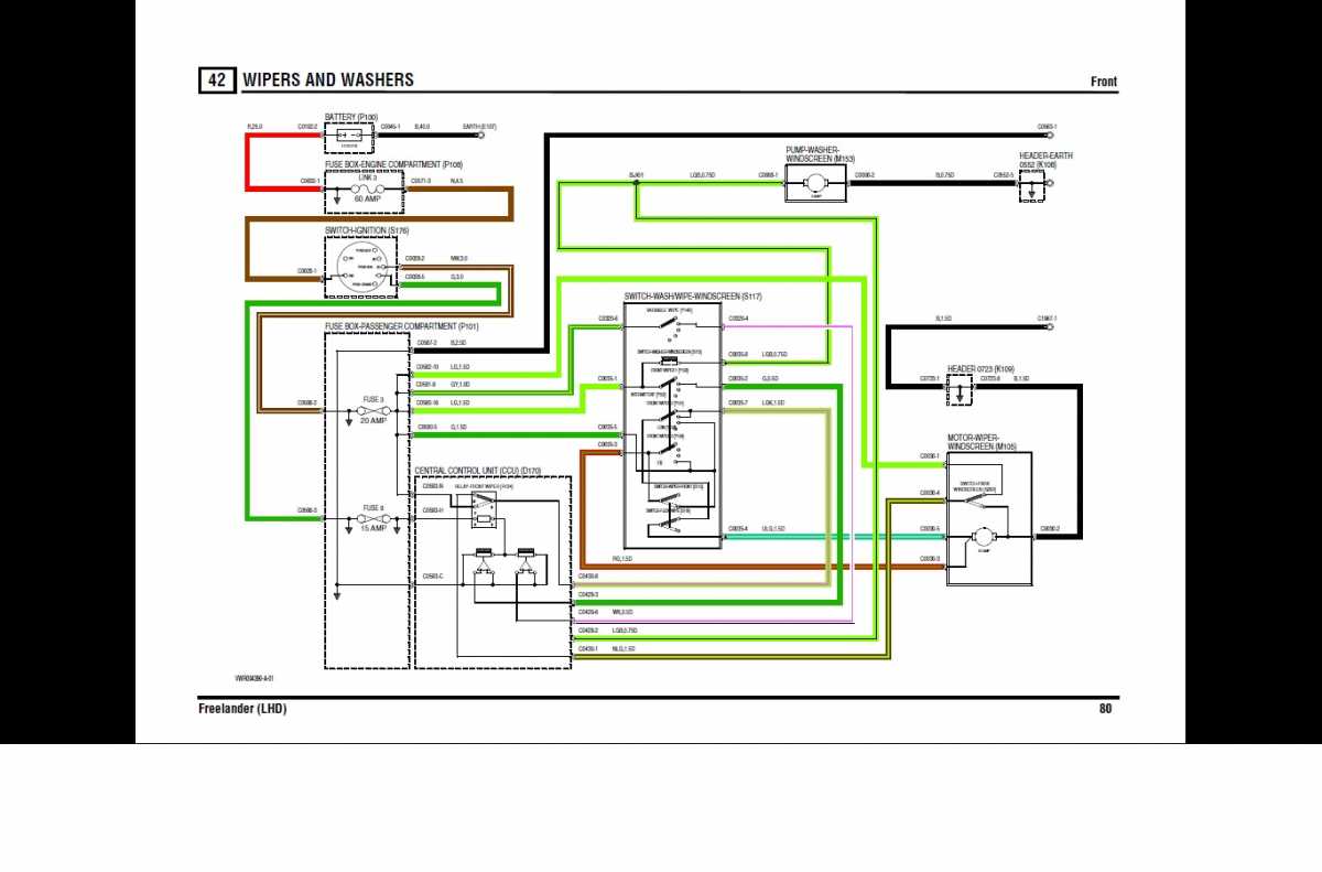

And Dieter is wrong on this one, believe me. It looks like the same motor but is wired the other way around. I put up a thread about it, because I bought a new freelander motor, fitted it and kept blowing fuses.
I bought this second hand one before I figured out how to make the Freelander one work. Basically I had to demount the circuit board and isolate it from the casing.
I'll find the thread.
Replied by David Aiketgate on topic Re: Wiper motor
Posted 13 years 8 months ago #85549
Posted 13 years 8 months ago #85551
This is the important bit I discovered.
Discovered the problem.
Look at the switch diagrams on the MGF
and Freelander
MGF switched earth; Freelander switched live.
