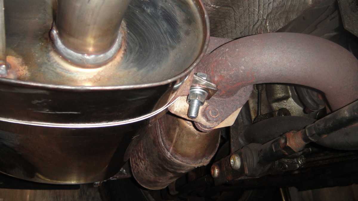

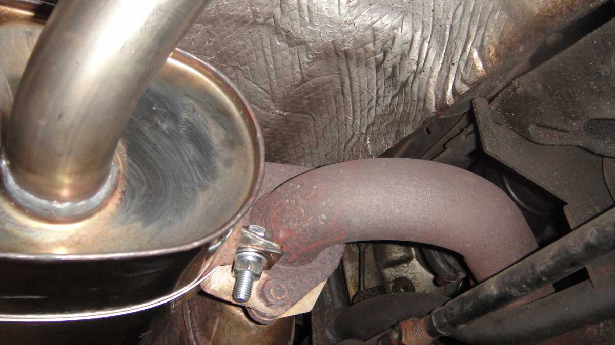

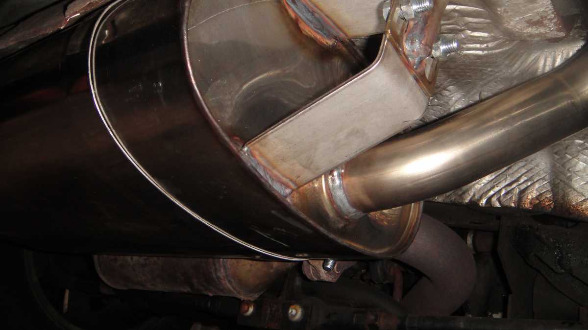

The strap helps to stabilise the cat and reduces stress on the flexi pipe. You can live without it, but for the cost of replacement...
The strap actually fits over a grooved section on the cat bracket. You can see that in the bottom photos, above.
