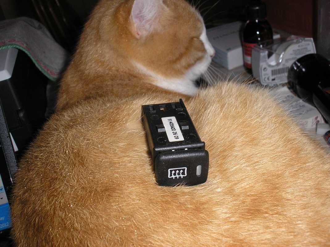

I have a mk1 switch and need a mk 2 postage will be a problem, but swopsies? :broon:

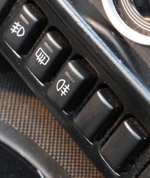

this is what I want
this is what I have
it's more rounded and I believe it sits sideways,

Sorry YP I'm after a MK 2 switch as well
