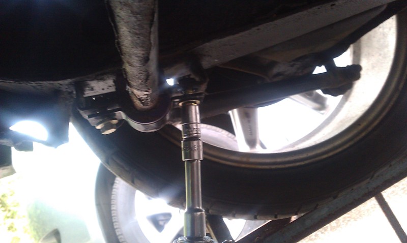

2) You can then get under the front of car and see the anti-roll bar and the bushes/brackets

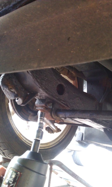

3) Using a 10mm socket, remove the two bolts securing each bush bracket. I used an impact wrench to give the first "crack" as I usually strip bolt when I use a normal socket set. the seemed to come off reasonable easily and I sprayed whit release agent a few times during removal just to help. they are only torqued to 22 Nm so should come off OK, but do get rusty under there

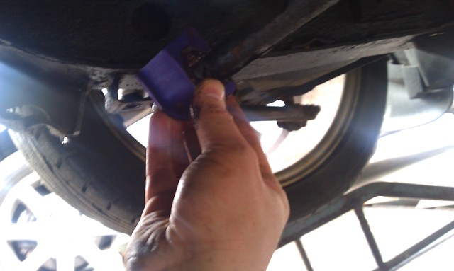

4) Once bolts are out, the bracket can be removed and the bush removed from the roll bar. There is a slit in the bush to allow it to slide off the bar. Or in my case, they just fell off :lol:
5) repeat for bush at other side of car
6) New bushes came with some coppergrease, but if you are fitting rubber, then just use some long lasting grease or coppergrease in the bush to help it go on and to prevent squeaking in future. Slip on new bush and then fit the bracket loosely by applying the bolts a few turns (you can tighten them once both bushes are in place as you need to lower the bar slightly to get the new bushes on)
