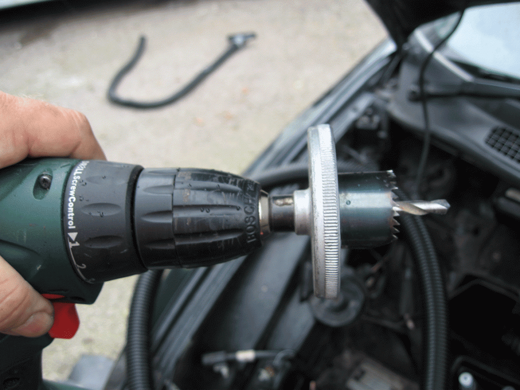

When we were driving the F abroad, it quickly became clear that without using the fan there is not a lot of flow through the vents. Even at speed, the natural flow is small.

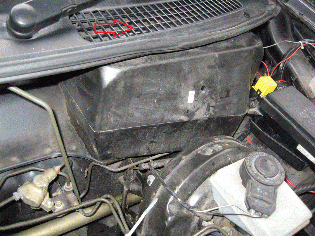

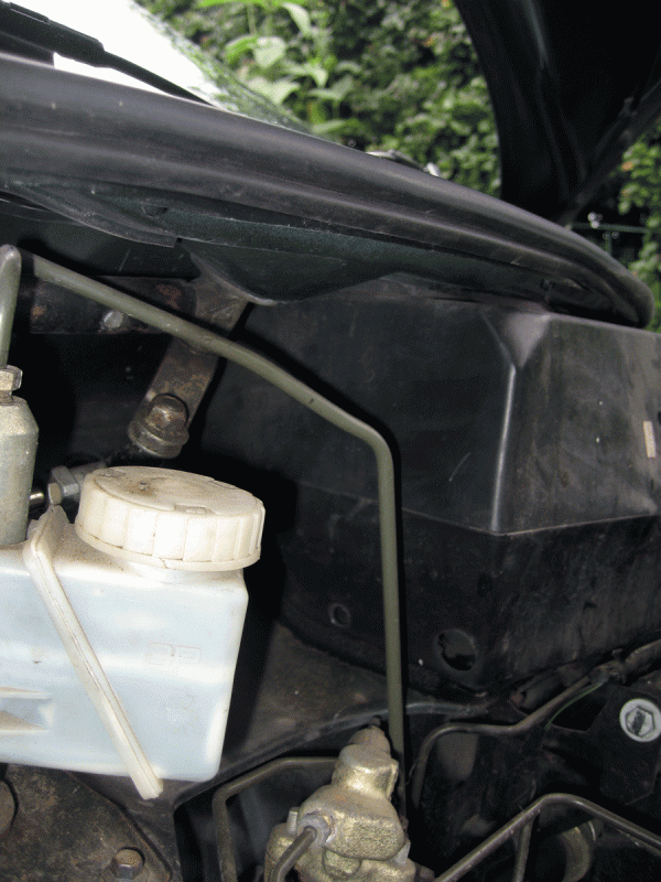

Looking at the external air box it's easy to see why.
The only access for air is hidden away in here, with a metal cap over it (to stop rain entering the heater.)
An easy way, I thought, to increase airflow would be to open another access hole and direct air from the front of the car into it via a flexible pipe.

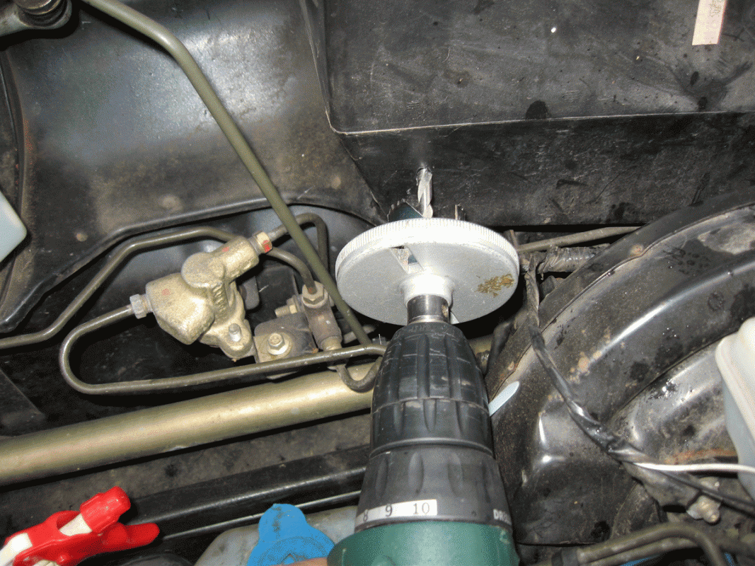

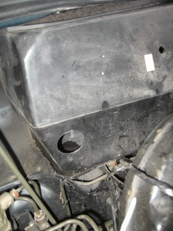

The box is made of thin plastic and using one of these,
it is easy to open a hole.

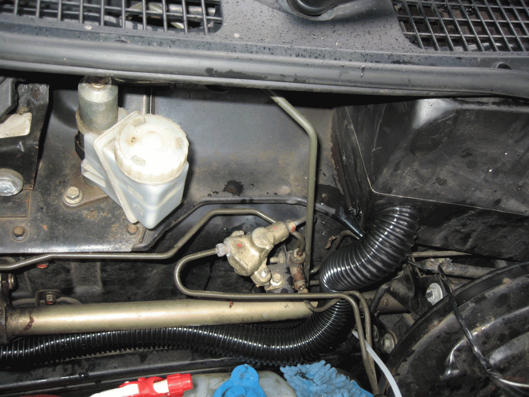

Using some hose I happened to have laying around :lol: I fed the hose end into the hole and led the rest to pick up some nice fresh air.
Replacing the black cover covers this all up and nothing can be seen.

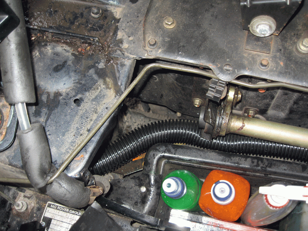

A quick test drive confirmed that the air flow was increased. initially I have just fed the hose into the wheel arch area, but I may reroute it to get a more direct flow.

Replied by David Aiketgate on topic Re: Air throughflow vents - How to improve
Posted 13 years 10 months ago #65888
Update
This has been a great success, improving the flow of air into the cabin. Overcoming that stuffy feeling if you're forced to have the roof up in inclement weather conditions.
I have now re-routed the hose so that the opening is facing forward to receive maximum air flow. It is actually positioned where the anti-roll bar meets the subframe.
This has increased the flow substantially through the vents/heater system. :broon:
If necessary (if it's cold and the heater hasn't warmed up yet, for example) all the flow can be diverted to the demister vents.
Unfortunately, I need to go back to Italy to really test the new set up.:yesnod: Financial donations would be welcomed.:rofl:
