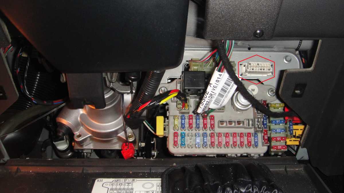

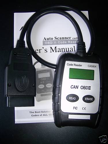

For anyone with a My2000 on a car that is OBD2 compliant then this reader is a very cheap tool. :yesnod:
Ebay OBD2 Readers link.
They come with a booklet with a comprehensive list of codes.
It plugs into this port here within the fusebox compartment under the steering wheel.
