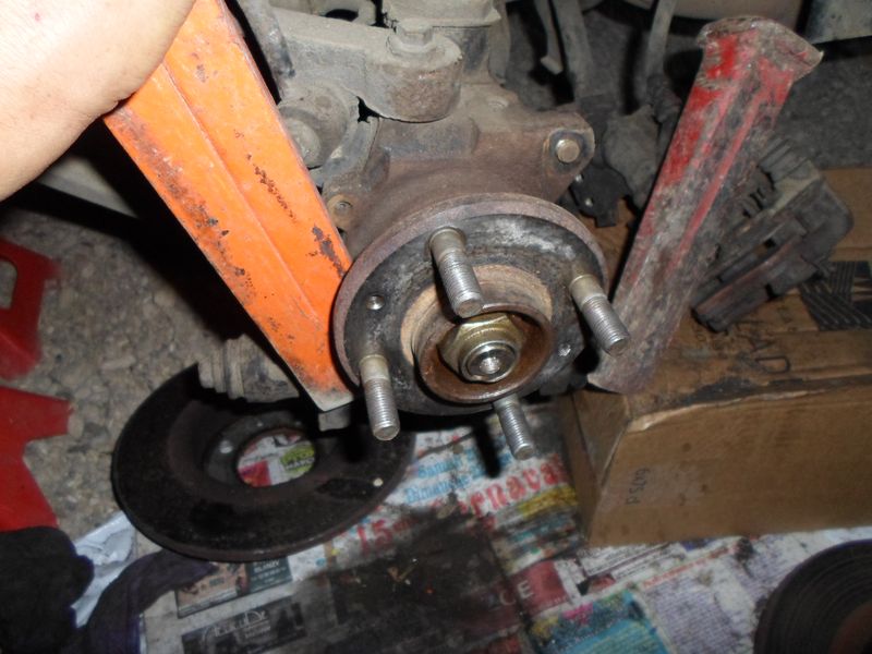

A great guide.
It's always worth clattering around the rim of the disc with a big hammer, turning as you beat the crap out of it. The slight deformation resultant from the sound thrashing breaks the rust bond and 'walks' the disk off the hub. This method only suitable if fitting new discs obviously.
Some recommend just cutting in with an angle dangler.

I made one of these kits from bolts in stock to remove my rear discs, screws came out without shearing!!!!! and a light tap with 4lb lump hammer and they fell off. Ben, you can buy S/S bolts nuts and washers from Westfield Fastners for a few pounds.
