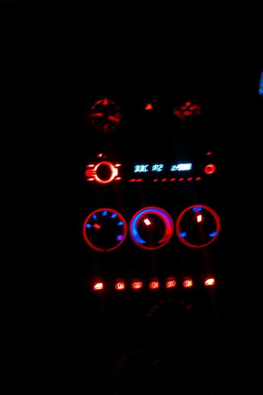

Replied by Leigh Ping on topic Re: Plasma Dials - How to fit.
Posted 13 years 8 months ago #79816
Andy the tyre man wrote: I have the heater control set to fit but wonder what I can do with oil temp and clock dials cos they look odd now.
Any ideas?
Here's another good idea that you could consider Andy.
