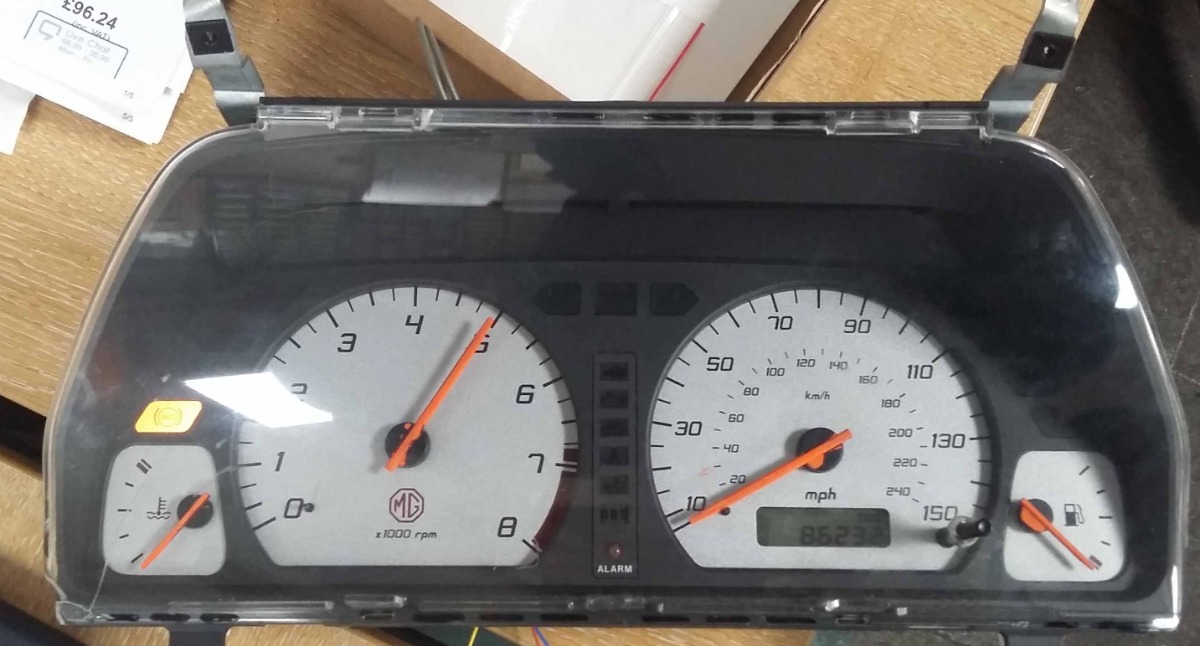

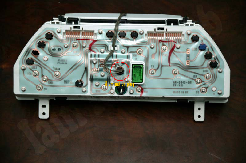

With the connectors freed you can now ease the instrument pod out. This is the rear face of the pod.
Disconnect the dial illumination plug.

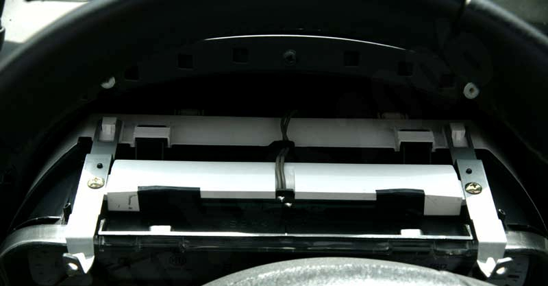

The clear and black  perspex front cover is held on with 4 black lugs. It is very fragile!
But first you need to remove the 2 metal brackets holding the light box. They are marked left and right.
Now, by pressing the lugs in you can ease the front off.
Now you can begin fitting the dials. Ease them over the needles, and locate them on the lugs.

Then you need to ease the front back on whilst keeping the dials in position. it might be easier to use something like Pritt stick to keep the plasma dials steady whilst pressing the front into place.
Now replace the metal brackets. I took the opportunity to remove the yellow filter from the light box. As I intend to fit red leds into the box to illuminate the needles.

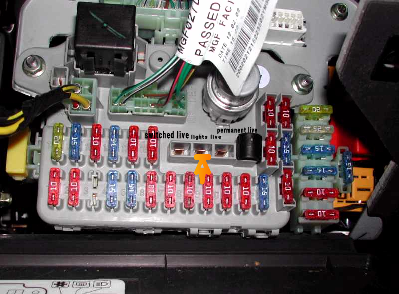

Now you will need to pick up a live from the sidelight/instruments circuit and an earth.
Interestingly,
 On the fusebox, the middle spare connection between the two I used for the heated seats is a suitable live.
The three connections are, left to right 1/.ignition live 2/. Lights live 3/. Permanent Live.
