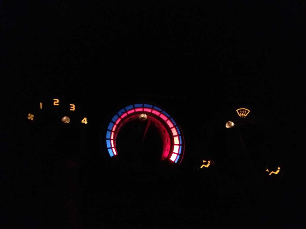

Now when the instrument illumination is on, sufficient light will escape into the back of the knobs to show through the leds, and so the new led pointers are gently illuminated at night!
Tadahh!

Fantastic guide David - looking forward to seeing pics of them in the dark. 10/10 for ingenuity!
by kara
Yves Adele Harlow;2204 wrote: Fantastic guide David - looking forward to seeing pics of them in the dark. 10/10 for ingenuity!
Piccies coming!

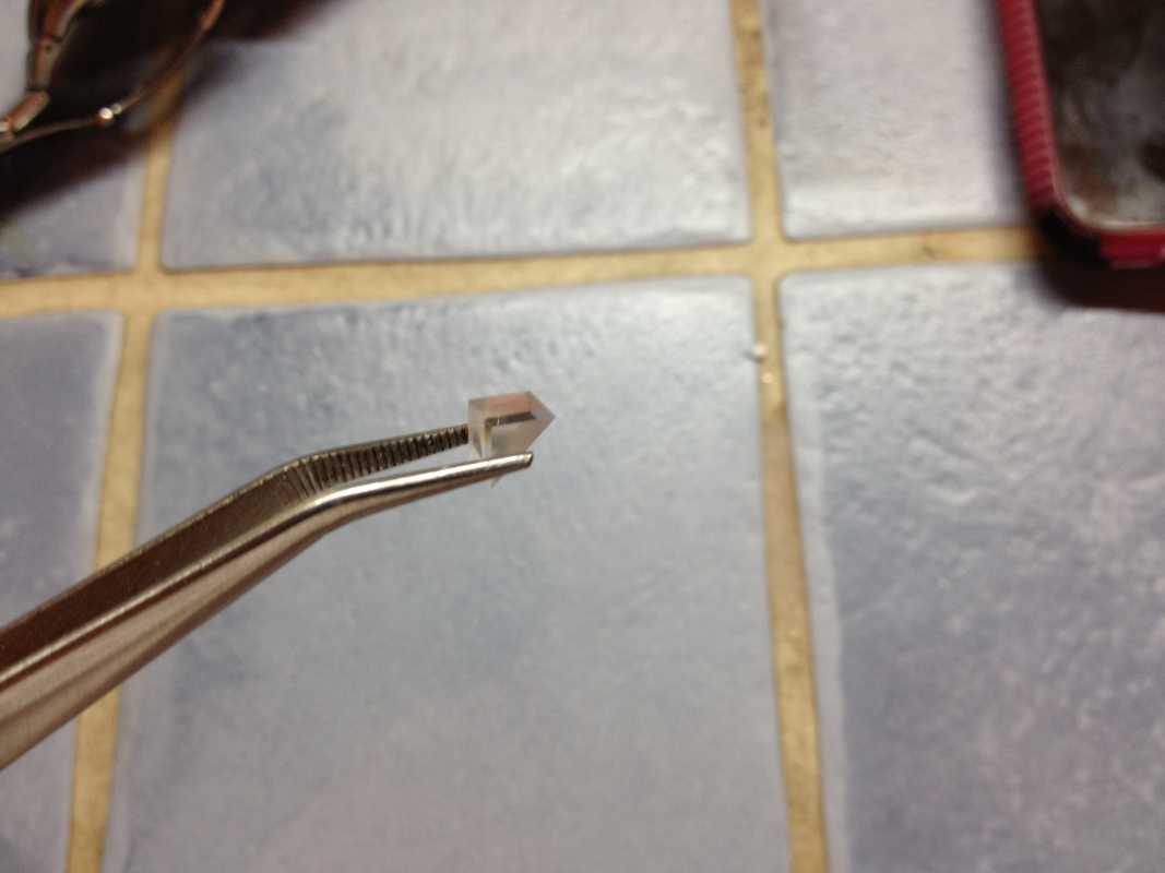

I used this fantastic guide, very easy and took about 15 minutes. Most likely due to the angle of the rear of the leds not much light was 'escaping though. Luckily having access to some small right prisms, so i glued one to each of the rear of the leds using UV glue.
Changes the angle of the light entry and now channels the light really well
Now I'm going to glue coloured filters on the back of the prisms, just can't decide what colour...
