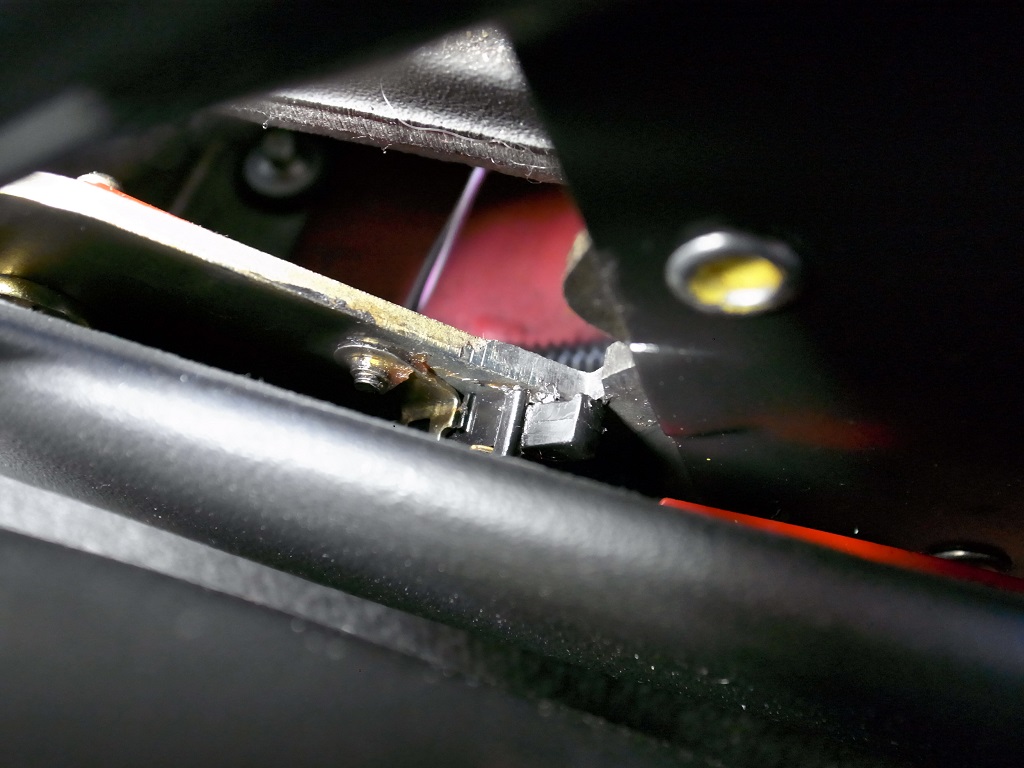

Posted 9 years 10 months ago #171206
So I took a look at my switch by loosening the handbrake gaiter which clips in fore & aft.
The above was taken from the left hand seat and the switch plunger was quite greasy and this was making it resist sliding in so that it was pushing up sufficiently on the handbrake lever that it wasn't staying in the completely down position. The plunger has to move about 3mm down before it extinguishes the handbrake warning light. With the lever released but not going completely down it only had to move a mm up for the light to come on. This indicated to me that there was plenty of life left in the spring.
Before trying David's trick which I could see would work, I cleaned the plunger with a blast of WD40 and some tissues then worked the mechanism for a few minutes. All of a sudden the handbrake lever was going completely down. While the light still comes on the moment you move the lever, the lever seemed more inclined to stay down and a road test over the same roads that gave me a problem earlier in the week didn't cause any unwanted lights so fingers crossed that it's sorted (and the WD won't dry sticky - I did remove most of it). Otherwise I'll use David's fix - I don't think now that a new switch would help.
Richard
by Blow-in
