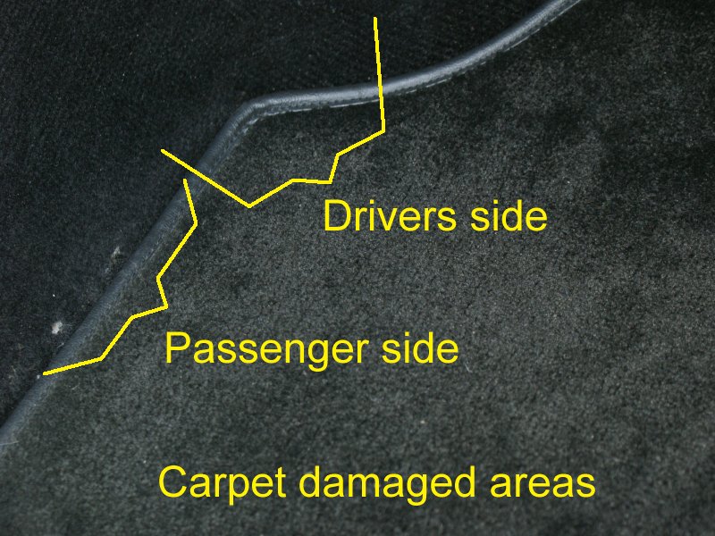

I first lifted the carpets from the foot wells with the seats still in position, to do this you only need to release a couple of clips and on the drivers side undo the three 8mm bolts holding the foot rest in place. The carpets had worn quite thin in places, see photo below and there were a couple of small areas of damage.

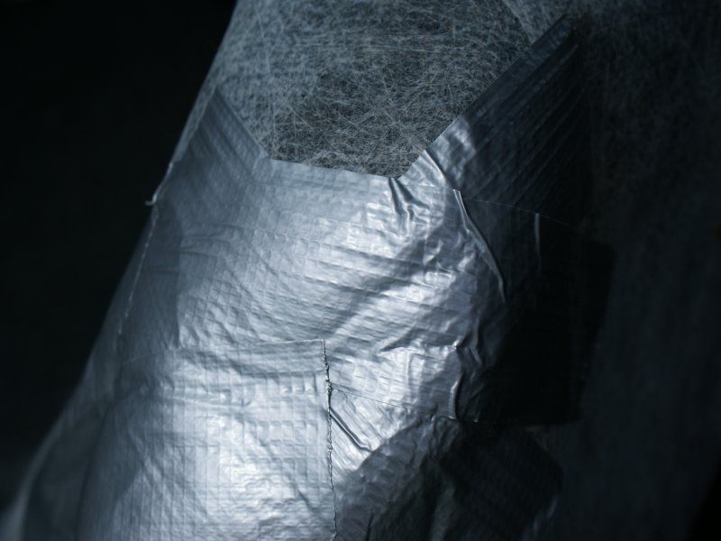

I reinforced the backing of the carpet with strong tape, pulling the carpet back to shape whilst doing so. This made the carpet look good again, here's a photo of the back. I suggest you check and if needs be do this with your carpet before it suffers damage. Once you have it lifted you can see the thin areas as more light will show through.

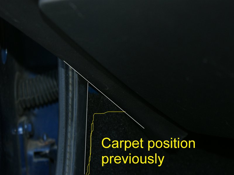

Using the original underlay as a template I cut out carpet for each side and then fitted in place over the existing underlay. I then applied double sided tape around the edges of the door frame and then relaid the carpet.
I now have good looking carpets which fit and have a little extra soundproofing :woohoo:

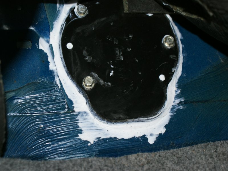

Whilst doing this I found that in the passenger footwell under the glove box the underside of the underlay was damp around the blanking plate for the LHD steering column.The blanking plate has a foam gasket which must be leaking. I removed it and applied bathroom sealant around the gasket. Hopefully this will cure the leak.
